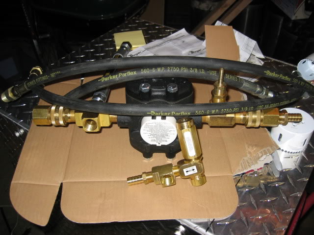

amp draw only 9.6 per leg with all components running get equal power
nothing but the best hose and connects all custom
pump will do 500 psi at 2.2 gallons a minute
no pump teck porti pump
Bjorn
2,450
cfms 230+ lift 11 hg
with booster 330+ cfms
total amp draw is only 9.6 per leg
500 psi @ 2.2 gallons per minute

Is the vac amp draw the same for both motors and your sharing the pump amp to both legs, or is one vac smaller and the pump is run on that leg? Are they 2 or 3 stage motors? What is the approximate weight of the unit?

I have never seen an 11” hg of vac rating for an electric unit. It looks like a better value than a few of the TM’s I have owned. What kind of circuit tester do you use on jobs to make sure there is 9.6 Amps available? I just had a WDR job take an extra day because of tripped circuit breakers.

Terry with only a 9amp draw can you combine both plugs to an adapter and run a single cord to the house?
Mar 29, 2008
9,591
Hawaii
Nate W.
You'd need separate curcuits for it to work, if I'm not mistaken.
CleanEvo
Oct 8, 2007
748
Those units have come a long way. Nice job Terry.
90% of the jobs I do are 100 - 150 feet. How long can you run the cords? If you plugged one in on an outside plug, the other would go inside I assume?
How much propane do you go through with the heater?
Bjorn
2,450
propane use depends on how hot you like it I use a little giant #3 and on a busy week I might use up around 20 dollars worth
not too often I have to run more than 75 feet each of cord use #10 gauge cords roll up just like high pressure line on a reel
