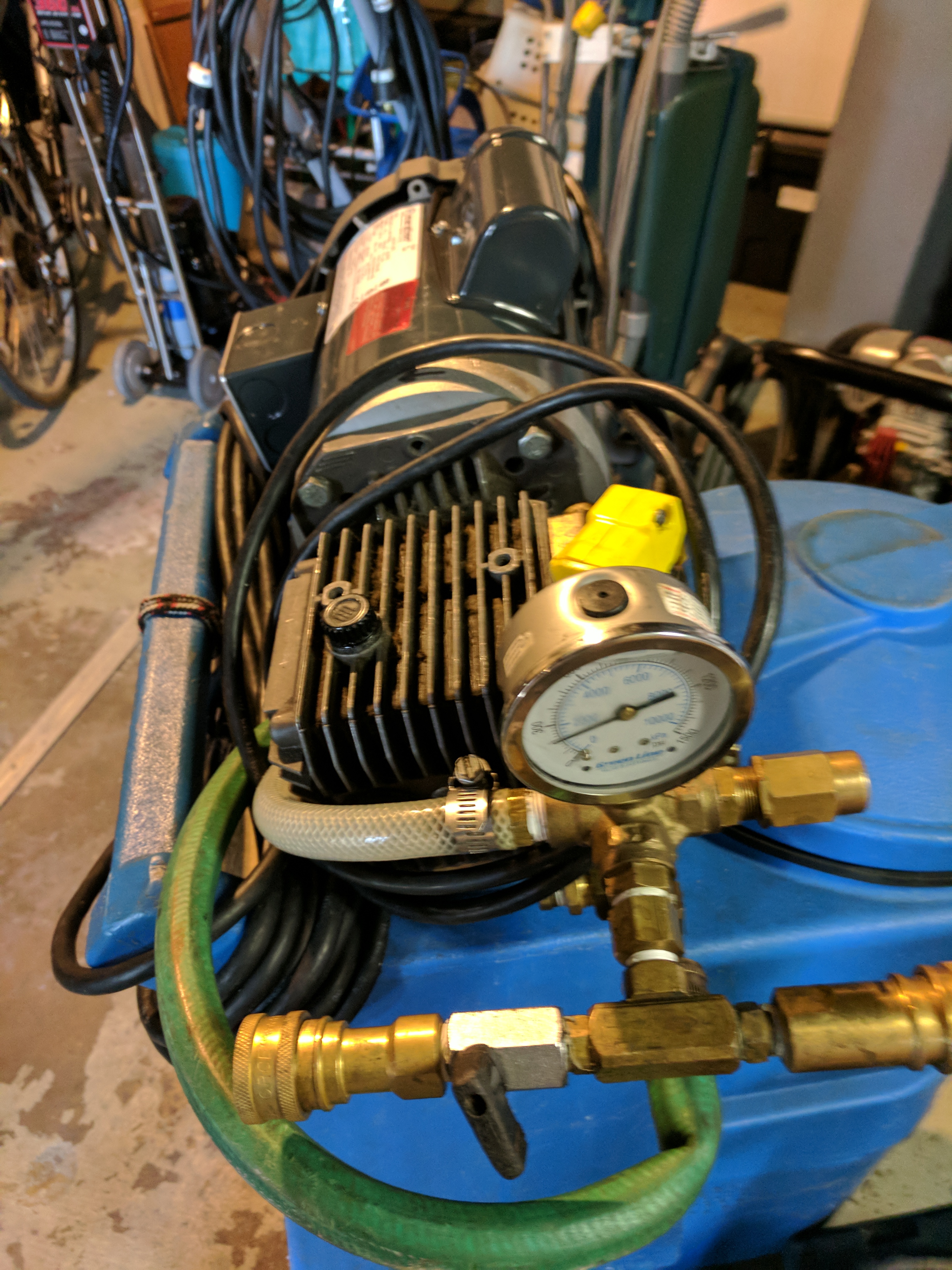

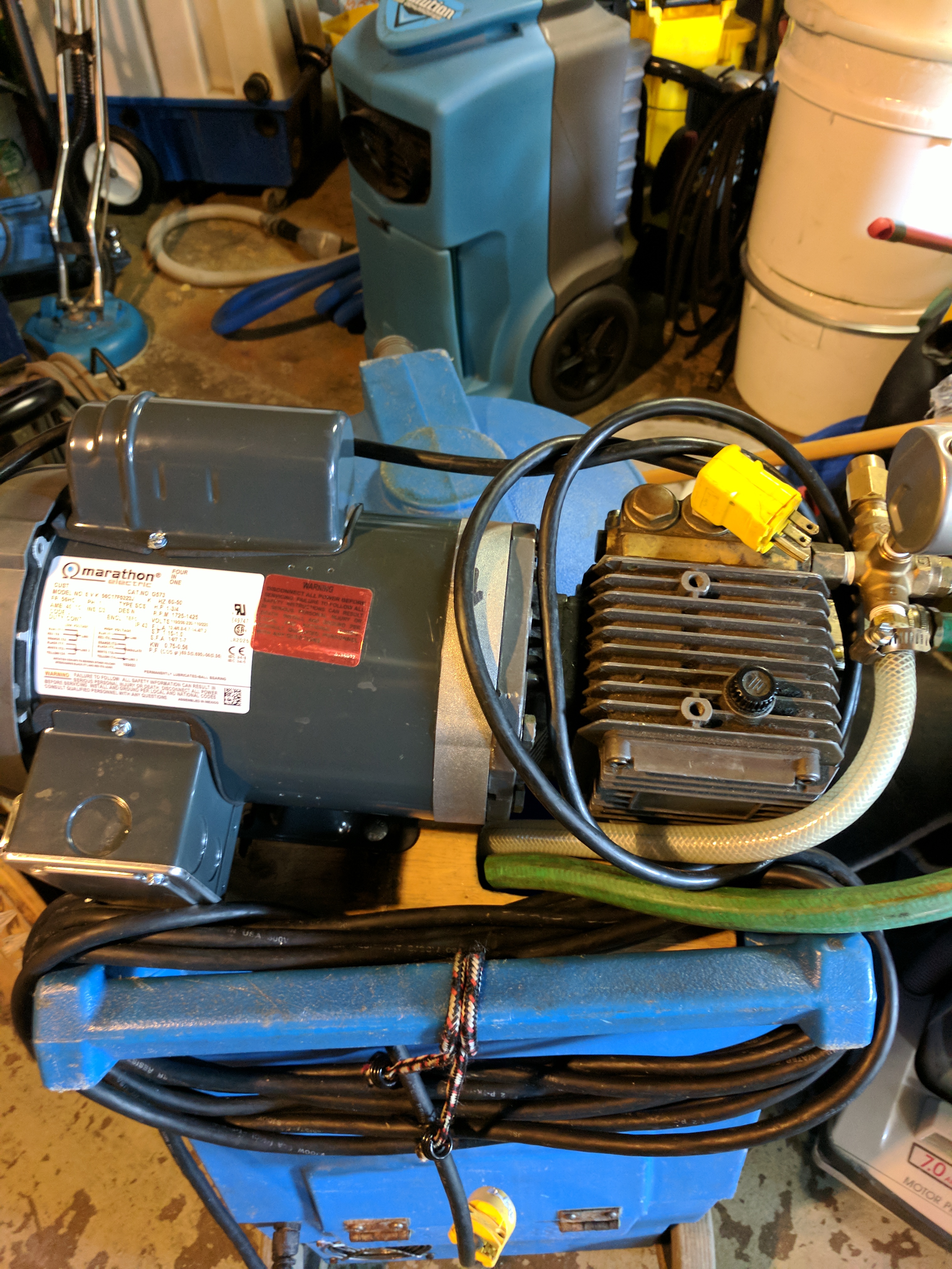

I've never used a water otter. I made my own pump using a 1hp motor and a general pump. Not hard to do. It sits on top of my old ninja and I drop my suction and bypass hoses into the solution tank. Gives me up to 1500 psi. I normally use 1000-1200.
