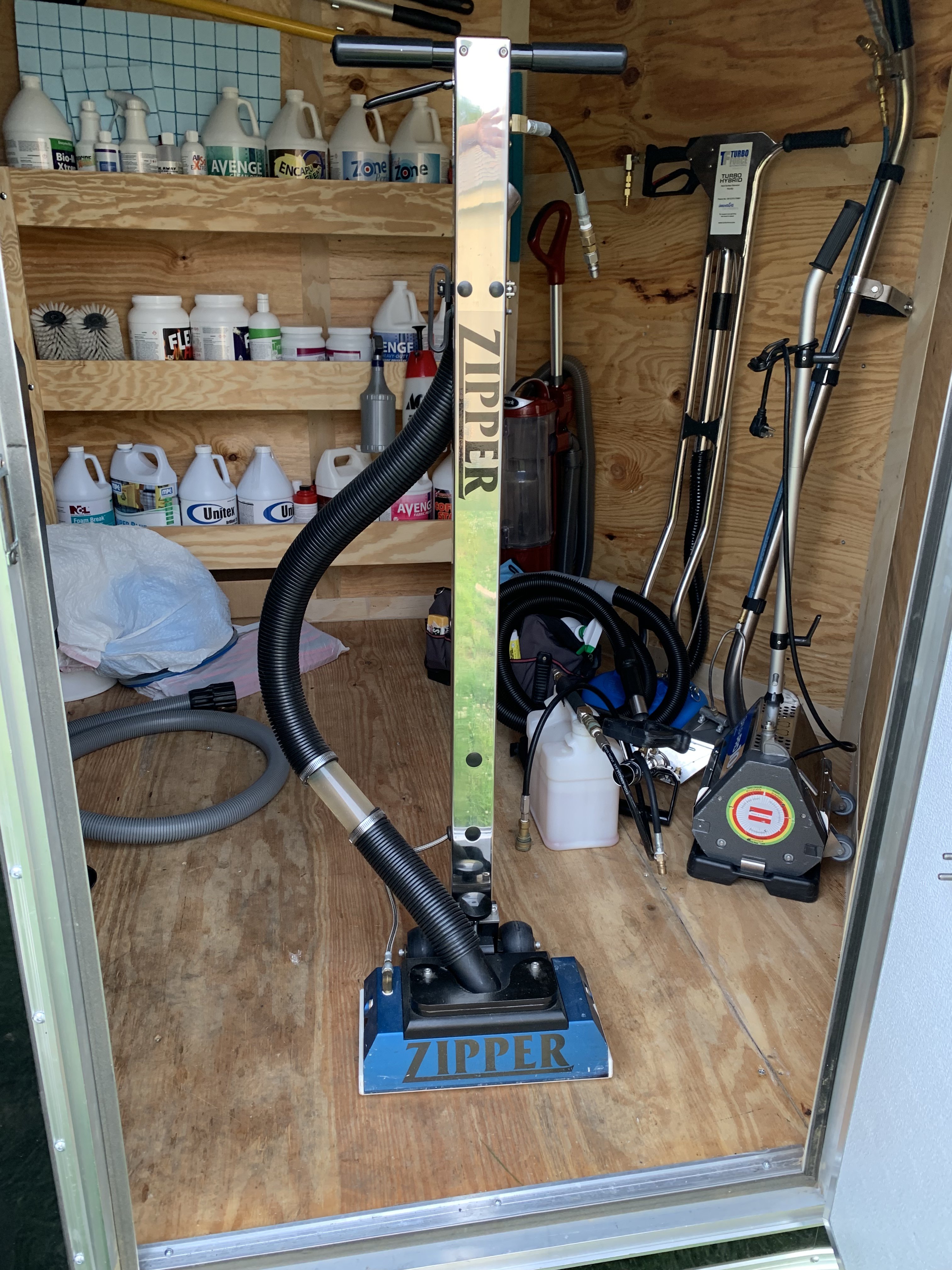

The bonzer is just a piece of crap. Now a Zipper is a finely crafted tool that works wonders in wide open areas. With 2 people, it makes short work of even the most heavily soiled hallways in condo buildings as it flushes and vacs in both directions. Pair it up with an auto pump out and you will blast through commercial carpet like no tomorrow. But a bonzer, well a bonzer is just wrong.

Maybe but usually cheaper is cheaply made. Such is the case here.
If it were half the price maybe then I could see it. However when its 3/4 of the cost of a hugely better design and build then you're not saving, you're over paying for inferior quality.
Although it's your money. Buy it and tell us what we already know.
Reactions: Russ T.
14,217
Cost is not a factor in comparing these two tools. Mainly for the fact that the Zipper will last much longer without the risk of breaking. And it's not a big price difference when you compare the production rate that these tools will bring in.

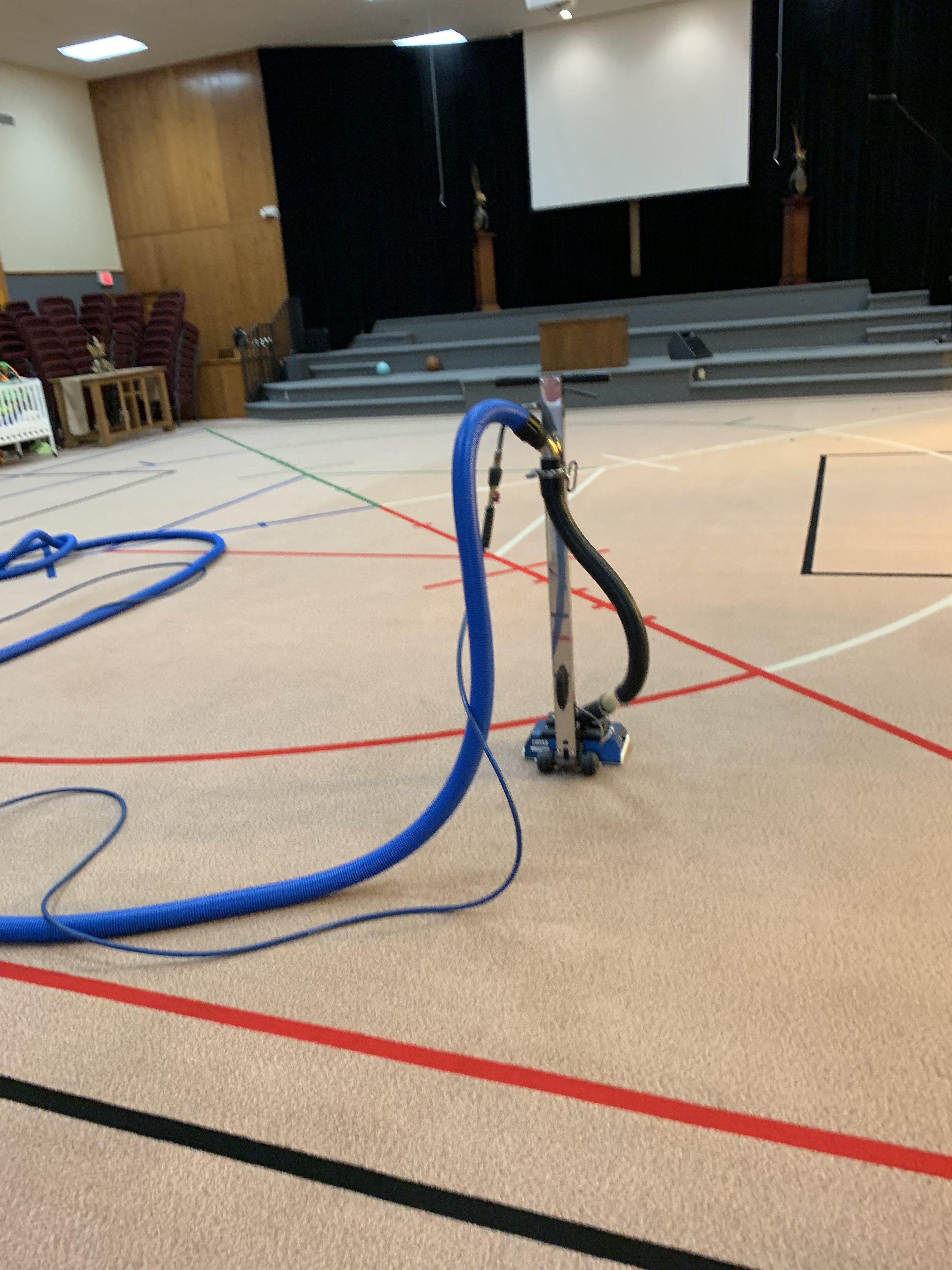

I do have a church I use it on sometimes.
14,217
I hope you take my advice and keep it. Just remember to walk away from the hose on those big rooms. If you don't use it every week, don't worry, you'll use it more in the future if you're chasing bigger jobs.
And I learned something new with my zipper last week. On that big room posted at that church, did you try going in different directions? (forward backwards and left to right?) The only reason I'm asking is I did that on my last job and it extracted water differently. When I pushed it left to right, I could barely see any water on the dry passes, but when I went forward and backwards, it showed twice as much water being extracted on the dry passes. @Mark Saiger , what's your thoughts? Did it perform better on the wet passes or perform better on the dry passes going in the different directions due to the nap of the commercial carpet? Has anyone else noticed that?
I do notice certain carpets react differently during cleaning when pulling some different directions.
There are only a very few I don't find getting much out during dry passes.
Also try making a 20 foot vac hose and water line combo strapped together. It is much easier.
We have been using a hide a hose to experiment.
Like it a lot but I am going to try one dedicated of 20 foot vacuum with 22 feet of high pressue line strapped together.
