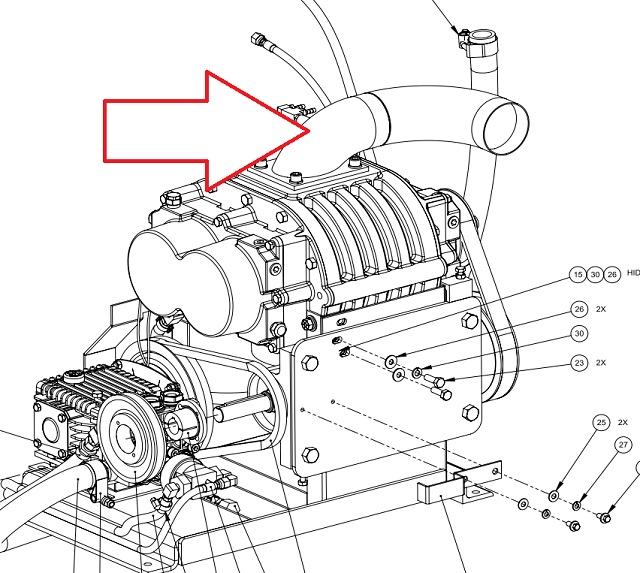

no point in the rotation is there a dragging noise or clunk?
I'd pop the inlet off and have a look

I wouldn't open the blower just pop the inlet piping and look in....and give it a spin to see if it spins freely
but based on your last post it almost sounds like there is a vacuum that can't be broken that increases with rpm bogging it down........like something stuck in the inlet system or collapsing (could be on exhaust side too)
but of course if you are uncomfortable or worried about the warranty wait till you can get it to a pro
