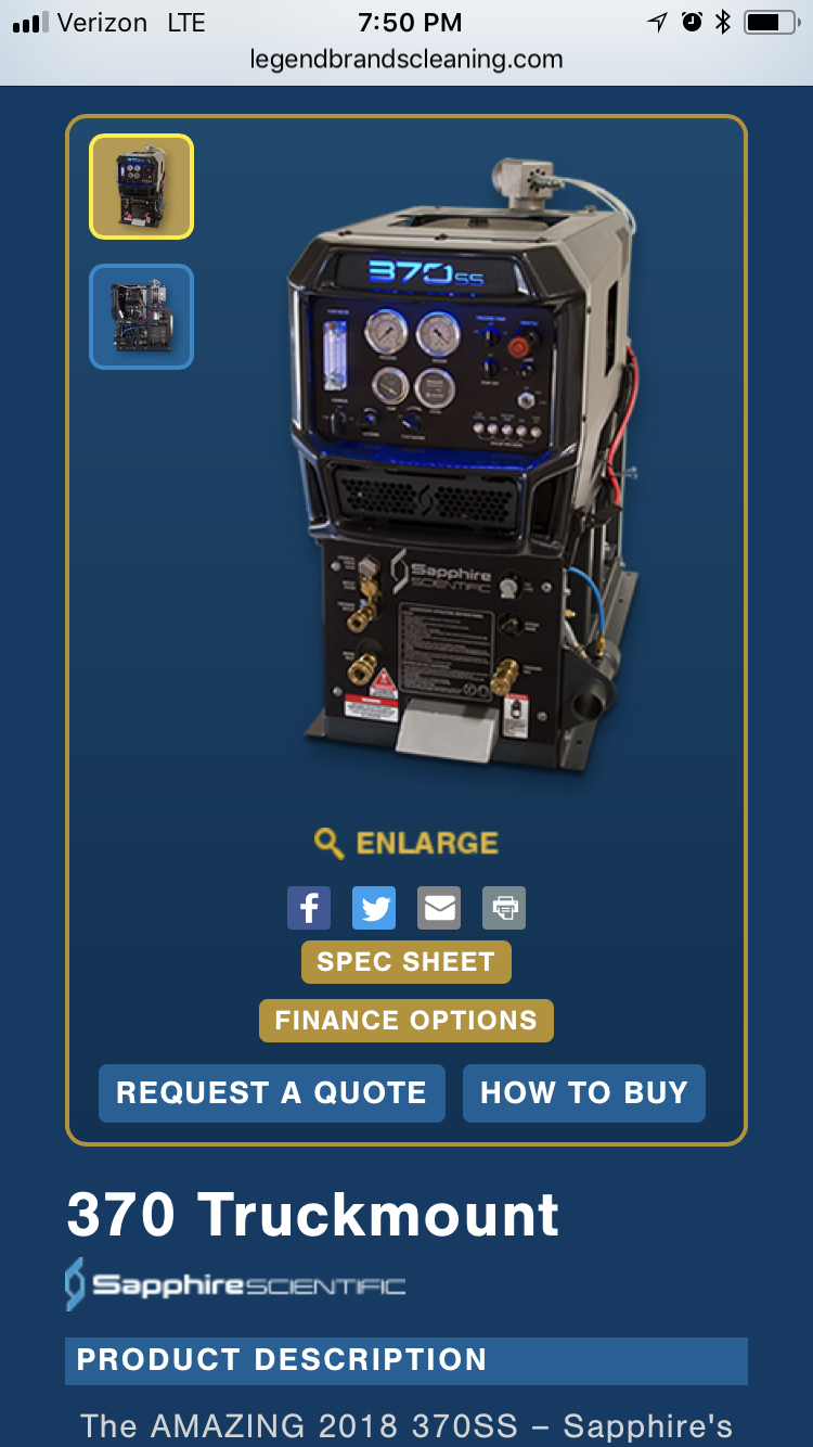

The pic above isnt telling me too much about diverting. My SS370 has a maual diverter to bypass the heating chamber - but I want it to bypass on its own as it reads selected temps rather than dump the water to bring the temp back down.
