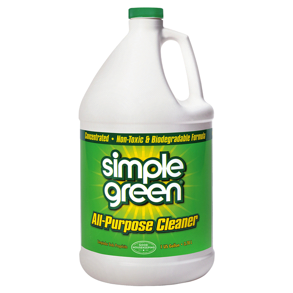

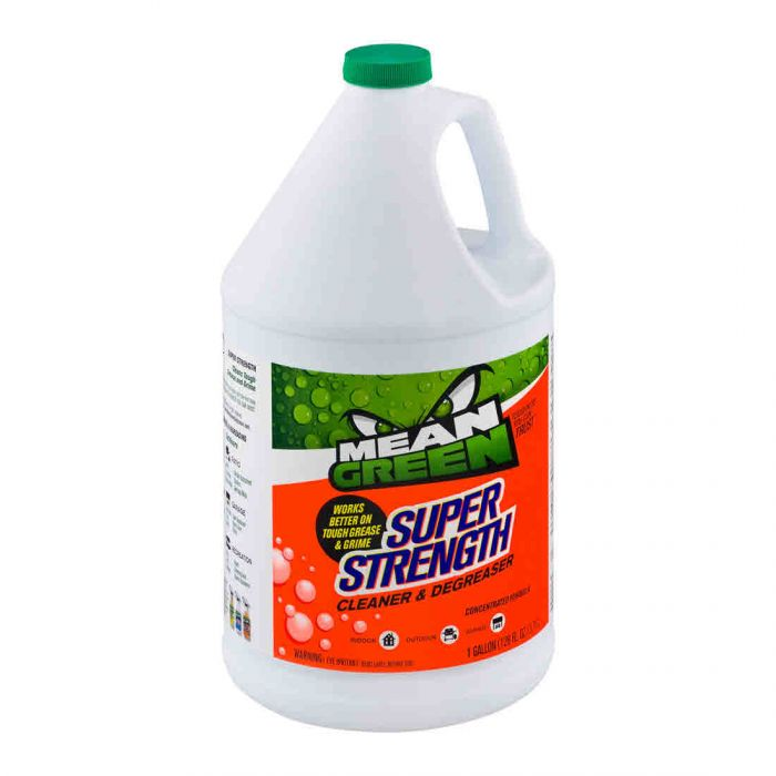

ask her to define what she means by "green"?
That's the way to determine if they're knowledgeable or simply a pack following clueless mOOk riding a marketing trend
then show her a couple options you have
87086
87087
