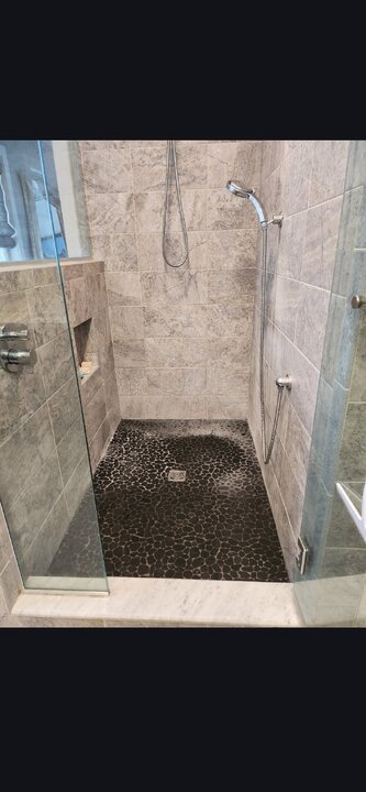

Is it a stupid choice
Bryce C
DFW
Feb 9, 2024
1,344
Bryce
to put slate tiles in a shower? What do you guys think? Acid, dwell and scrub, dry it fast, and use a super sealer? Or just tell her the efflorescence is likely a permanent/recurring problem?

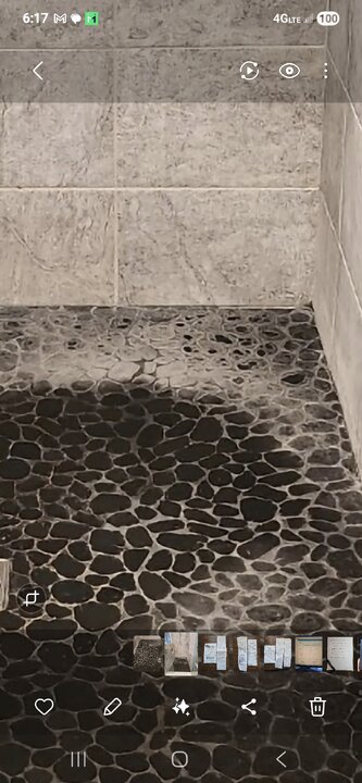

Bryce, that's not Slate

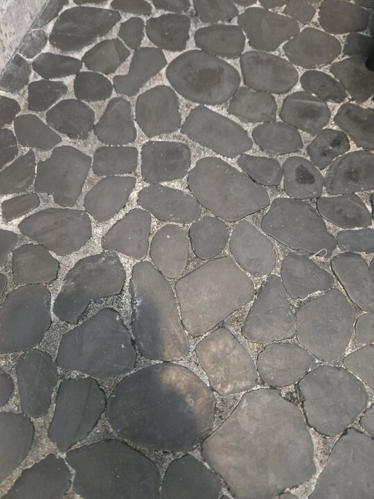

Limestone or marble on the walls, hard to say for sure from that small photo but the pebble mosaic floor can take what ever you need to scrub the mineral build up off them.
Floor looks ultra matt so acids splashing ( probably ) wont hurt
Can you get better and bigger photos?

Oh snap, shows what I know. All I can do is zoom in and crop for now. I'll get more pics later today. Thanks for the tips so far.

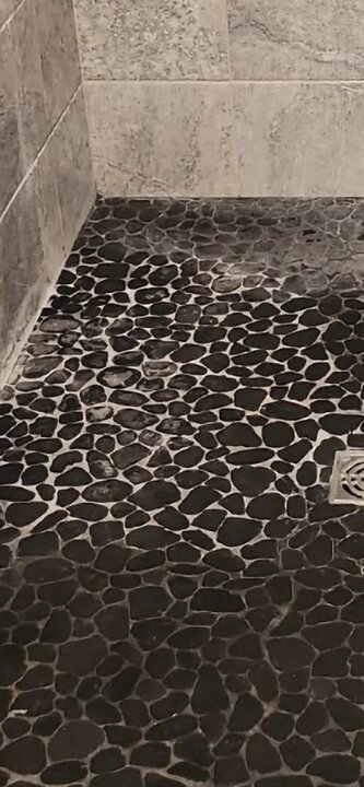

How quickly will acids dwelling and being scrubbed begin to remove grout when I am doing this? Does that depend on the cleaning agent and abrasion of what I am scrubbing with? What should I scrub it with? I have an acidic tile cleaner called Fizzle from a local supplier, I read some folks uses muriatic acid.
Is the weird shape to the efflorescence just the way water pools in the shower pan?

I'm scheduled to do this job later this morning. I can postpone the shower though if need be. I already told her the efflorescence is difficult to remove and likely to reappear.
If I am successful at removing it, should I apply an impregnating sealer?

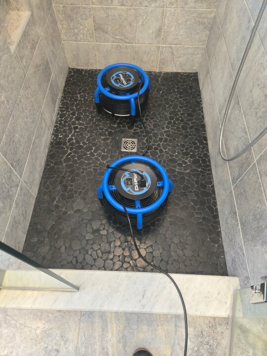

Thanks for the ace advice Mike! The rest of the shower cleaned up nicely, even the glass, but that floor was tough. At first I used a high alkaline cleaner with a nylon brush on the walls, and a brass brush on the floor. Then I used an acidic cleaner around 2 pH or a little less on the floor with more scrubbing and rinsing, and I repeated everything on the floor several times, lots of dwelling, scrubbing, and rinsing. And this is what I ended up with 🙃
It looked better immediately after I finished, but the minerals wicked up to the surface in just a few minutes. I set the customers expectations well beforehand so they were happy with it all. I was in that shower for way too long. I'm going up on my shower prices. They didn't opt for an enhancing sealer to temporarily hide the whitish remains in the grout. This is what it looked like before I worked on it.

I don't know if it is just efflorescence, or if it is also soap scum, but the whitish remains in the grout seem to be spread throughout the grout as if it is woven through it. Whats up with that? Is it just the soluble minerals following the path of the water as it is moving through the grout?

With the amount of wasted time on a shower it takes to make it look a little better, I came to the conclusion that showers are most of the time already ruined before we can clean them. So if 2 different methods of cleaning can do anything (normally about a 30min interval) then it’s time to move on because my customers here won’t spend 300-400 just for a deep detailed cleaning of one shower
