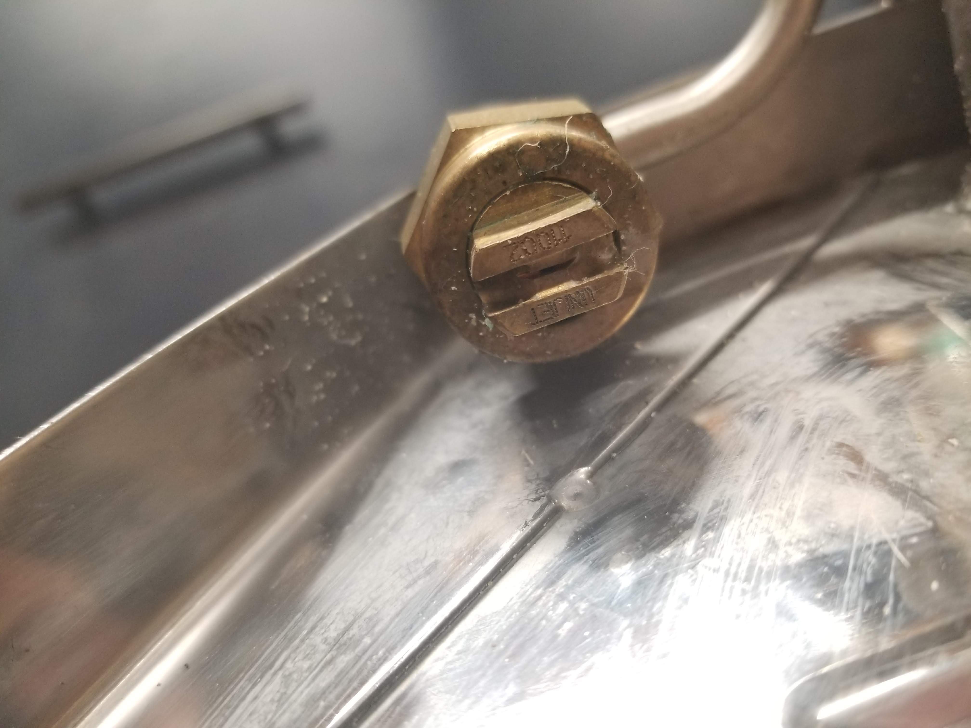

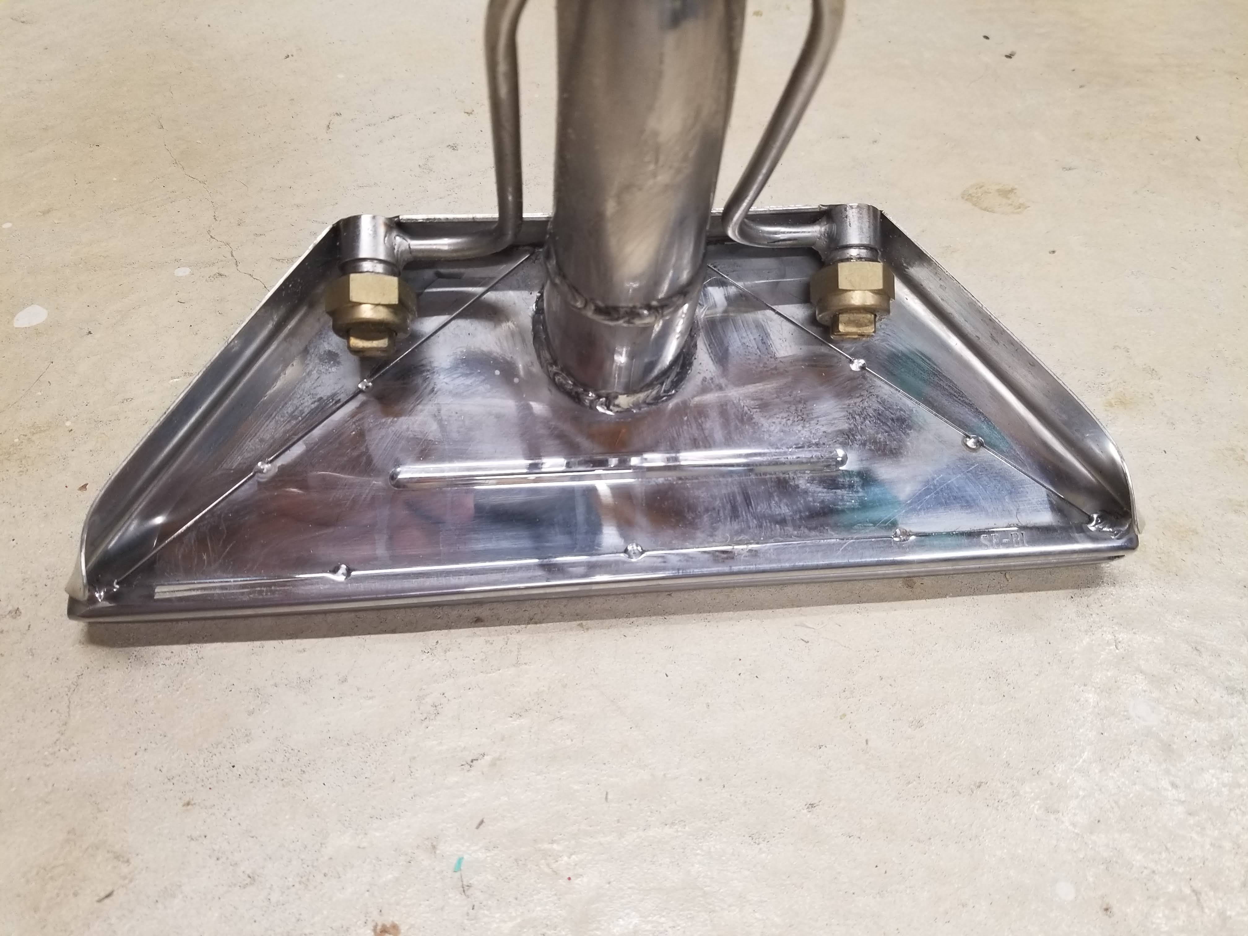

What specifically? jet type or the whole back of the head?
S
soundguy7440
I grabbed both

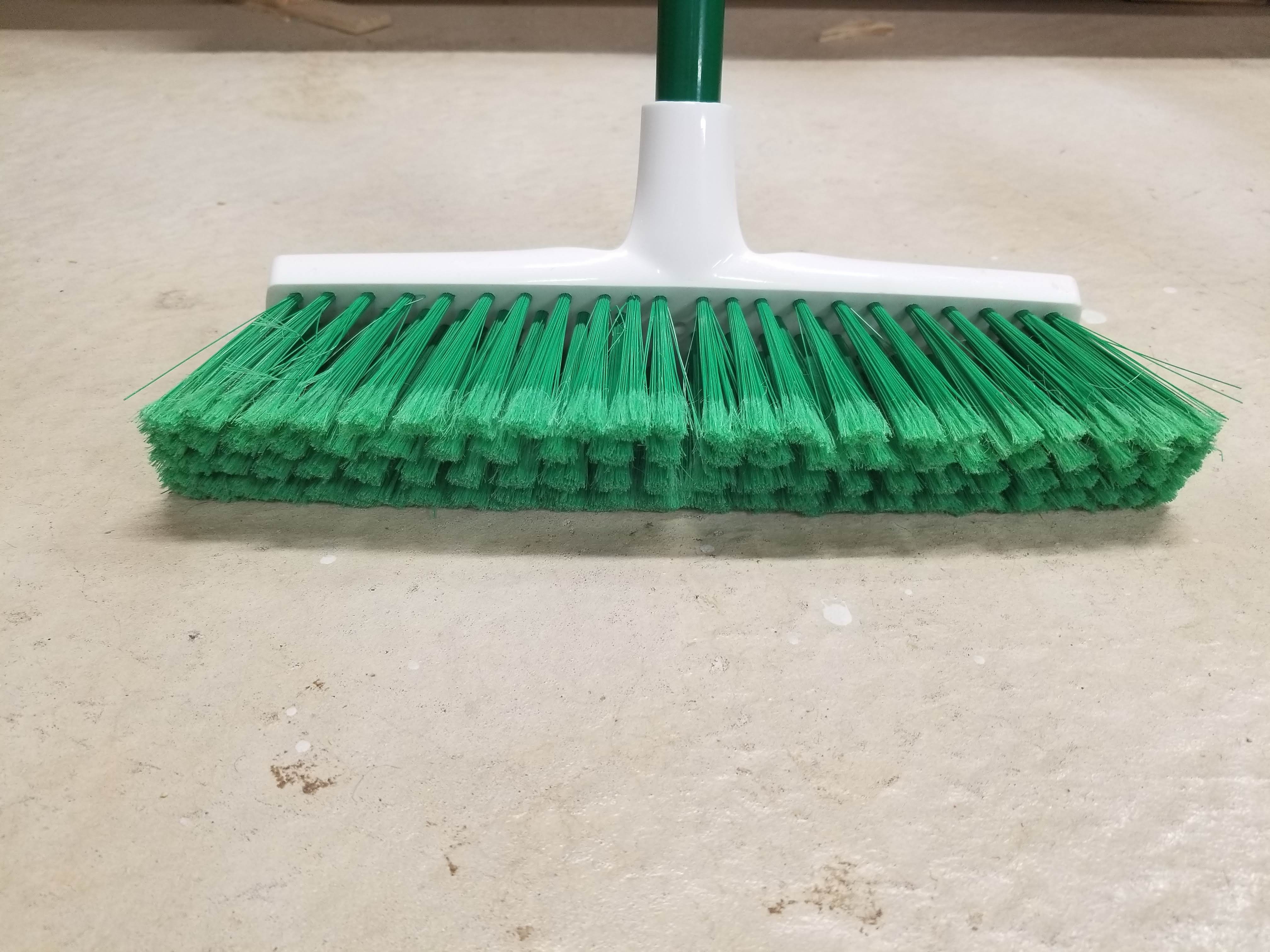

What do you mean by a soft bristle brush? can you post a picture of that?

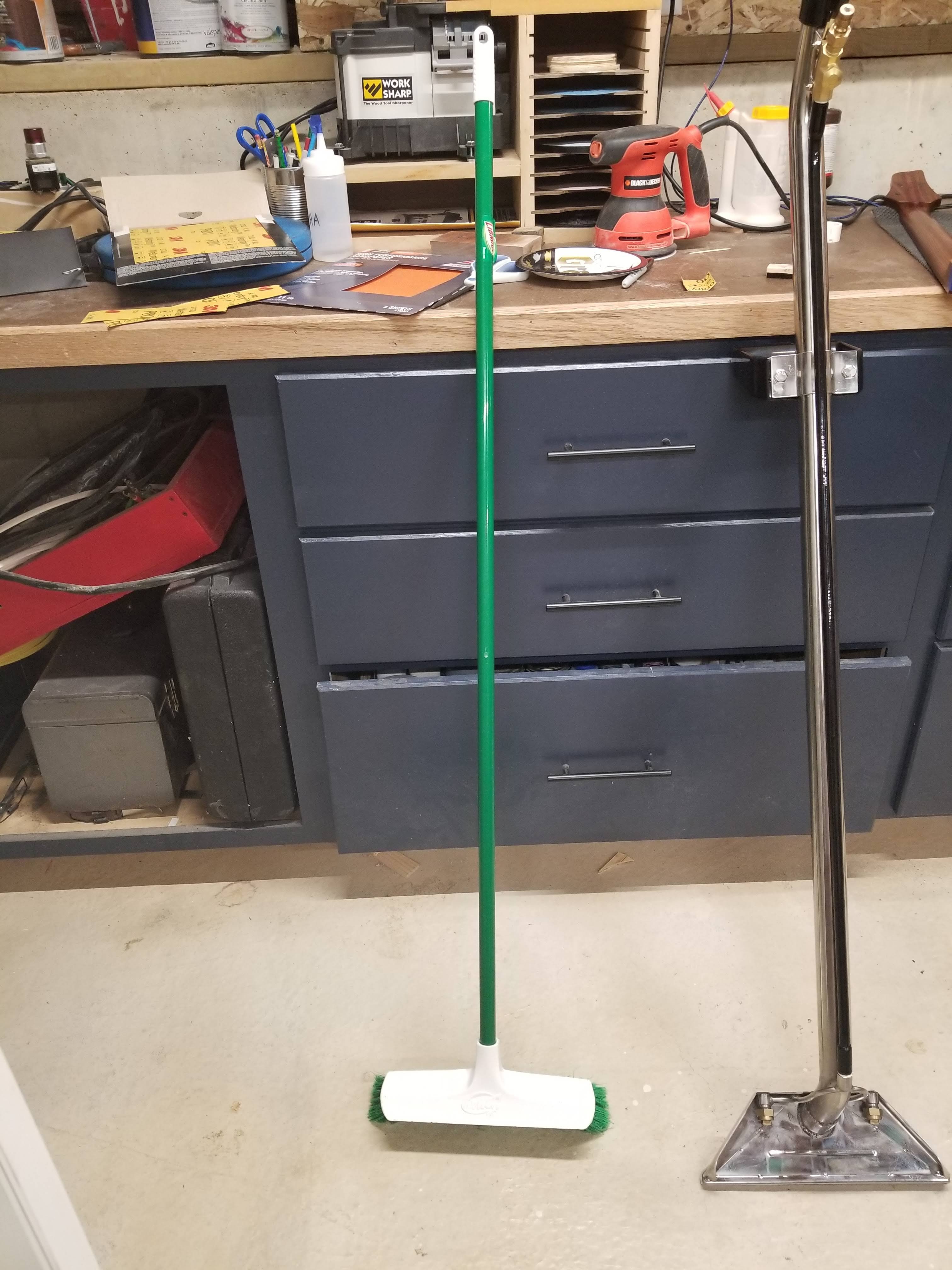

I've done 2 rooms and a hallway in my house (and one of the rooms a second time because it browned a little :() and a buddies apartment. both were definitely close to 3hrs, although the apartment was a little faster because I was doing a ton of dry strokes.
The brush looks like this:

I goofed, you don’t have an Aquaclean and there is no brush. On a budget, buy a 175 machine to scrub. If you are a trust fund baby, buy a 10” CRB.

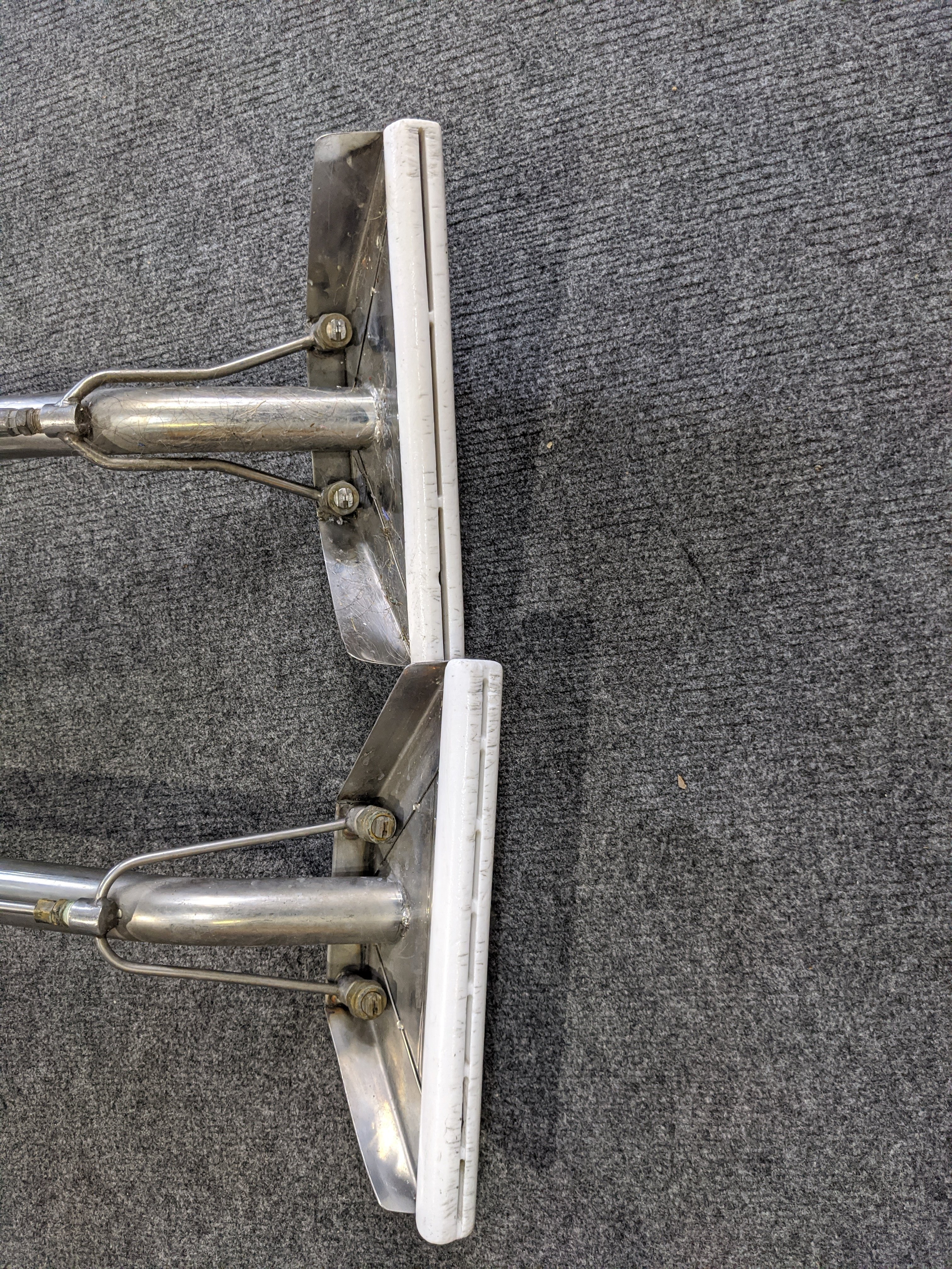

YES a glide will help a lot. Mike sells them and I think Larry Cobb does and I don’t know who else. They are wand specific. First, you don’t have to press and the wand becomes much easIer to use. Then you notice it actually leaves the carpet dryer.

If it's a CMP AW29 we continue to sell those The three or four other knock-offs we don't sell them anymore but we may have them in stock if you can identify it tell us exactly what it is we can check
I just took pictures and measurements and sent it to Lisa. Turns the aw29 from a pos to something quite useable. Especially in tight areas.
