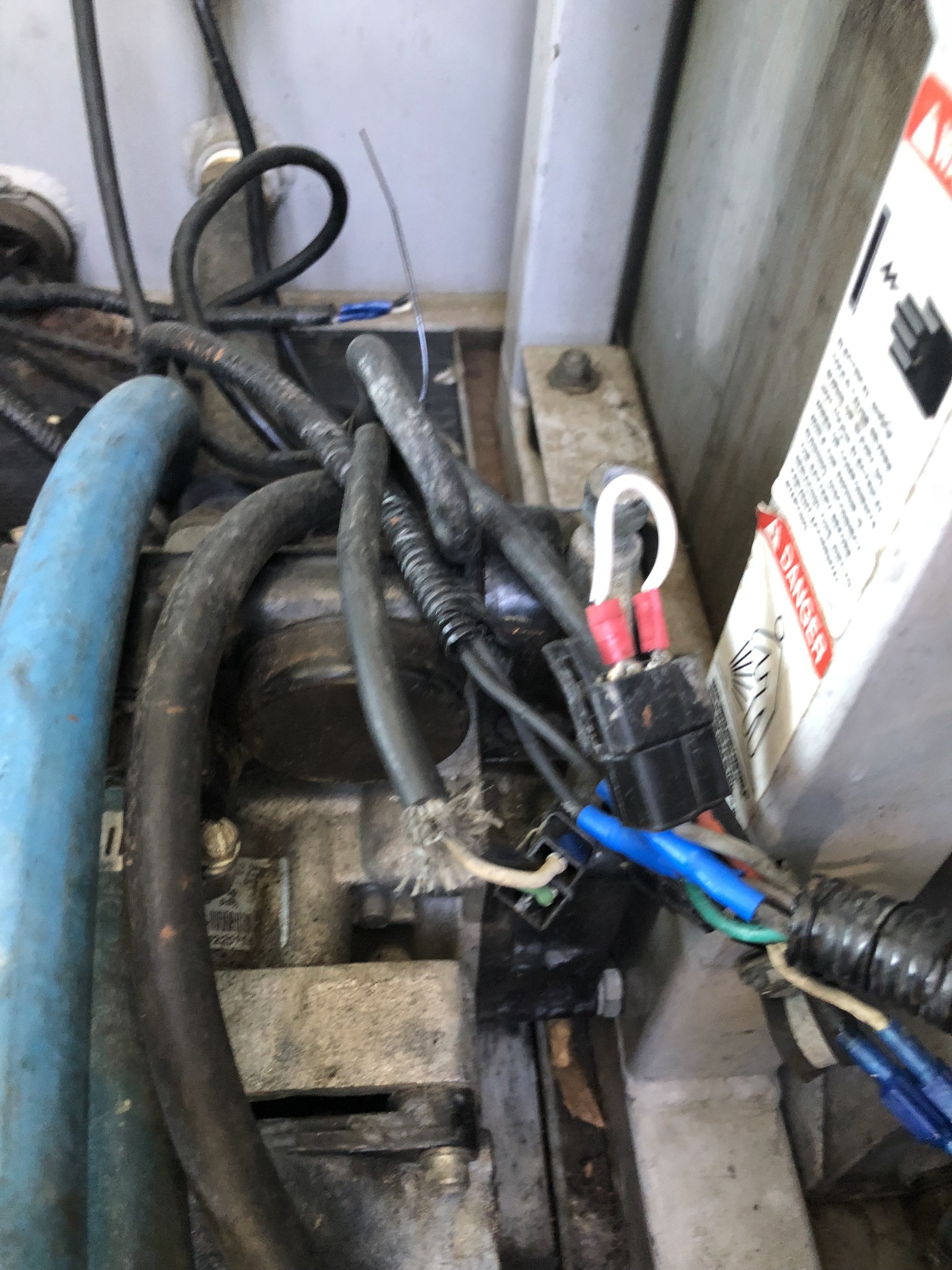

I ended up swapping trucks with Phil and trouble shooting his truck at home!
Changed fuel filter jump started it ran for 2 minutes and shut down!
I finally bypassed the shut off float switch and got it started!
Let it run 20 minutes and went and did my last job!

So happy that the loop wire helped me diagnose the bad float switch!

Then you start to use the jumper wire to test the waste switch!

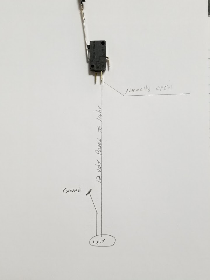

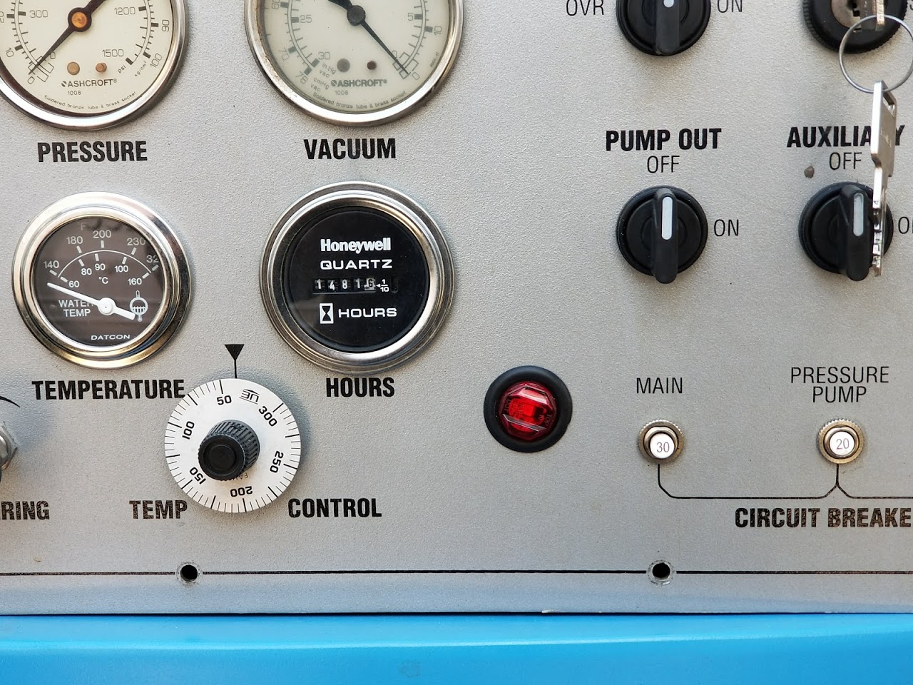

I added a light to mine...so if the tank gets full it will come on....with Jr out there using it ...it has saved me a few times....
here is how to wire one up....
Reactions: SamIam and Nomad74
