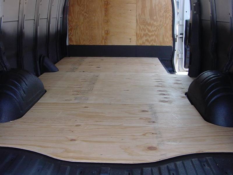

My van(s) came with a 3/4" rubber mat floor cut to fit. You could get the material at a farm service store.Stall matting is what it's called. The stock flooring would hold a lot of moisture over the long run.
We do as Shane does but with blue boat carpet over plywood, it can take the punishment for 3-4 years the we tear it out and do it again. Sand and touch all the paint with enamel paint so everything look purty. :winky:

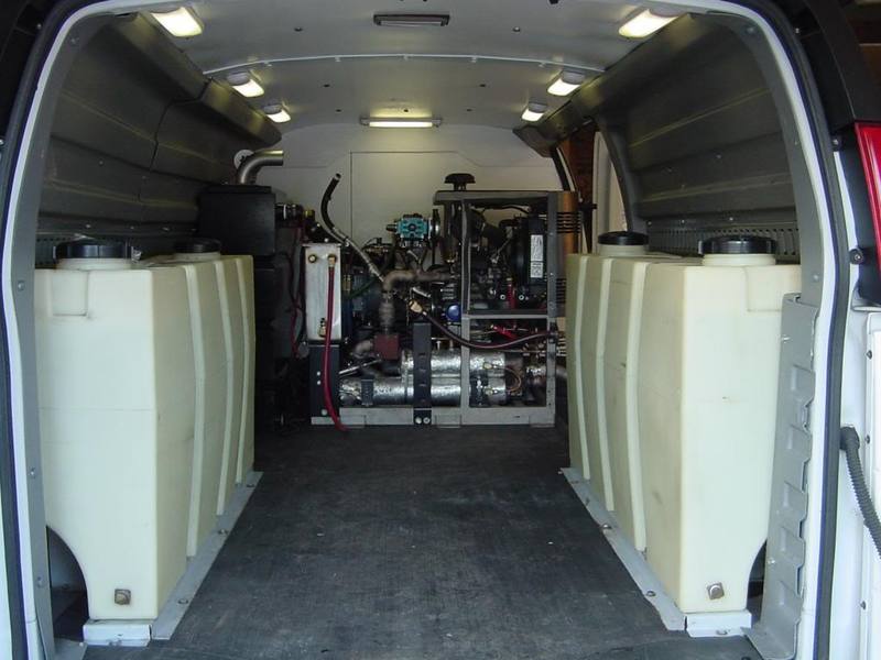

120 gallons, It's a 3500 extended and when completely loaded it is pushing 9600lbs. Rides great with weight on both sides and with 40,000 miles on this set up there have been no issues with brakes, steering or suspension although it could use up-graded front coil springs. I'll see if I can get a pic of it totally loaded.
