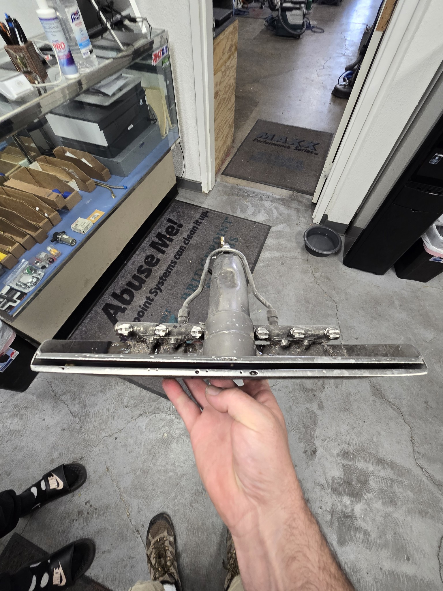

I believe offset wands are harder to push , so you know what wand to buy if you have these issues. I’ve never liked anything offset
116,006
