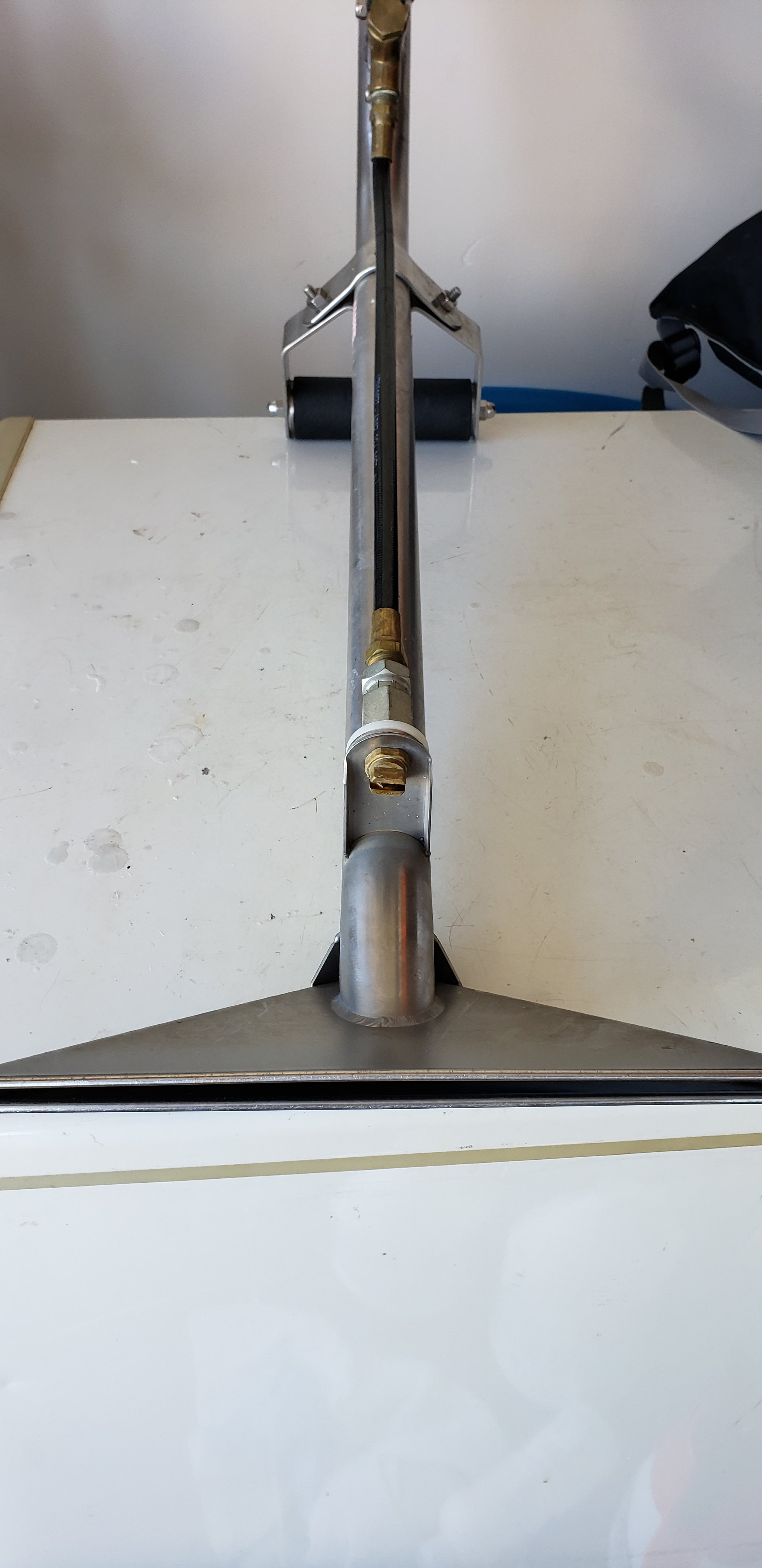

I'll see if I can find it on their site.Get the two jet manifold made by PMF. Greatly improves the tool.

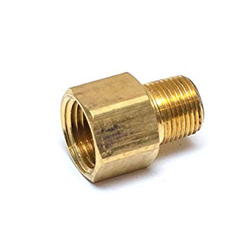

Awesome, thanks!with something like this
should be able find then at HD in the brass fitting section of plumbing
stack two or three for whatever length you want

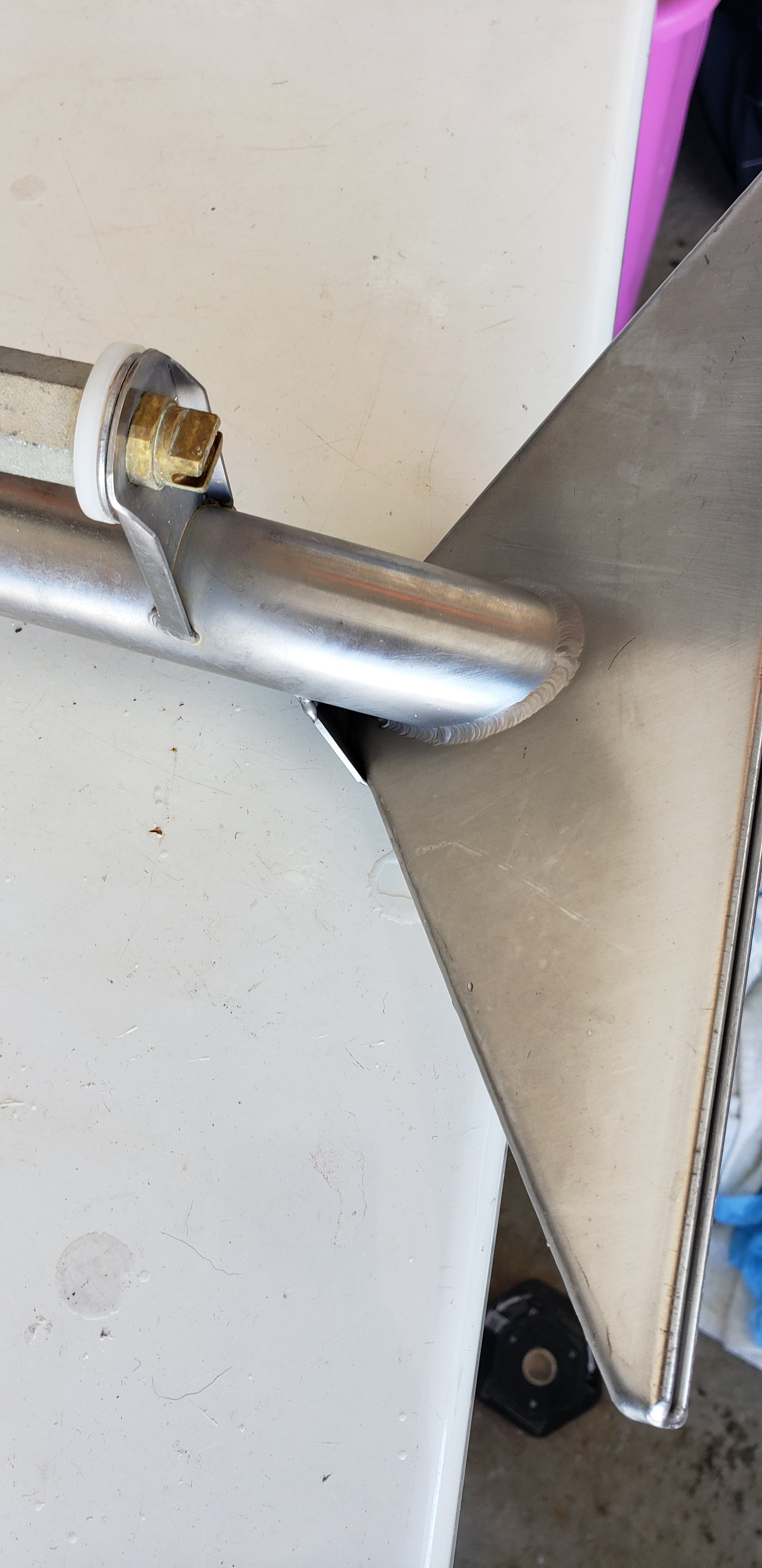

You'll also need a wider angle jet.
How wide will be contingent on how much you extend
If not aware, Nick, the first numbers on the jet are the degree angle (80, 95, 110 degree, etc)
