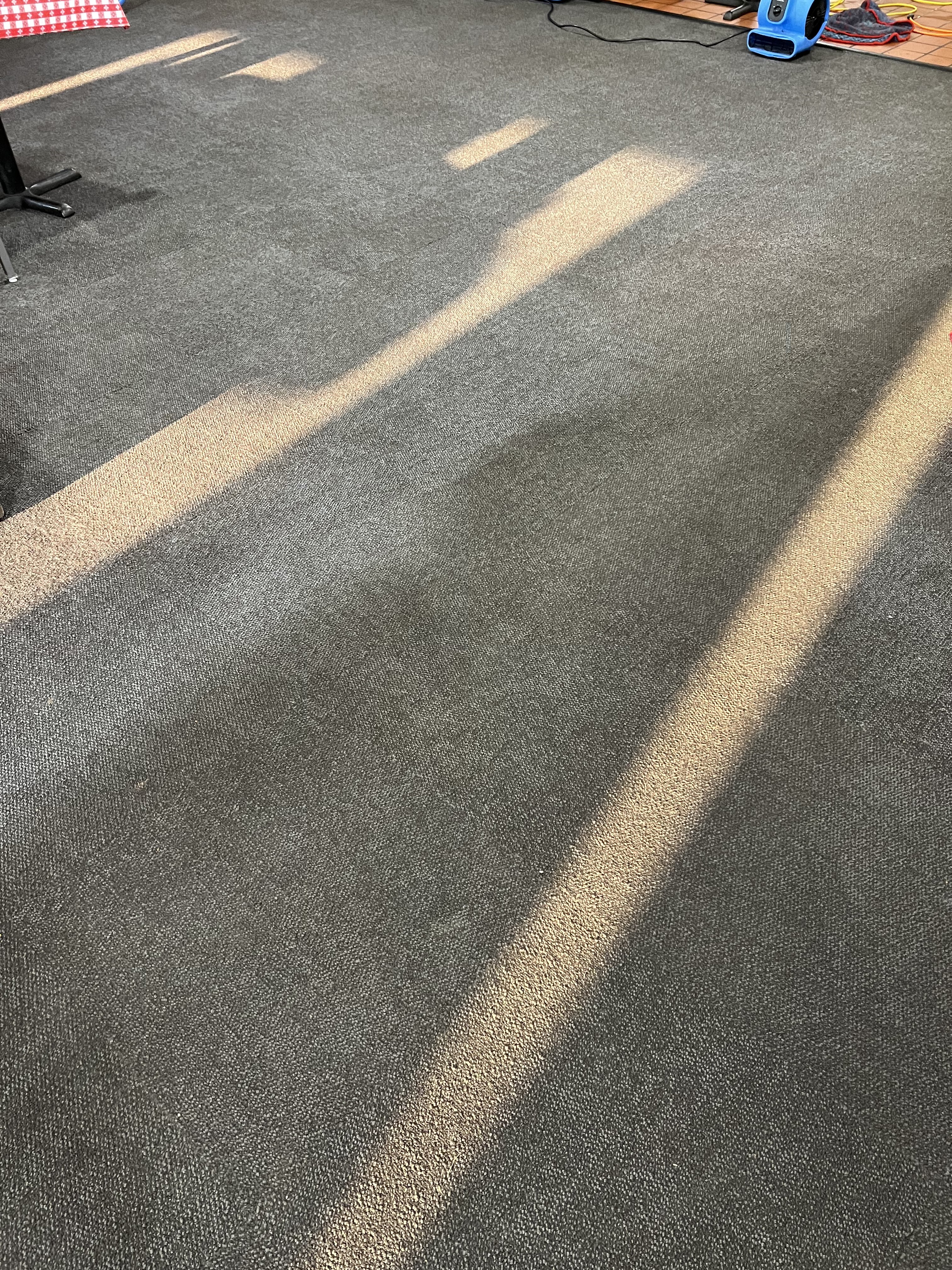

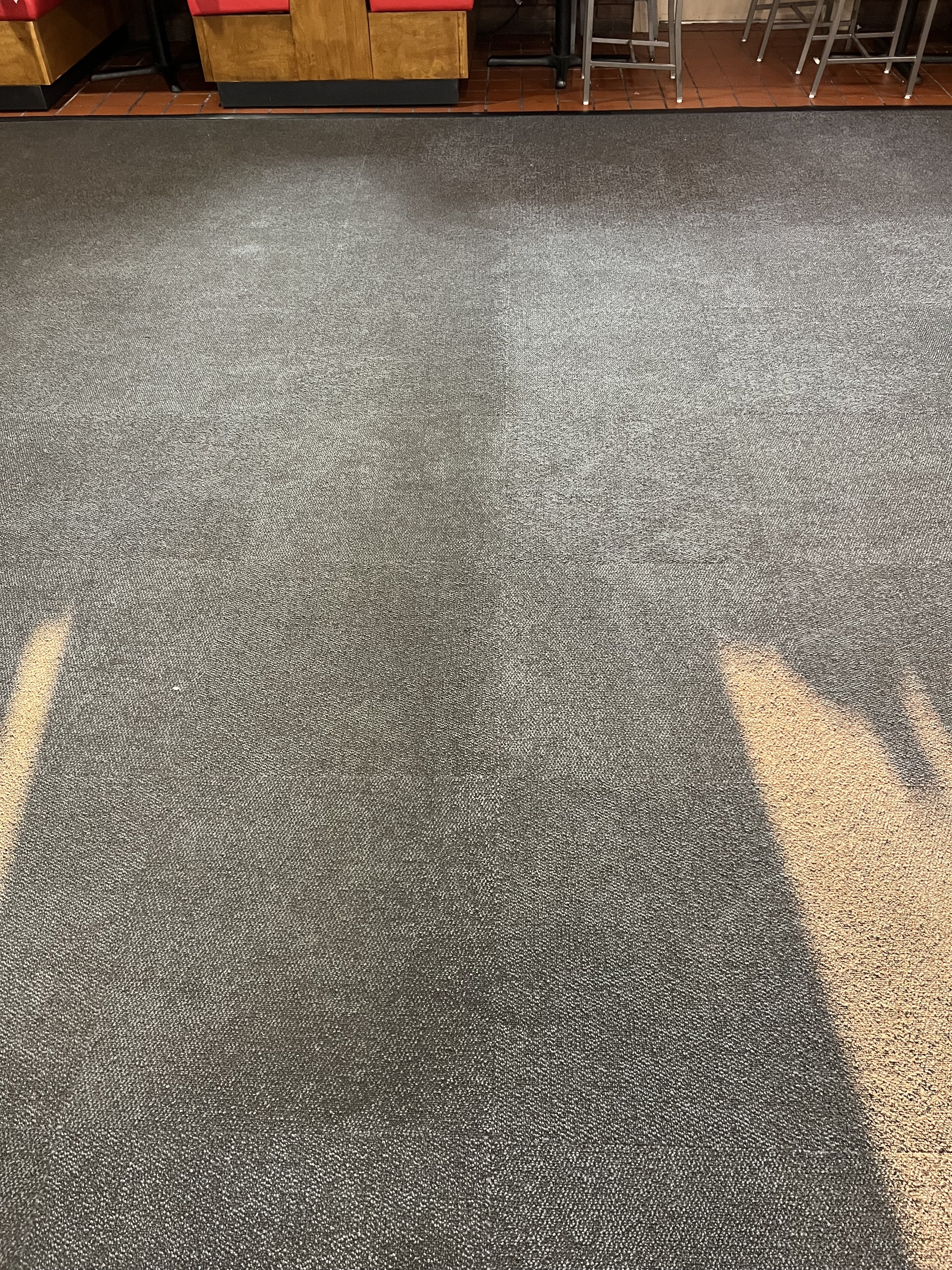

Well I am.
Cimex with grey pads, Phoenix with microfibers, 4 opg Commercial Magic at our local Pizza Hut.
They’ve been getting national exposure on social media for being “retro” (outdated decor) and decided to get the carpet cleaned.
68B9AB28-F669-4DC6-8A03-D9637E8FDF7F.jpeg DA19ACDD-AD7C-4696-8F64-1B3C8ED202D9.jpeg

Cimex, for scrub followed by op and microfiber?
Yes.
Prevac, prespray w/ Commercial Magic 4opg, Cimex w/ grey pads and Commercial Magic 4opg, Phoenix with micros CM 2 opg. Air movers ran for the last 20 minutes, left them on afterwards and picked up later in the afternoon.
Would’ve extracted, but as soon as they start in on dry times and how it absolutely, positively, HAS TO BE DRY BEFORE WE OPEN… I automatically forget HWE and just VLM it with air movers.

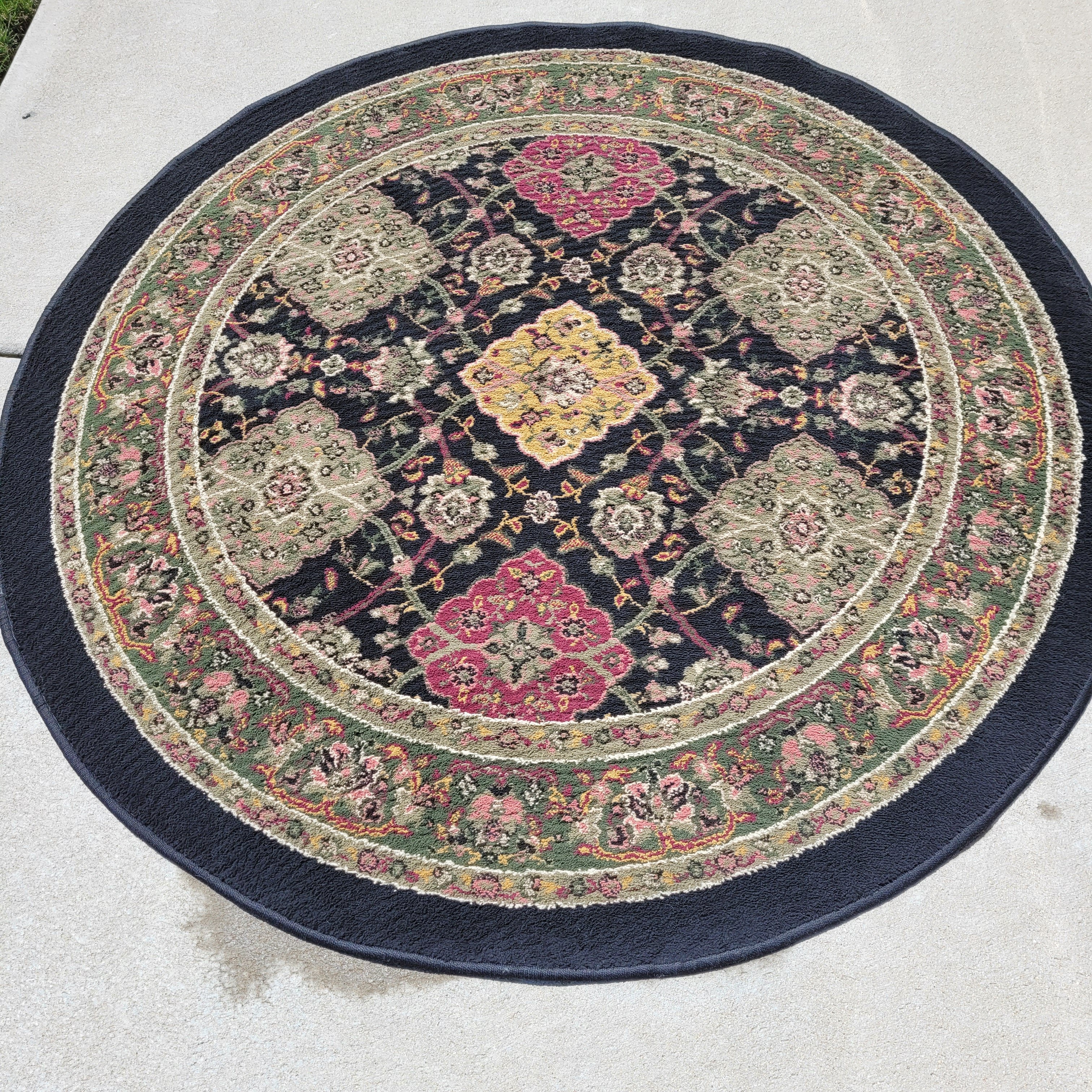

Some would argue that rugs should be cleaned exclusively in places designed just for that, rug cleaning plants. The majority of us would disagree with that for a simple reason; if we can clean a small round rug in a customer's house traditional way ( similar to the carpet cleaning method) and charge $100, who is in better shape, rug plant owner or O/O?
For your satisfaction, I've fixed the title in my photo album👉
