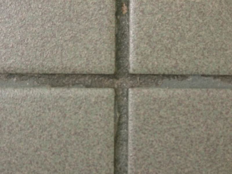

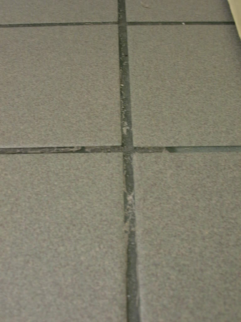

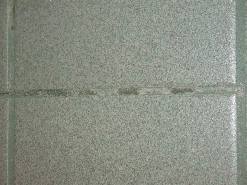

OUt of all those degreasers in the Betco line, including butyls, which do you think would be the most effective in removing a wax/sealer out of a grout. I have 120 rooms that were sealed with a topical sealer that is a major PIA to get off the tile and even tougher to get off the grout. I have tried barebones and citrus chisel with some success but it still took way too long. I open for ideas, they want if off and know that it is going to cost them.

.....and the rest of this story on the sealer on tile.............
Used bare bones mixed 1:4 and let dwell for 40 mins. Brushed in with nylo grit hand brush and then grout brush. Turbo'd off. Small pieces left on grout, let dry and then brushed the small pieces off with with either wire brush or grout brush. Not easy, but did it.
Dwell, dwell, dwell.
