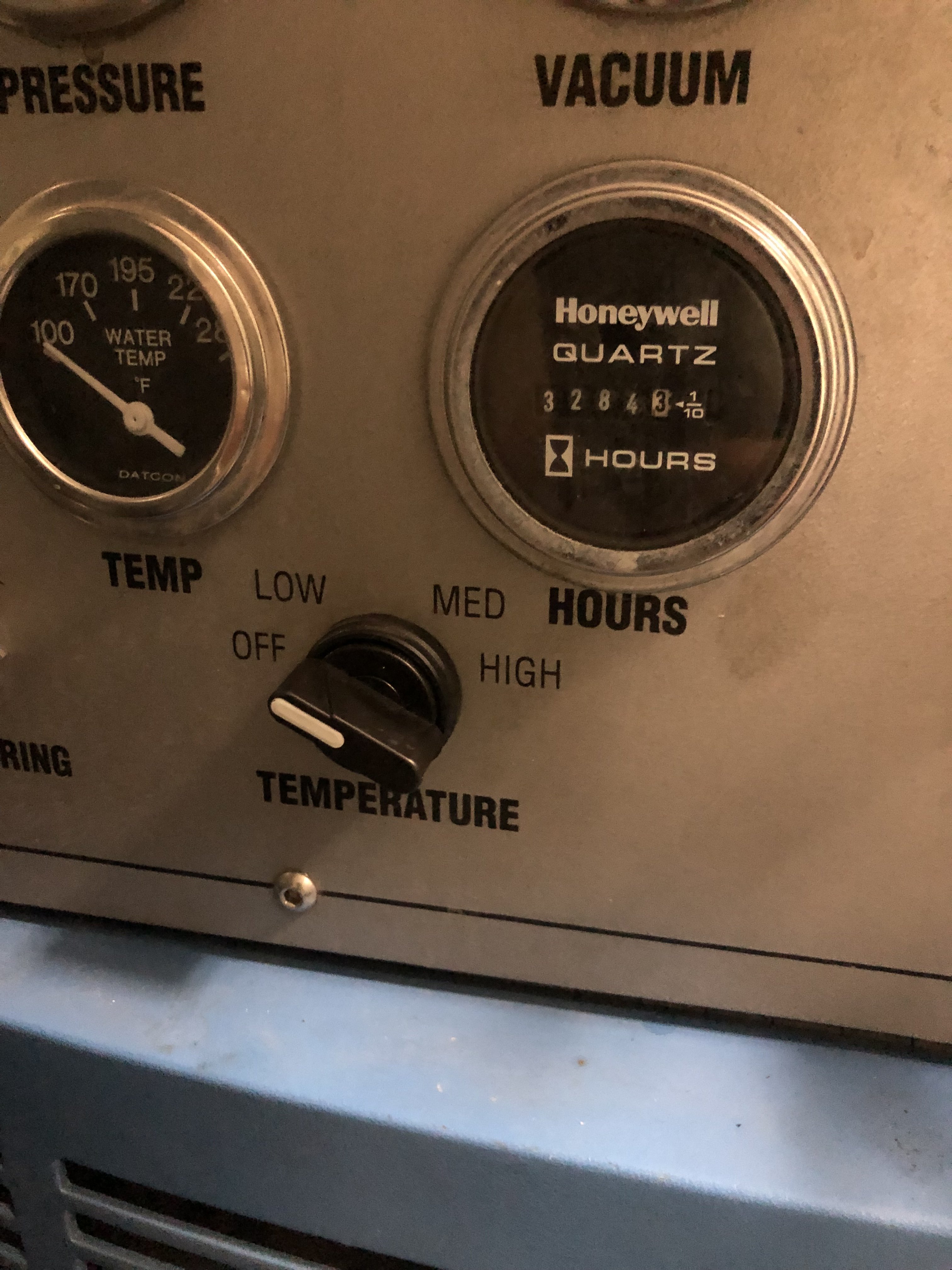

My switch’s went bad on mine low med high that made to where the bimba didn’t move

The machine isn’t producing heat because the bimba is stuck on in and not heating.
I manually unhooked the hoses to the bimba and pushed it away from the blower. And it got hot.
The problem with this is you can’t let it sit or it will eventually get to hot.
Then your 165 temp valve runs the risk of getting premature wear and leaks.
It really is a simple machine besides the switch’s and electronics that cause the moving parts to work.

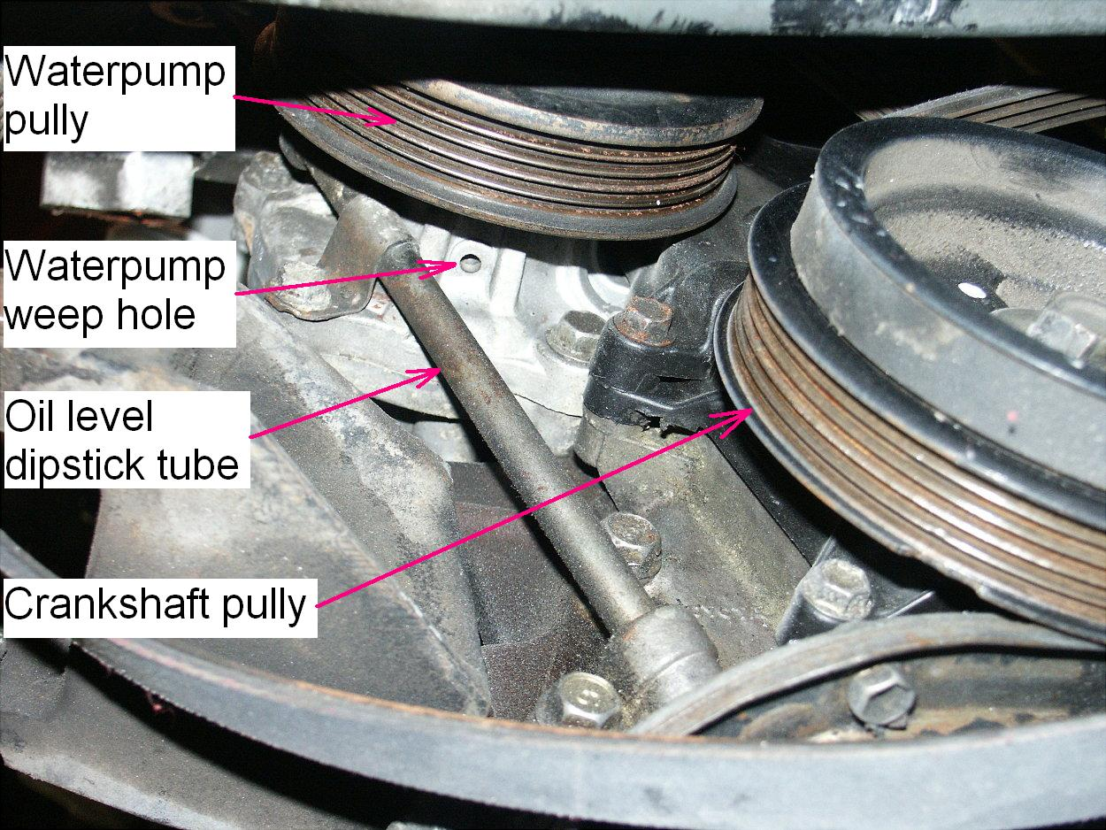

I've been corresponding with Justin from Legend. Working through one thing at a time. I think the diverter is always open because the water temps don't get hot enough to close it. I'm wondering if the problem might be an air block in the cooling system because the water pump has been weeping water. I do get occasional hot water and when I do, the radiator cap on the motor is hot. When the temps suck, the cap is warm at best.
