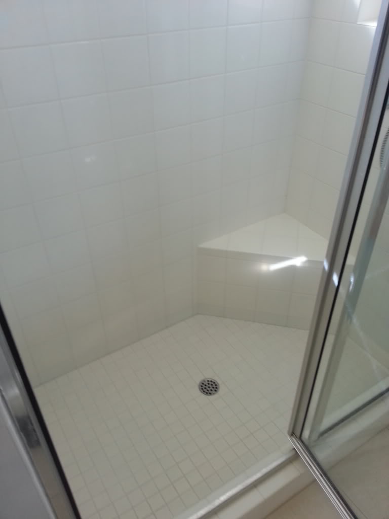

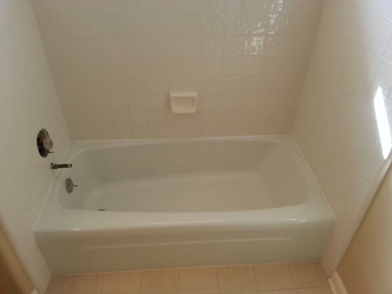

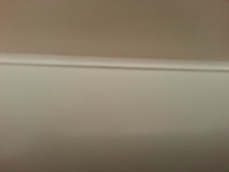

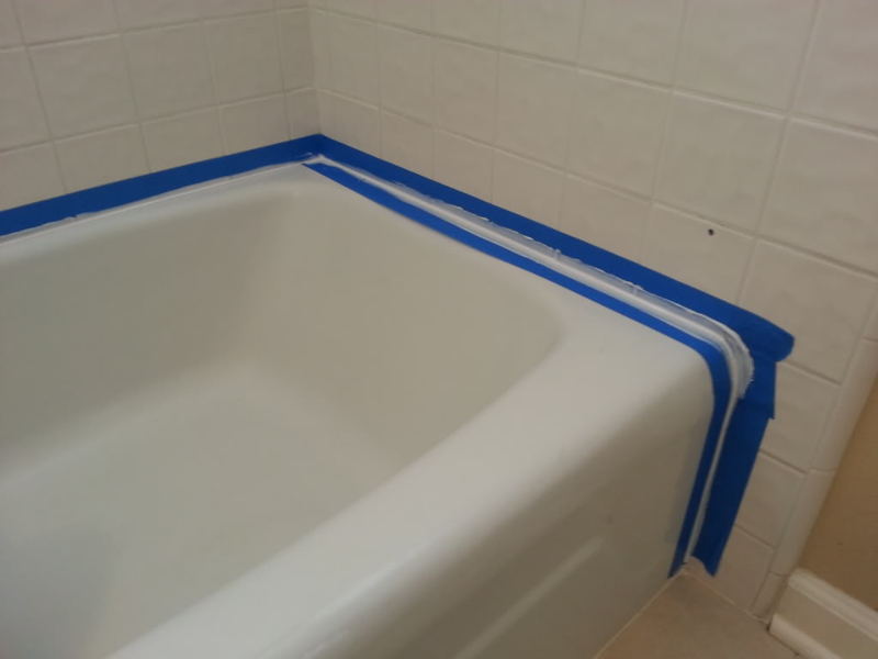

Mask off the wall and tub. Makes it easy and the finished look is stupendous.
When you remove the tap you'll have a slight hard edge to the silicone. Take a wet finger and do one long continuous wipe to smooth the edge.
Nice clean but boring shower stalls...
This one got the perimeter edge re-grouted/layered. We use Concrete Fortifier (glue) instead of water and unsanded grout when doing these sort of repairs.

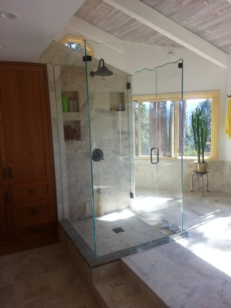

THIS is an exciting shower stall we were at earlier this week..
Notice the top edge of the glass walls.

I recaulked my bathroom and used one of those rubber tools that squeegees the caulk. It worked pretty good. Have u ever used one of them? Do you color seal the showers? I can't tell from the pics.
116,041
No color seal showers that sees daily use.
I like my fingers better than those rubber gadgets, I have ten sizes to choose from.
