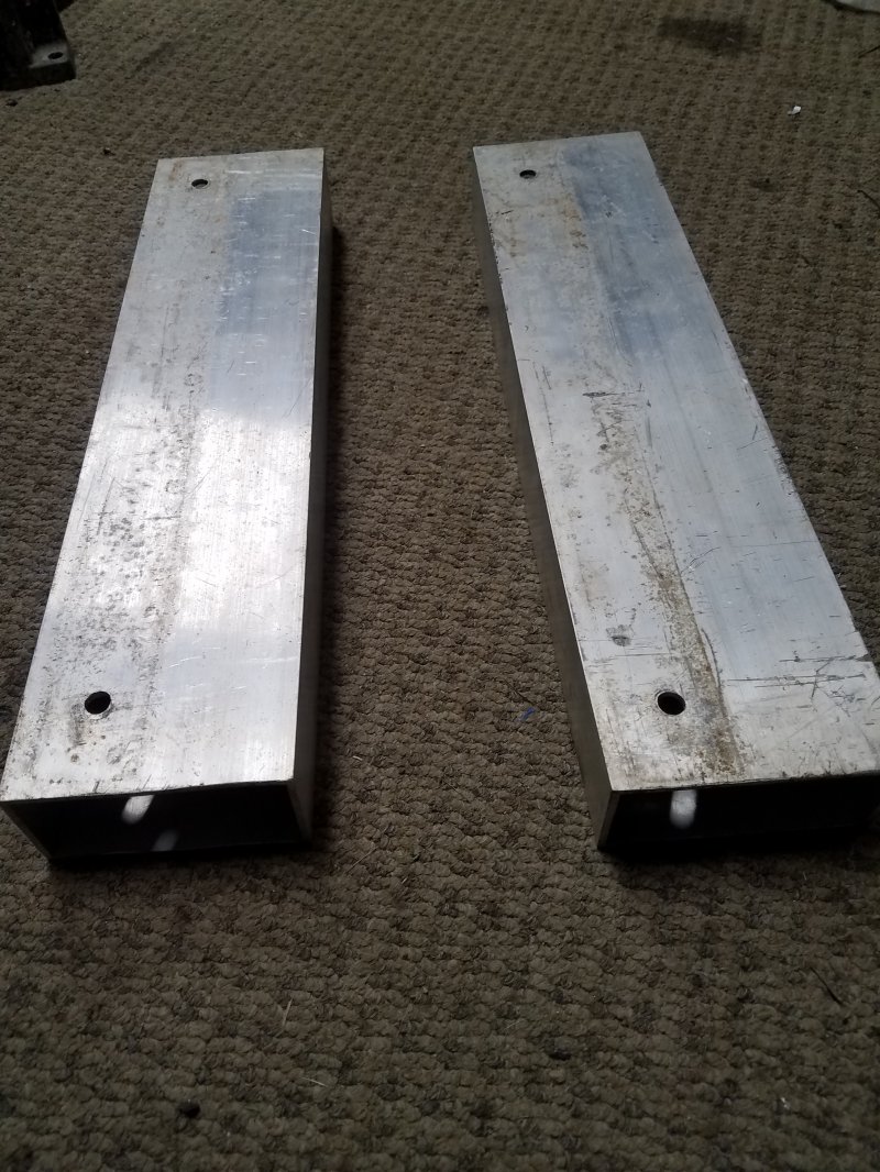

So the reel sits on 4 nuts with big washers, or what?
Able 1
Apr 12, 2008
6,469
Wi
Keith
Just wrong.. If you want to take it out you use these..
Aluminum bolt them to the floor and then you can take the reel out and in no problem..:biggrin:
