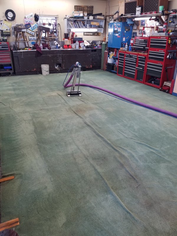

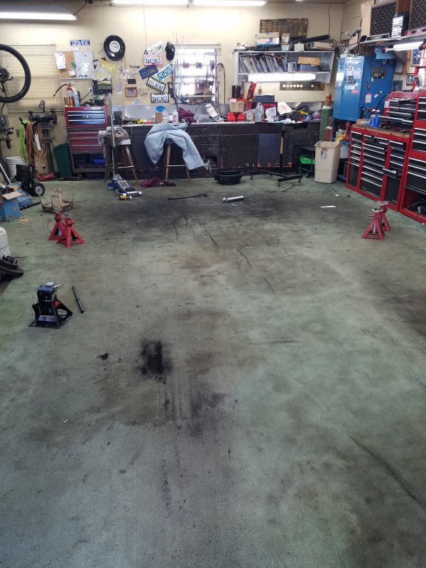

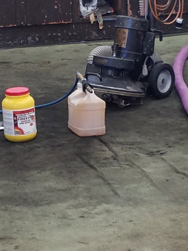

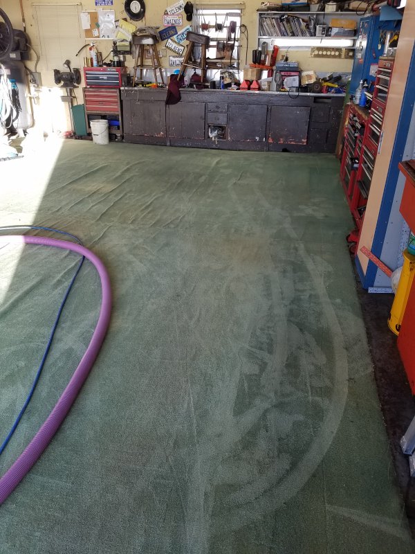

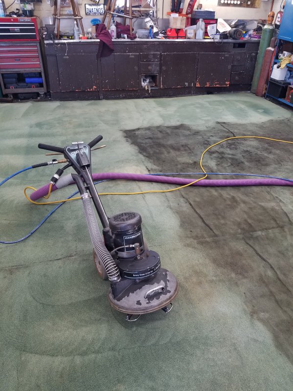

back in the 80's when rx20's first came out i wasn't convinced i needed a 2500.00 attachment to make my 15,0000(that was an expensive tm then)carpet cleaner work better . Like you sometime around the mid 90's i ended up with one. Got it for free. It had froze and didnt work. It sat around my shop in the way for 6 or 7 months. 1 day i got a bug up my ass and got it to work. The next day i went out and bought a brand new one and from that day on I've used a rotary on every job. I love um! However I do clean carpets a little differently . After prespray i clean and dry with rotary and use an emulsifier. Then switch to a rinsing agent and clean and dry again with a 45 year old drag wand. Below is my shop carpet after replacing the entire front end on a chevy 3500 van and a ford ranger, yep thats alot of bearing grease!
