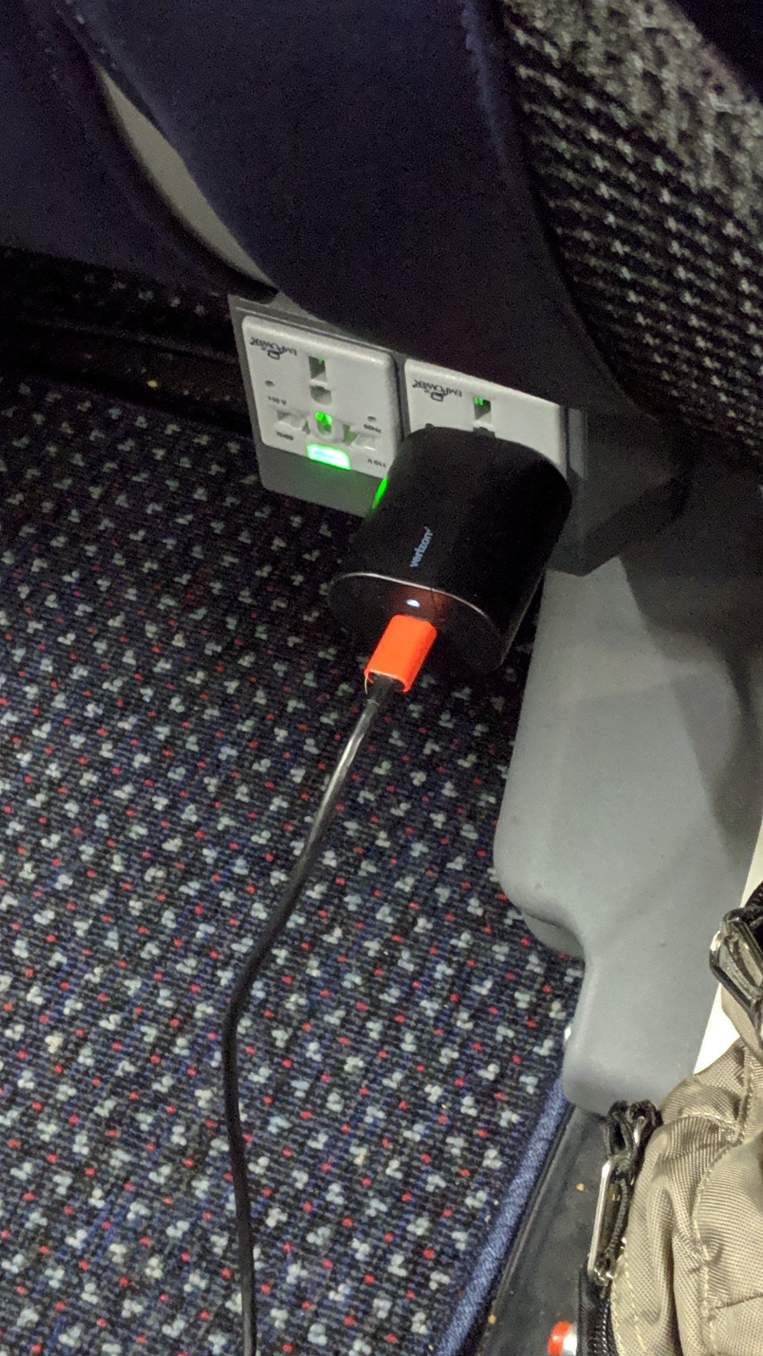

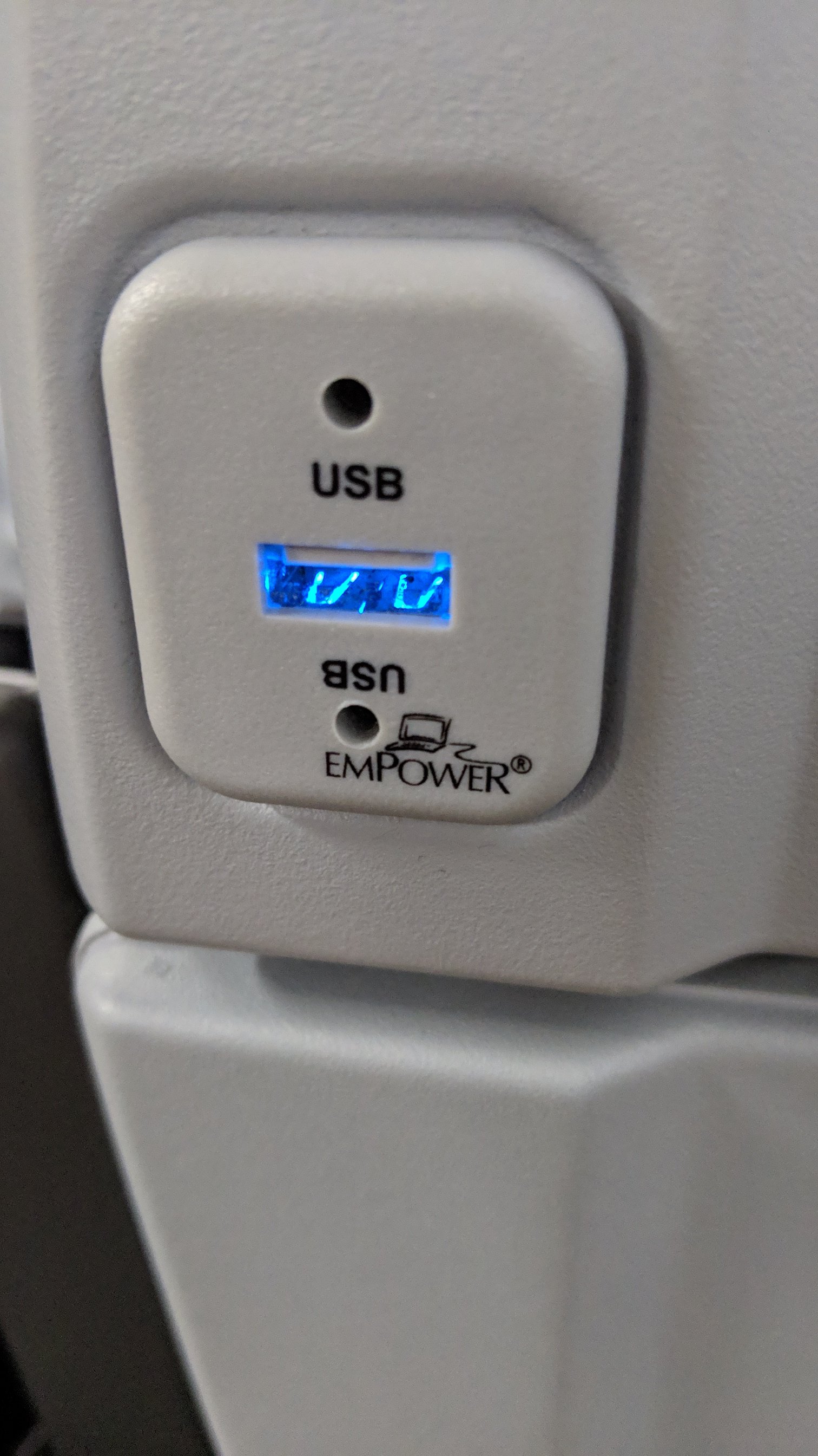

So after you enjoy your flight and the wonderful customer service attitudes of flight attendants and gate agents, you might want to further this discussion with Bill.
116,268
I got to reserve the exit row and just look at these bonus features that the $30 per checked bag gets one on American...
