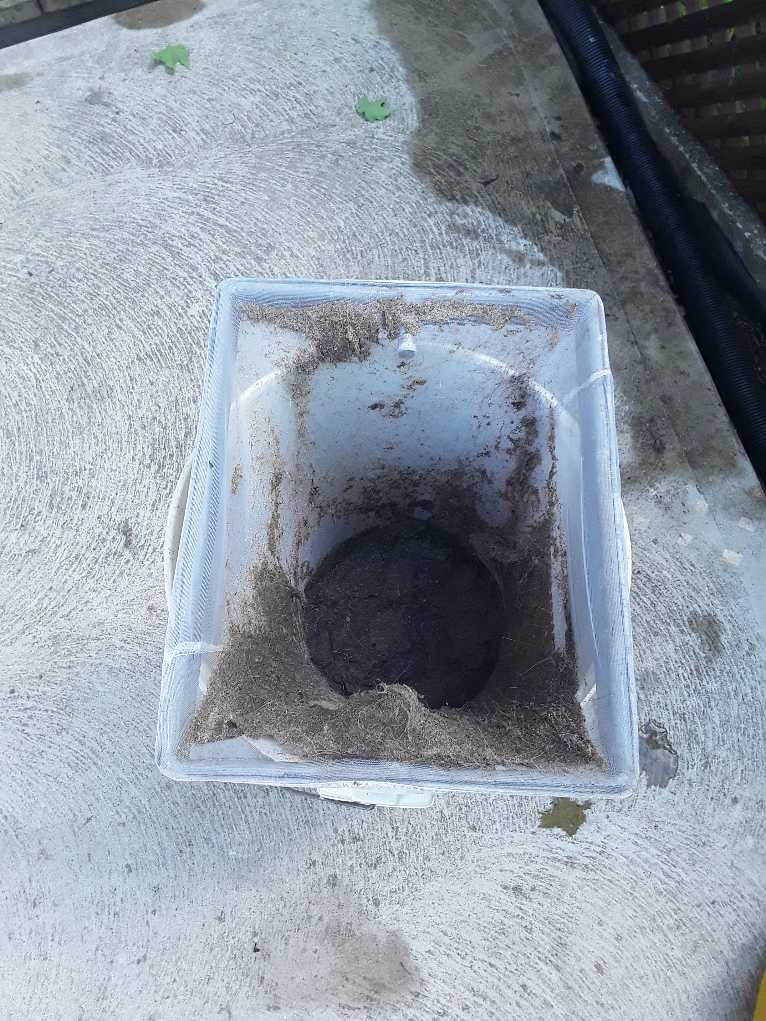

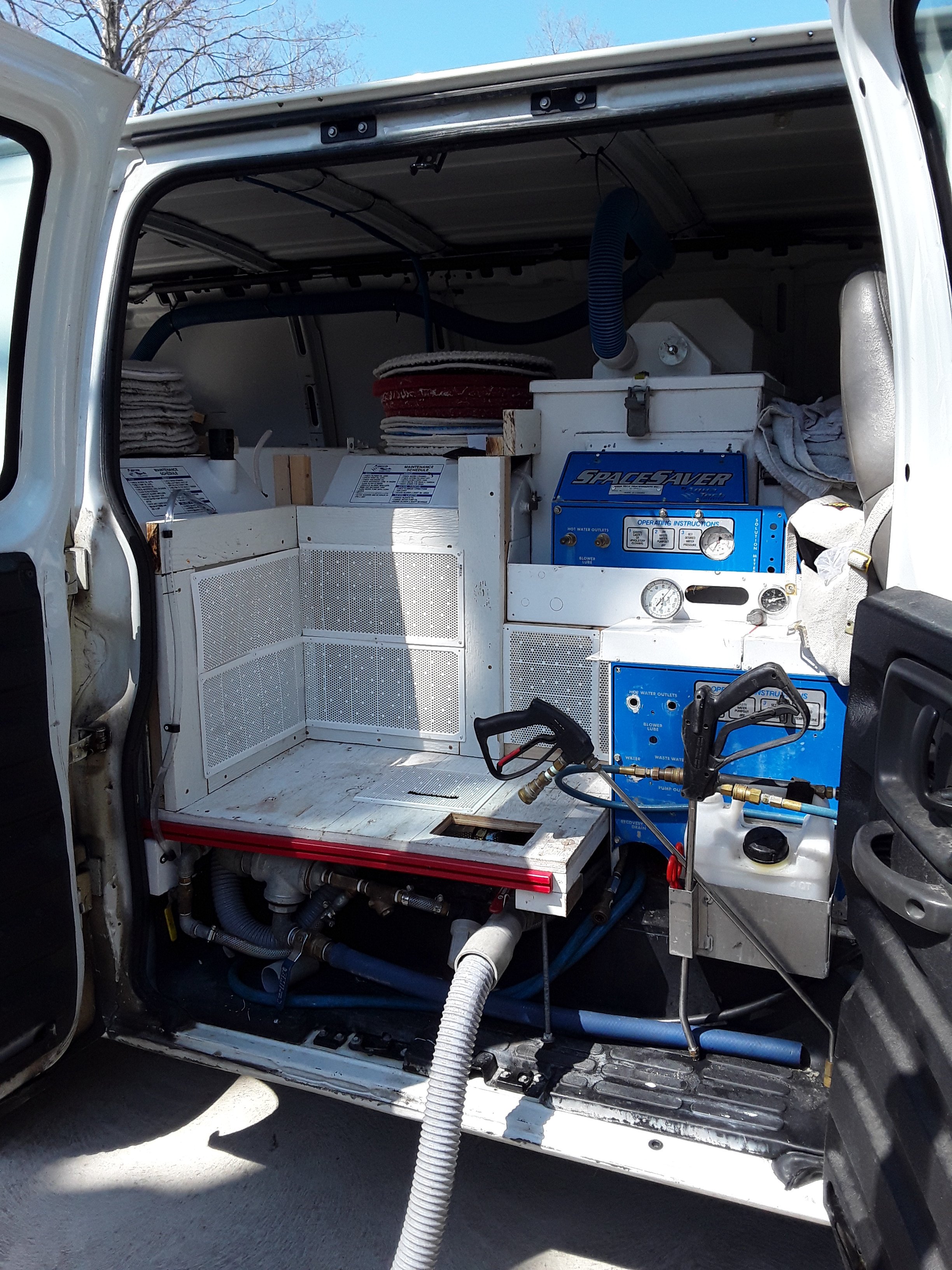

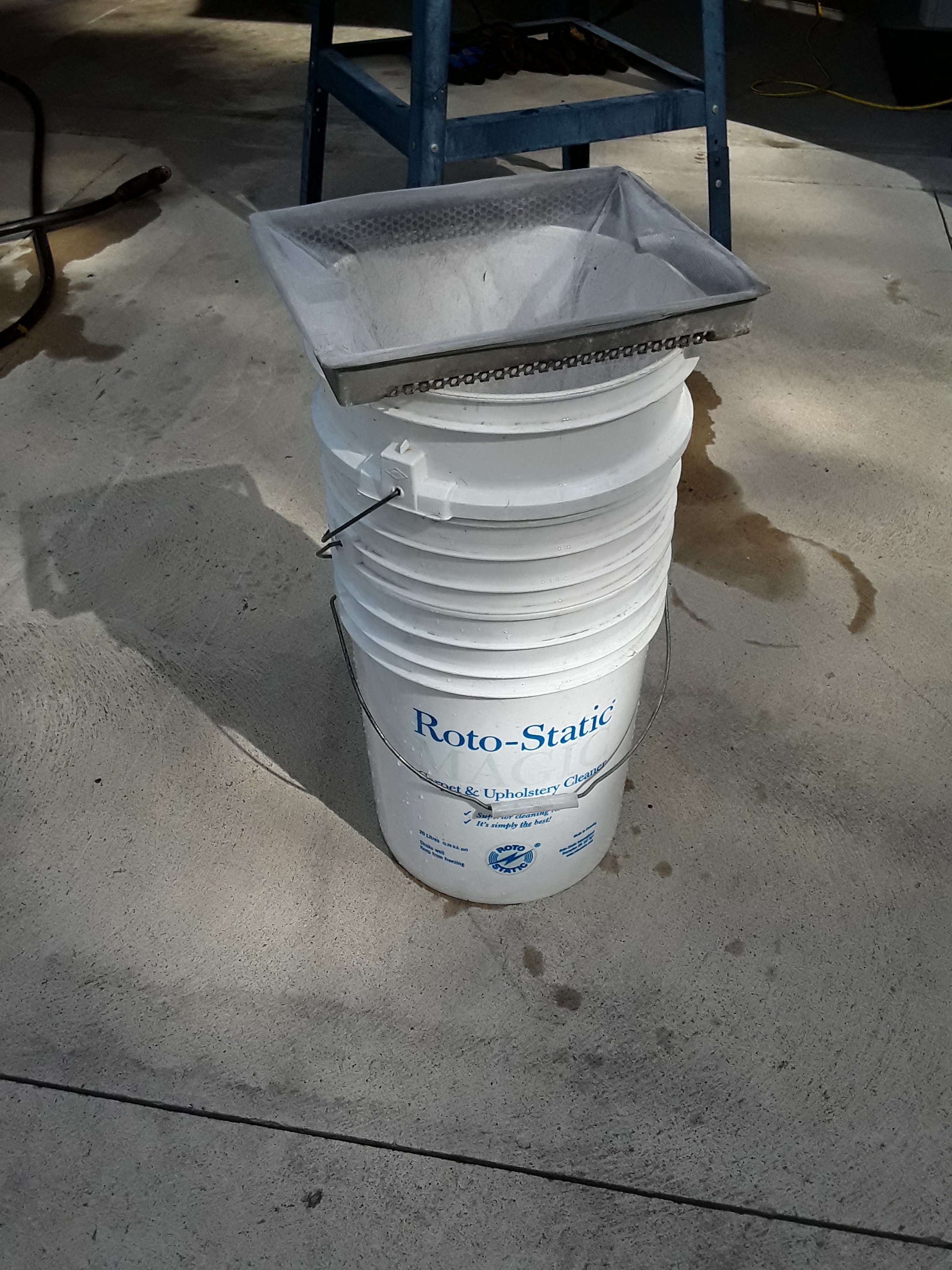

Here is my capture system for one of my AquaTech units.

I have a Sapphire box filter but have gotten lazy.
Yeah me too. I love everything about it. Except how it filters out crud. The basket just lets stuff past. If I’m gonna have a filter I have to hook up every time, I don’t wanna have to empty the waste tank basket filter every other day. I stole/ permanently borrowed a Butler filter box and run paint filters.

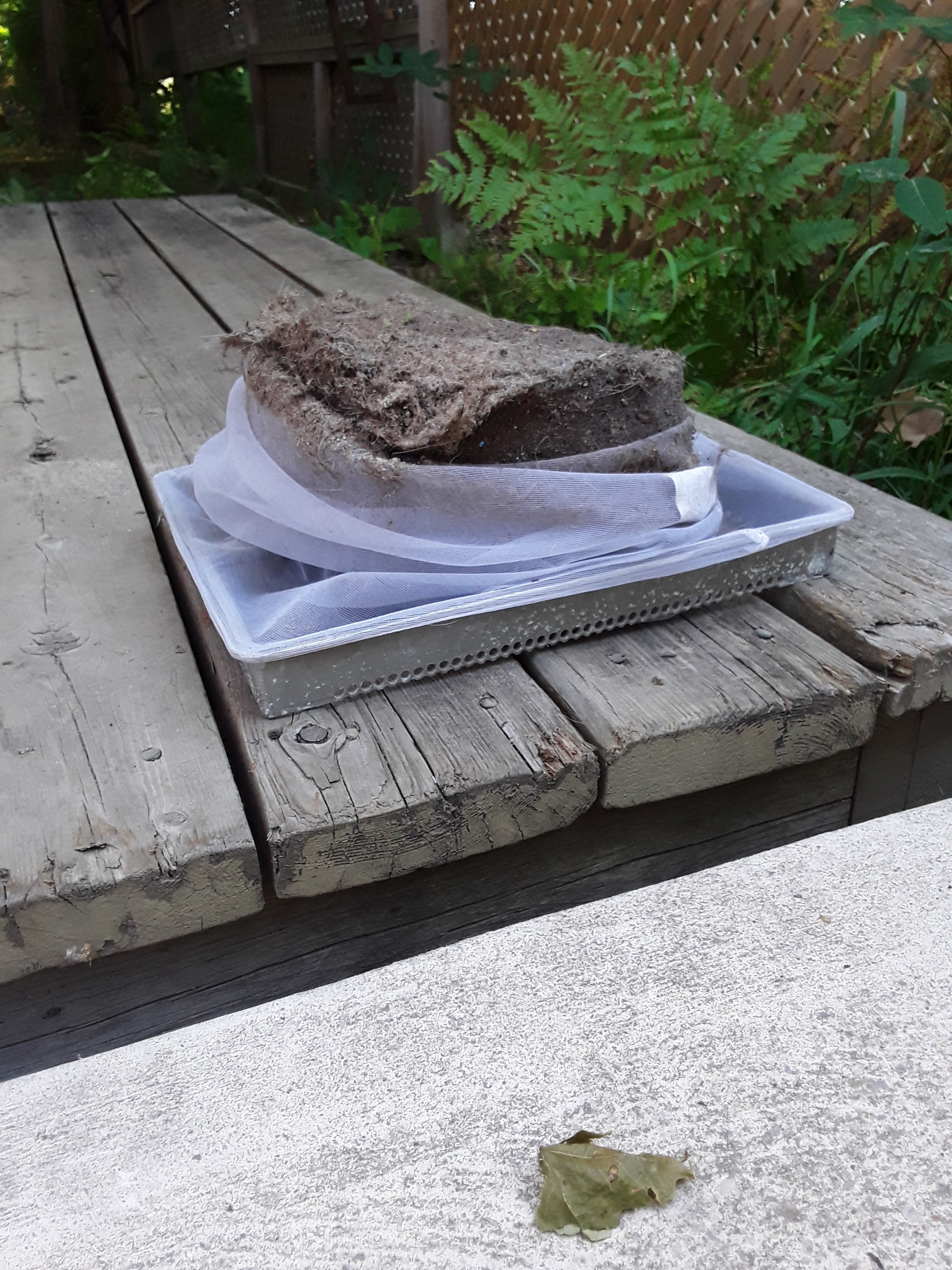

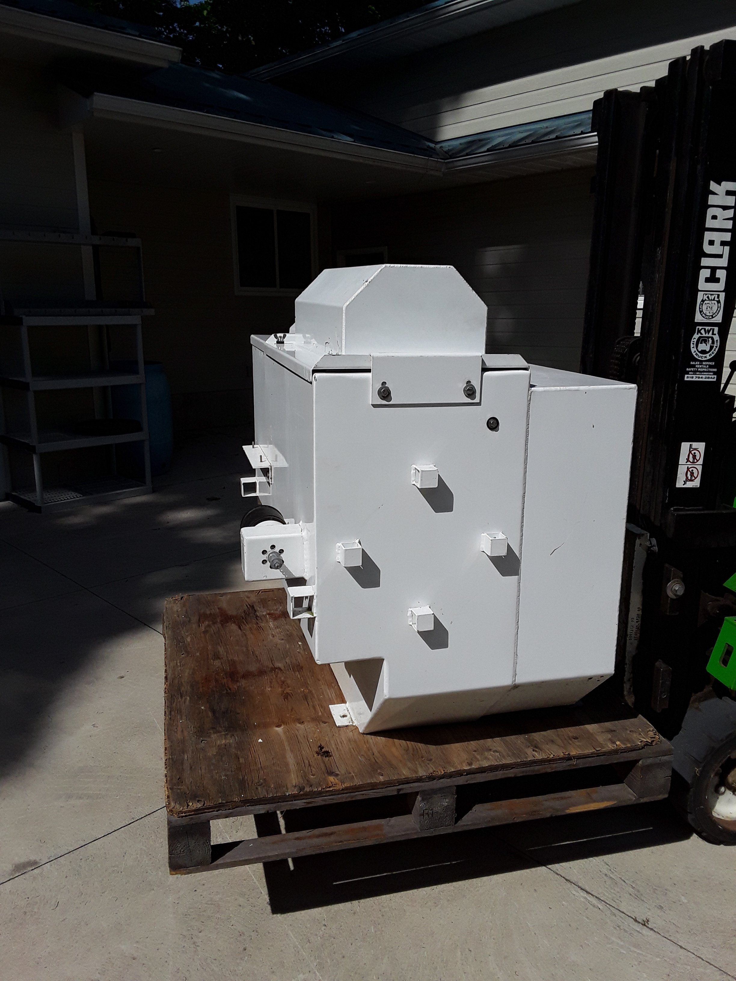

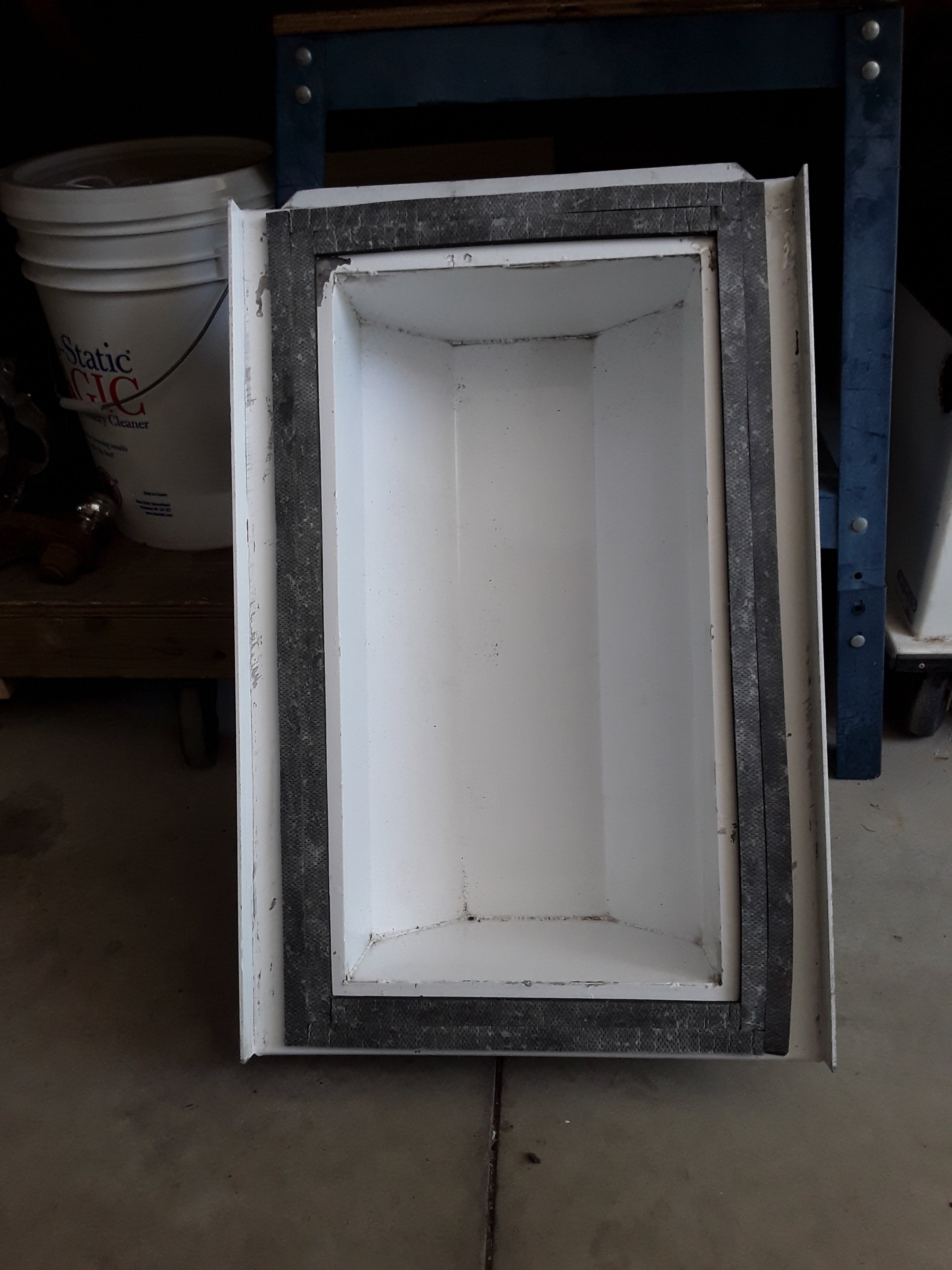

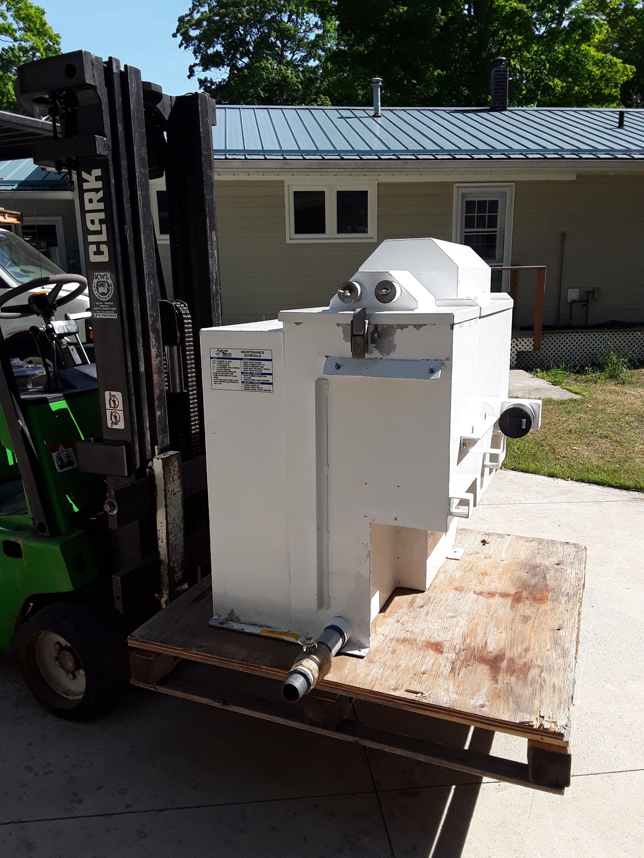

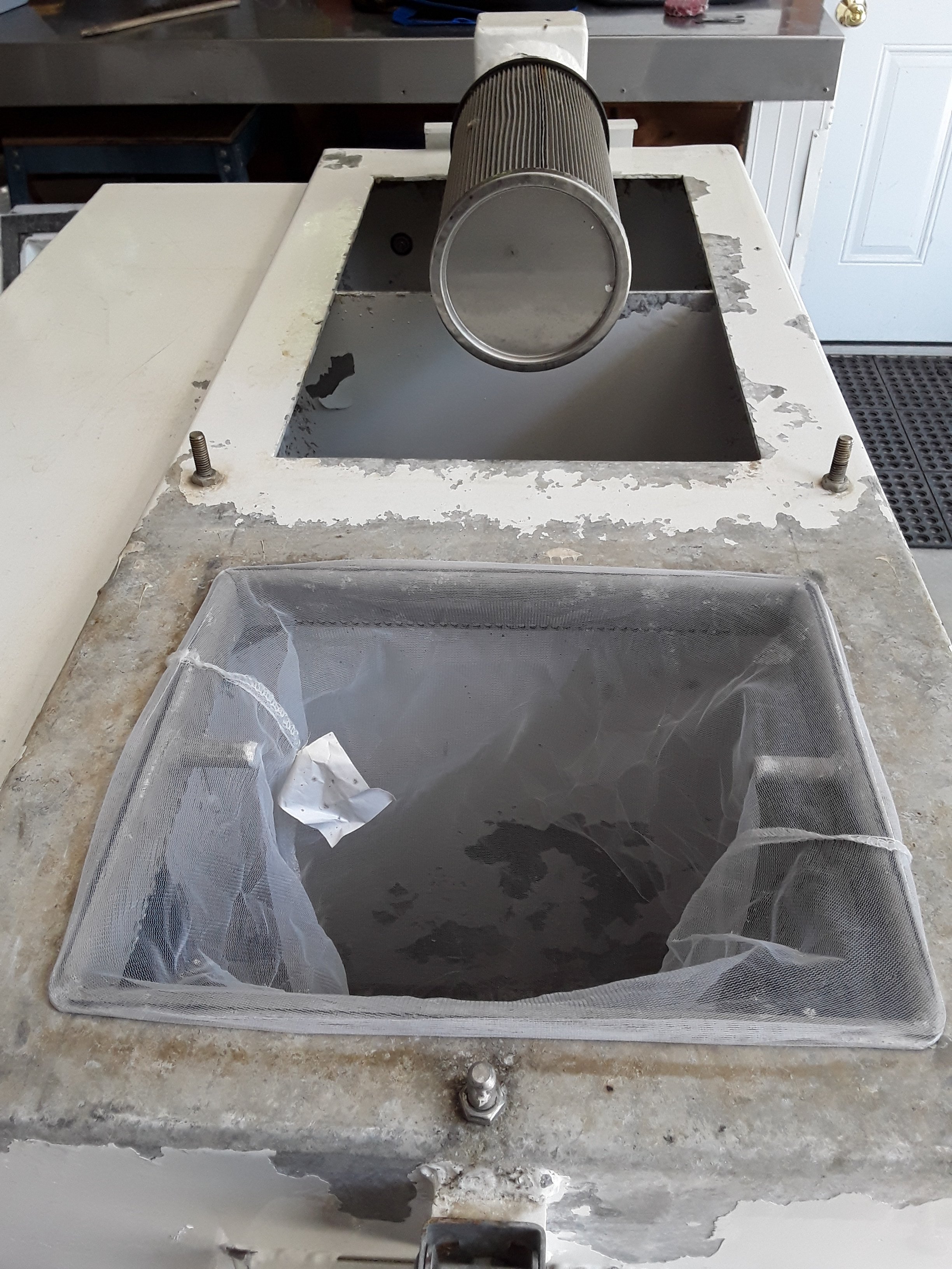

Haha! This is a 210 all day vac tank that came with a unit I purchased. It is being installed into my daily driver to replace the 100 gallon tank presently in my AquaTech.
The modified filter basket with 5 gallon paint strainer bag really turns these tanks into deep breathers! I laid in all new gaskets on lids using premium gasket material used on truck toppers.
I dissected the stock waste basket to accept the paint filters by cutting off the bottom 2/3rds of the aluminium material and taking 1/4" of the top lip off all the way around. Paint filters fit perfectly and are a cinch to change out.
The same mods could probably be done to the Cleanco vac tanks, although I haven'the checked them out closely.

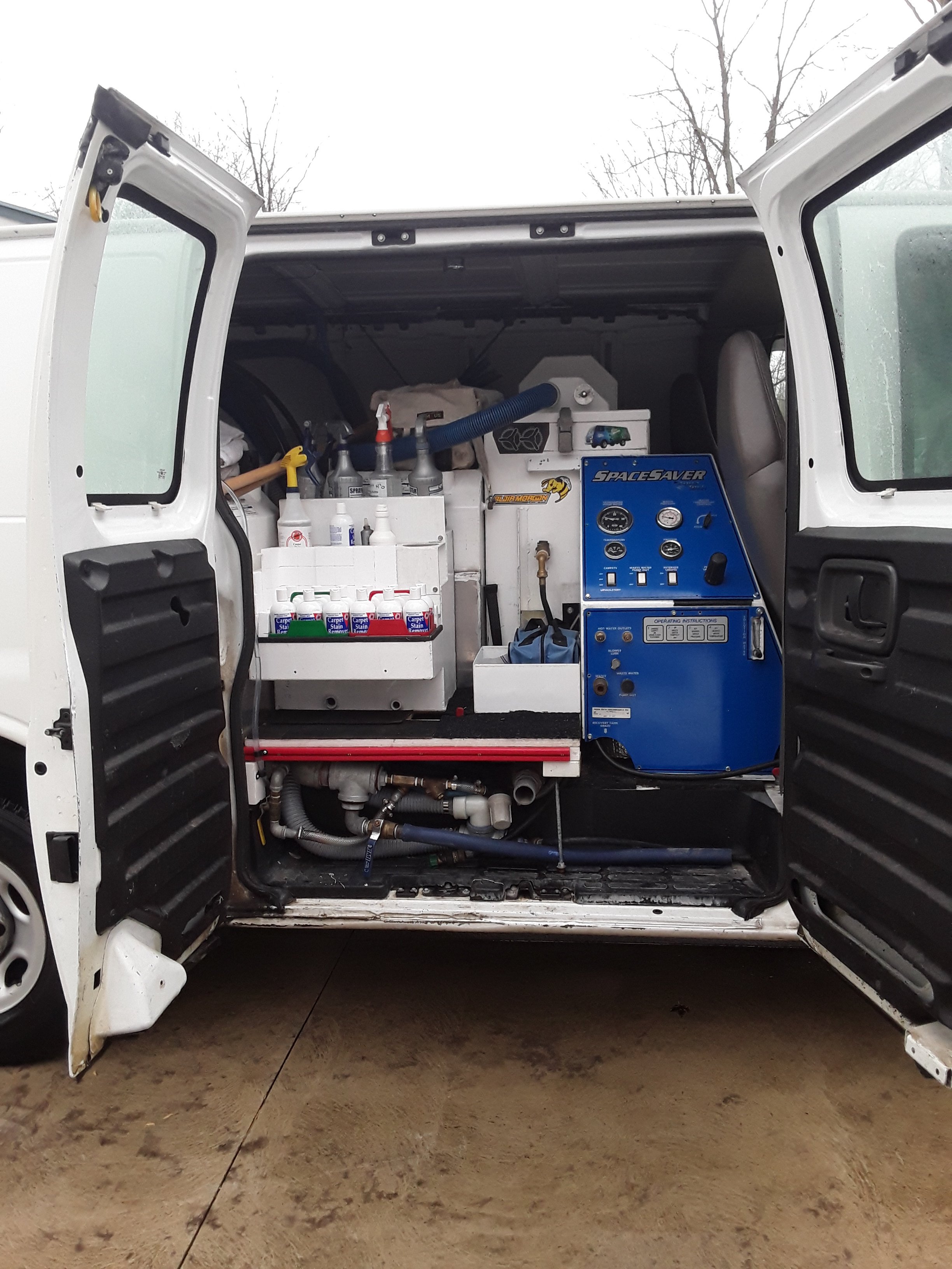

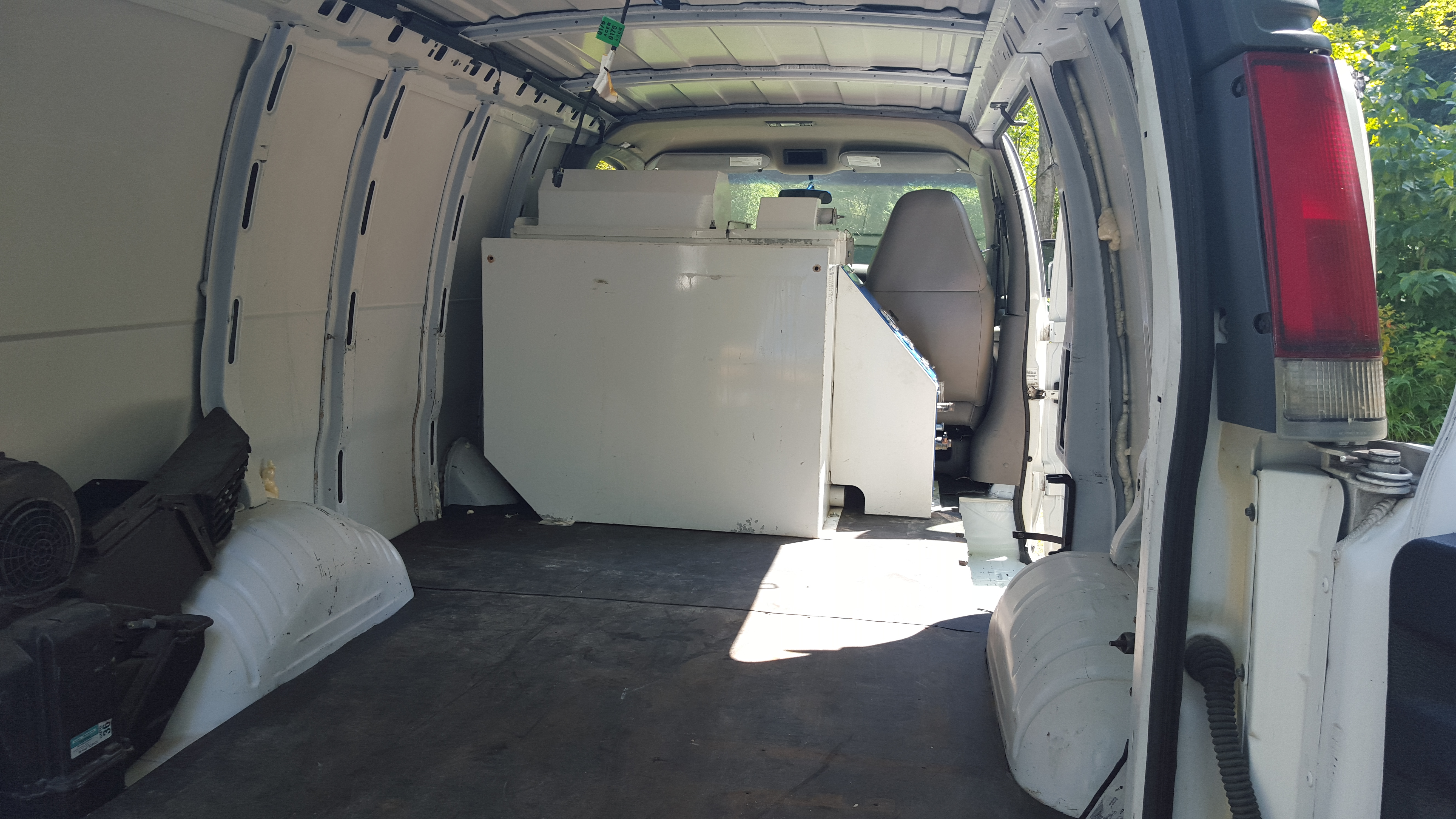

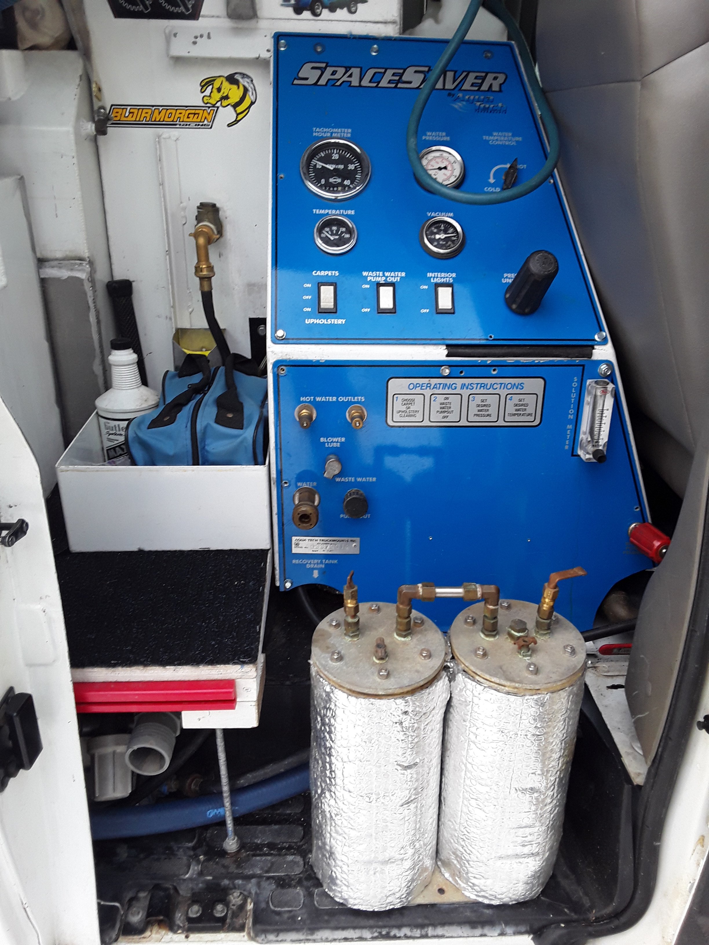

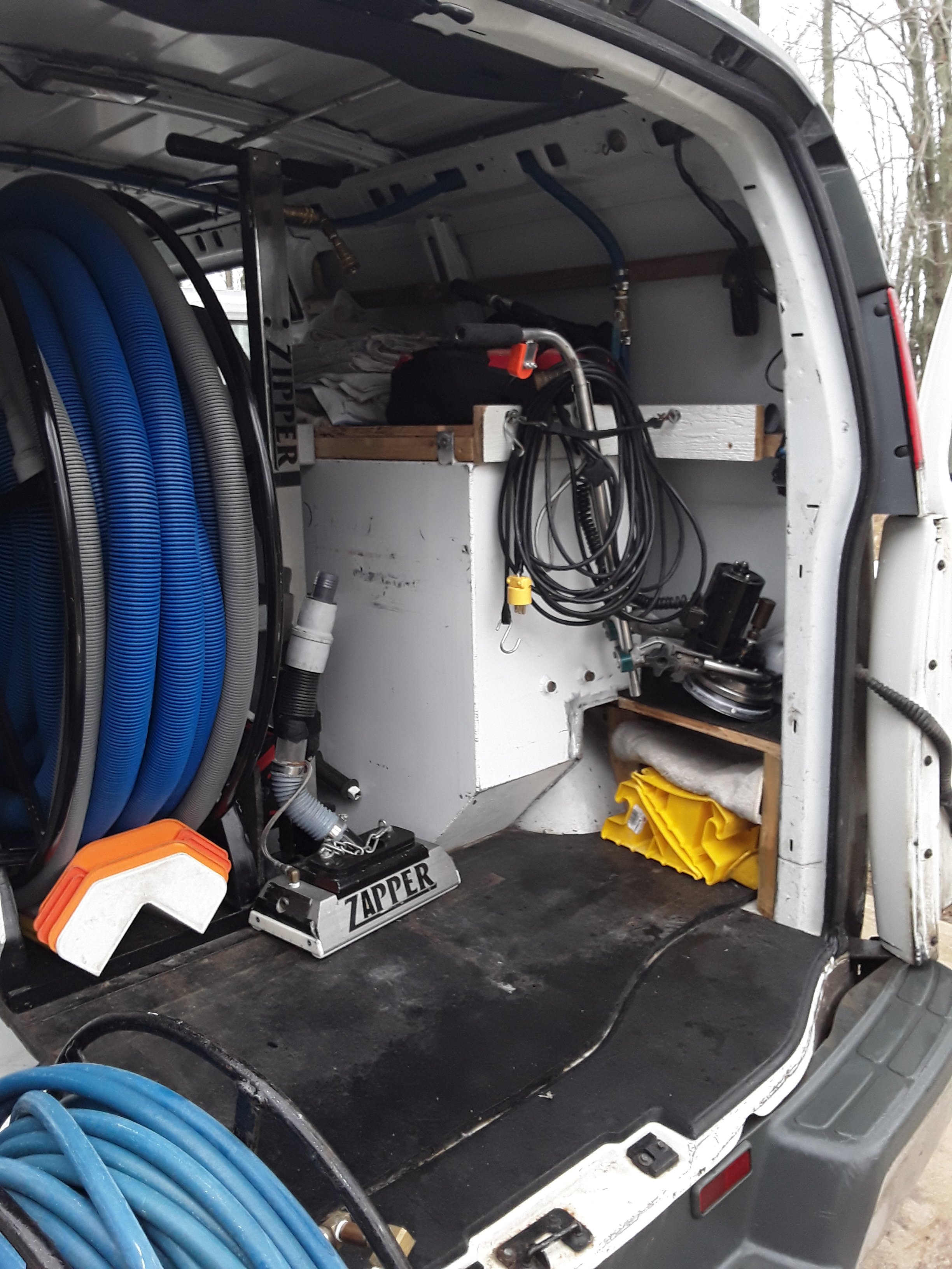

1st place in the almost vintage modified class of AquaTechs for 2018. 2019 version in the works. I am swapping out the 100 gallon waste tank for the 210 all day tank this winter.
Both HP and vac hoses run out of the back doors Bawb. Valves seen below are the waste clean-out and fresh water supply/drain.
The grey hose is for vac tank emptying.
