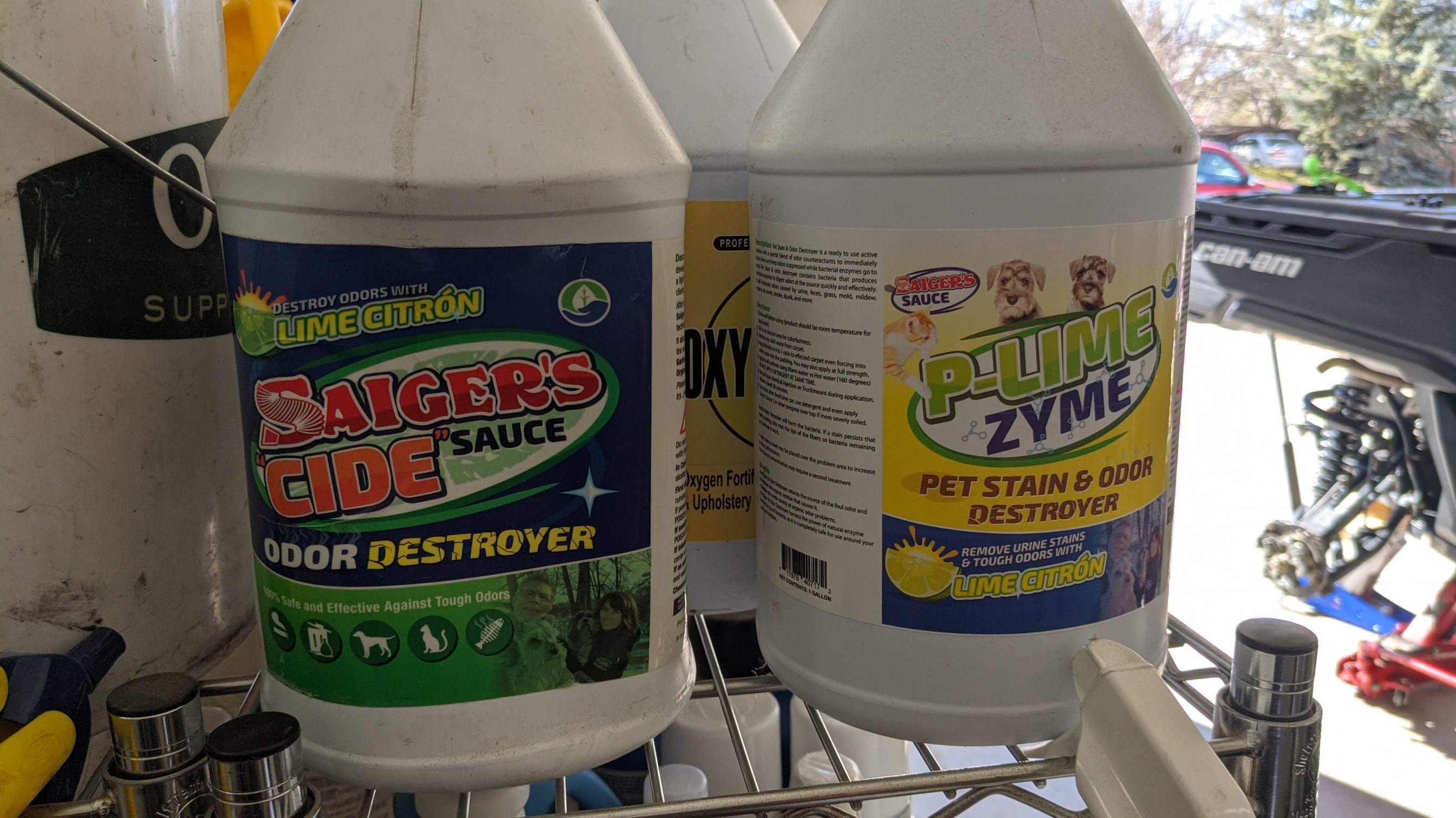

One of my riding buddies Grandma moved into a home that had the local 1980s cleaner "work extra hard" on a few areas but the odor is still strong when you put your nose to the carpet and in the air when the humid out.
The contaminated areas show up lightly under a UV light but I'm sure were much brighter and thicker before Mr trigger spray or do this thing..
I plan on dousing the heck out of it topically, running one if these through a hydroforce and forcing it into the pad and giving it an hour to do its thing
What's your experience with these two products?
27,922
What's your experience with these two products?View attachment 106321

Havent even used the cide because the P-Lyme has taken care of odor every time I'v used it.
14,202
I've changed my original thoughts I had on enzymes to loving P-limeZyme
I just cleaned a house that a lady had several cats and moved out yesterday. I sprayed the cat piss with PZ, let it sit for 20min, HWE full heat @600psi just water rinse and the spot and smell were gone! Best Enzyme urine treatment out there. I know because I tried all the other crap that the soap salesmen promise
When I run out of p-lime-zyme, I put 2 cups of lime-cide in a gallon of 40 vol, spray heavy on affected spots, let dwell 1/2 hr, extract, multiple dry stroke.

To be successful with our Zyme products
Apply at 4 to 1 application (4 parts warm water with one part Zyme of your choice)
DON'T use any other chemistry (It will slow down the bacteria from getting to the organic material to consume organic materials and secrete more enzamatic materials)
TURN your truckmount heat down to 120 to 160 degrees Fahrenheit (warm water helps the bacteria get active quicker. HOT water can kill the bacteria)
PEROXIDE will kill the bacteria enzyme so only mist the carpet tips for a stain that most likely had been caused by homeowners. OdorOxy will work for this.
ALLOW AT LEAST 30 MINUTES dwell time for the bacteria to double to triple (there's 1.5 billion enazamaitc material per OUNCE in P-Lime-Zyme and P-Zyme Eucalyptus Mint)
You will most likely not need another cleaner (even though this is a neutral cleaner) but if you feel you need more punch, prespray over top the Zyme products AFTER your 30 minutes (or more) dwell time.
Clean, extract and can even have our Saiger's Cide products in the prespray after dwell time or post spray an area of concern.
Best wishes and thanks for giving our products a try!
