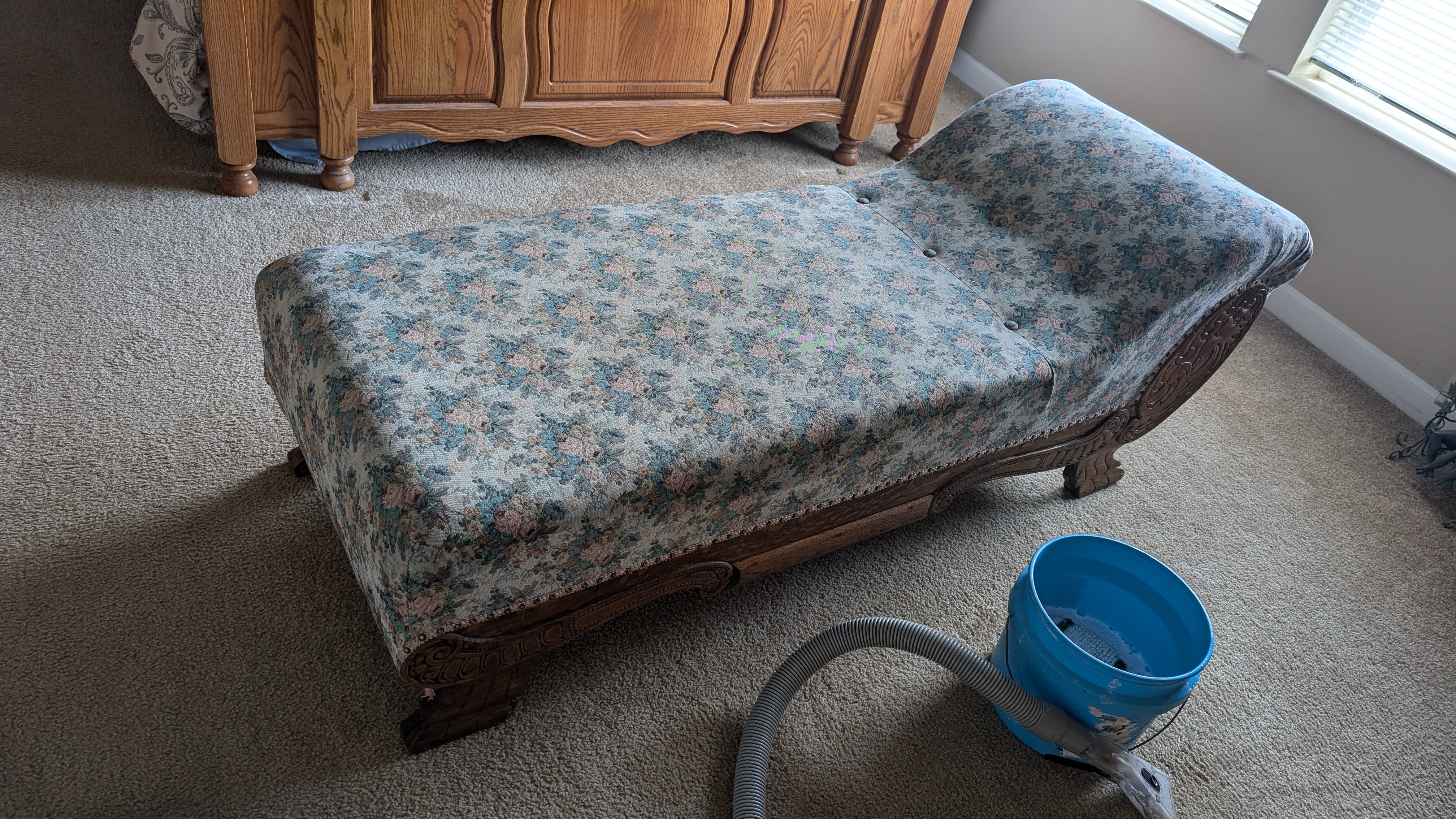

I quoted this lady 480 to clean this "fainting" settee and a few more modern pieces..
Upon arrival some of it turned out to be easier than the photos led me to believe, so I knocked 60 bucks off the price, and I nearly fainted
when she wrote me a check for $500..

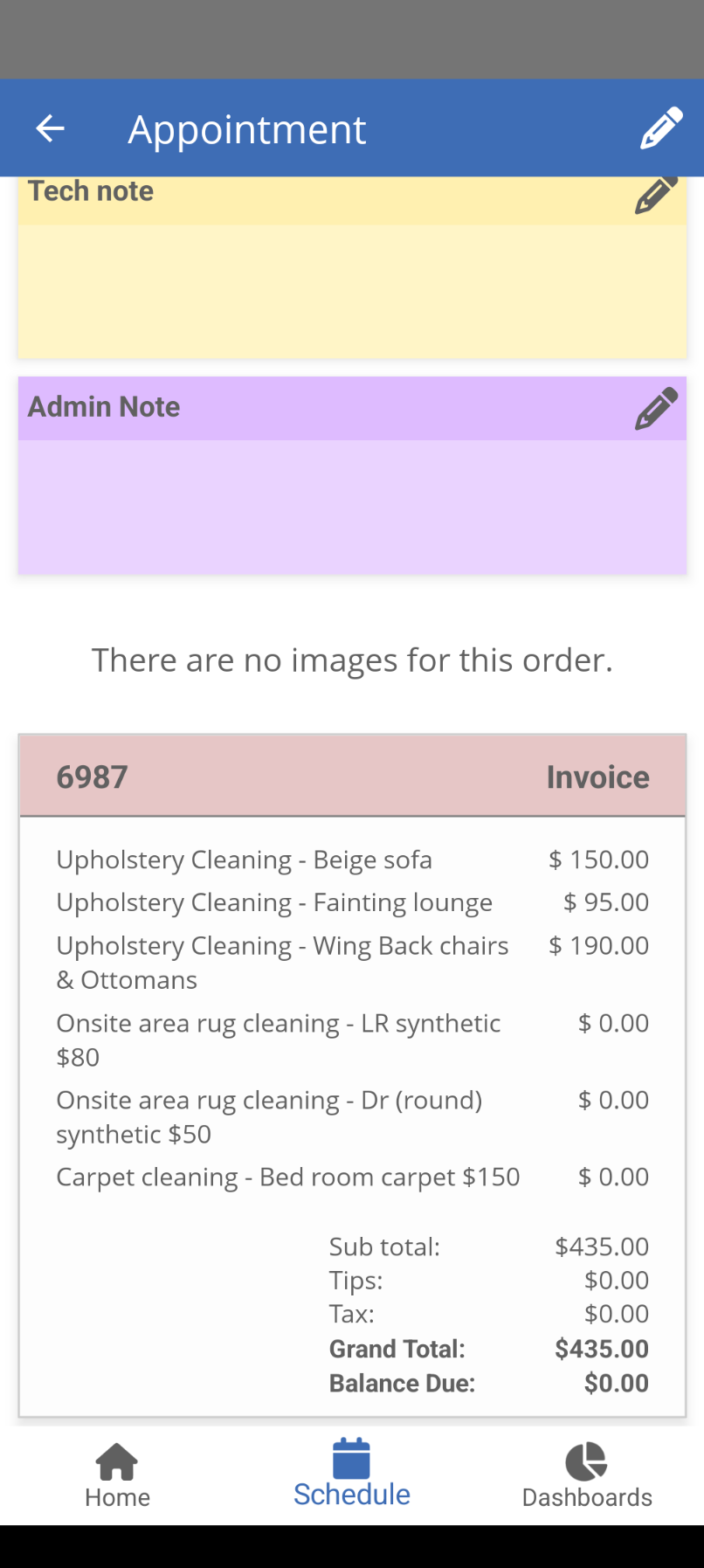

So you charged her 420? Your definitely “high.”
:biggrin:
Damn solution line in that SS upholstery tool ain’t cheep. Raising my upholstery prices after buying one last week! Jon-don suggested I pick up a spare tool so it doesn’t slow me down next time. Just $730.

Im just mad I cleaned a sectional yesterday for $199. Nearest competitor quoted it at $700. Then I see your cleaning a sex chair for $500. I’m starting to think Stanley steamer charges more than I do. lol.
