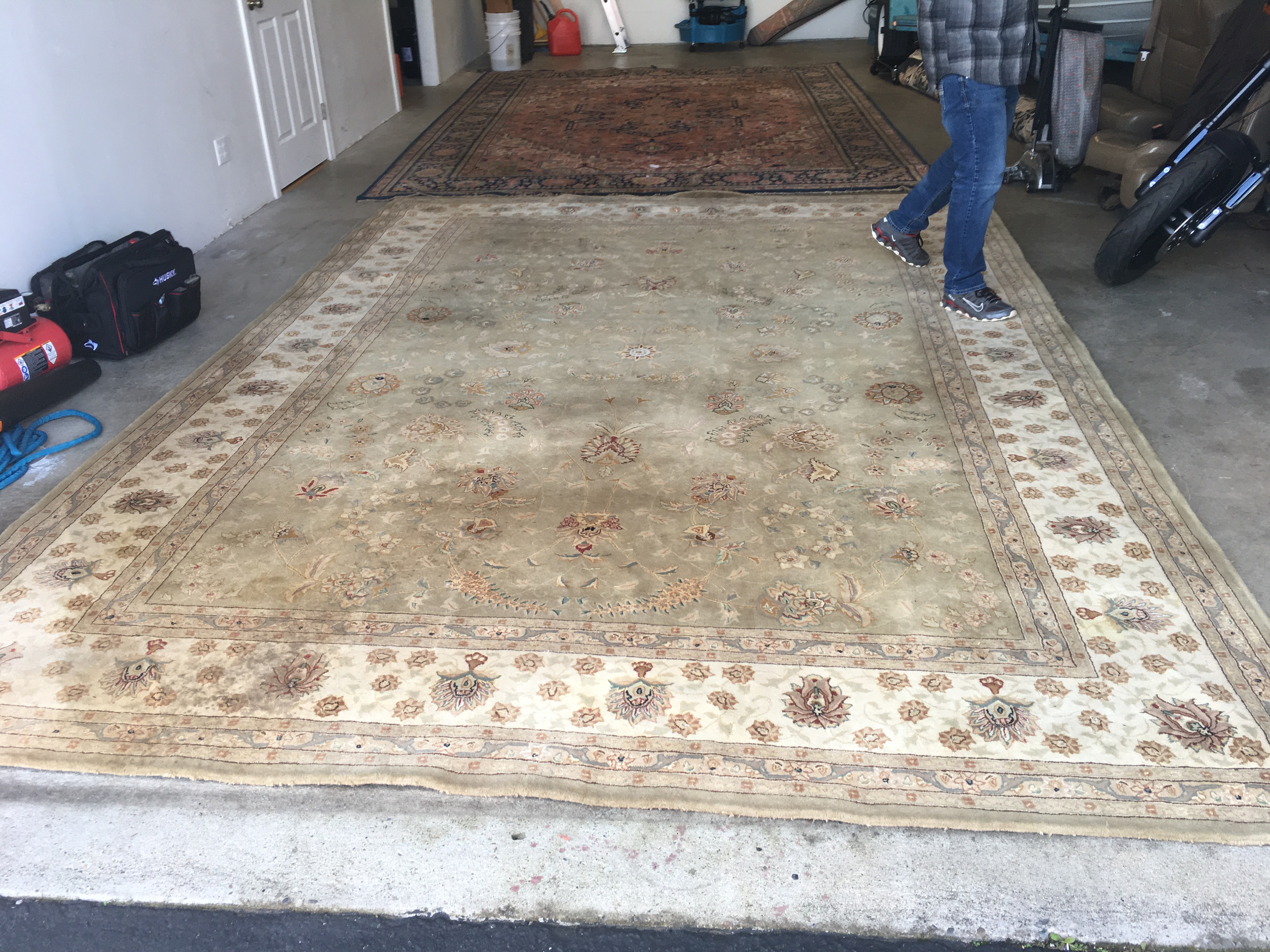

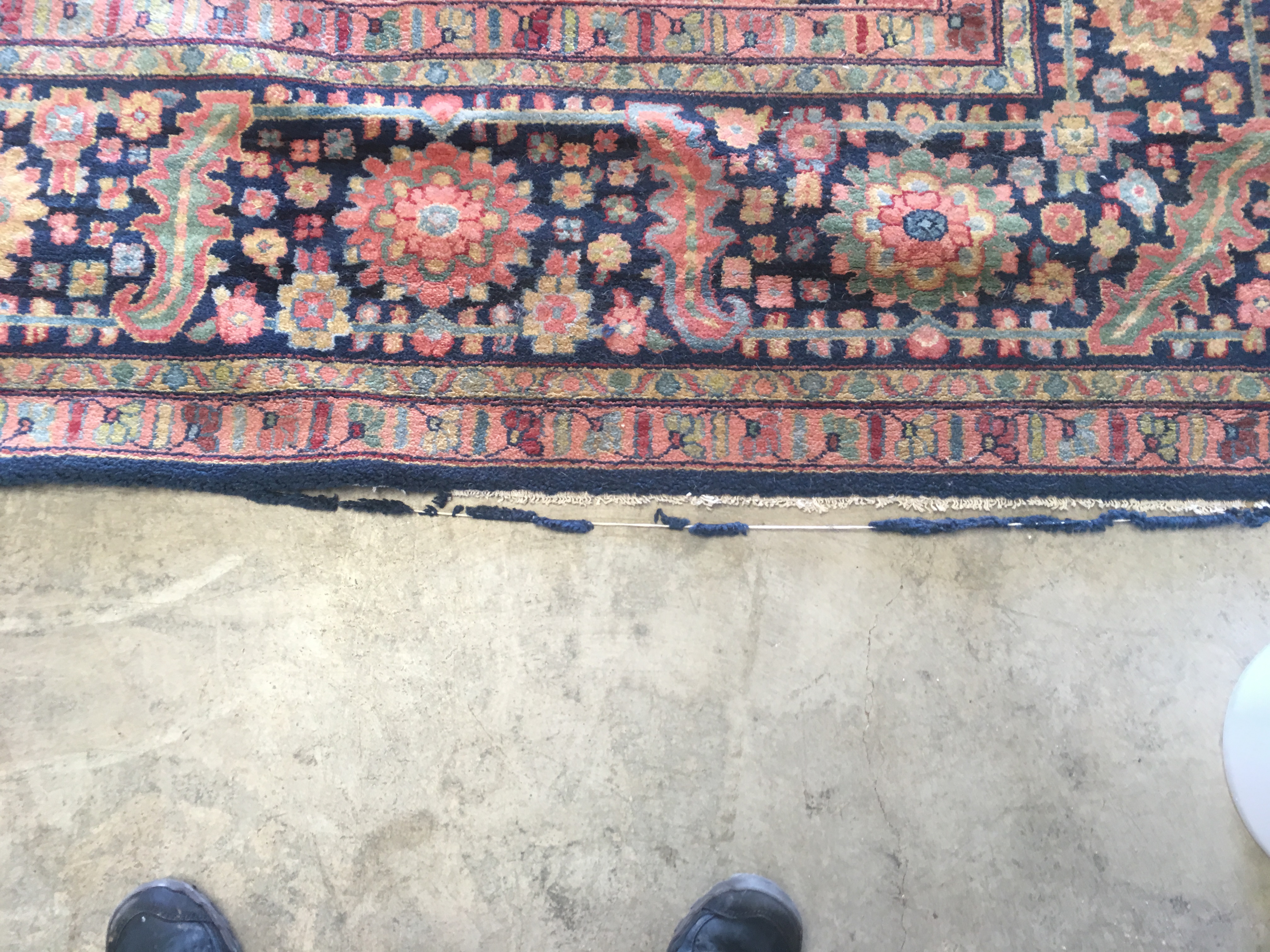

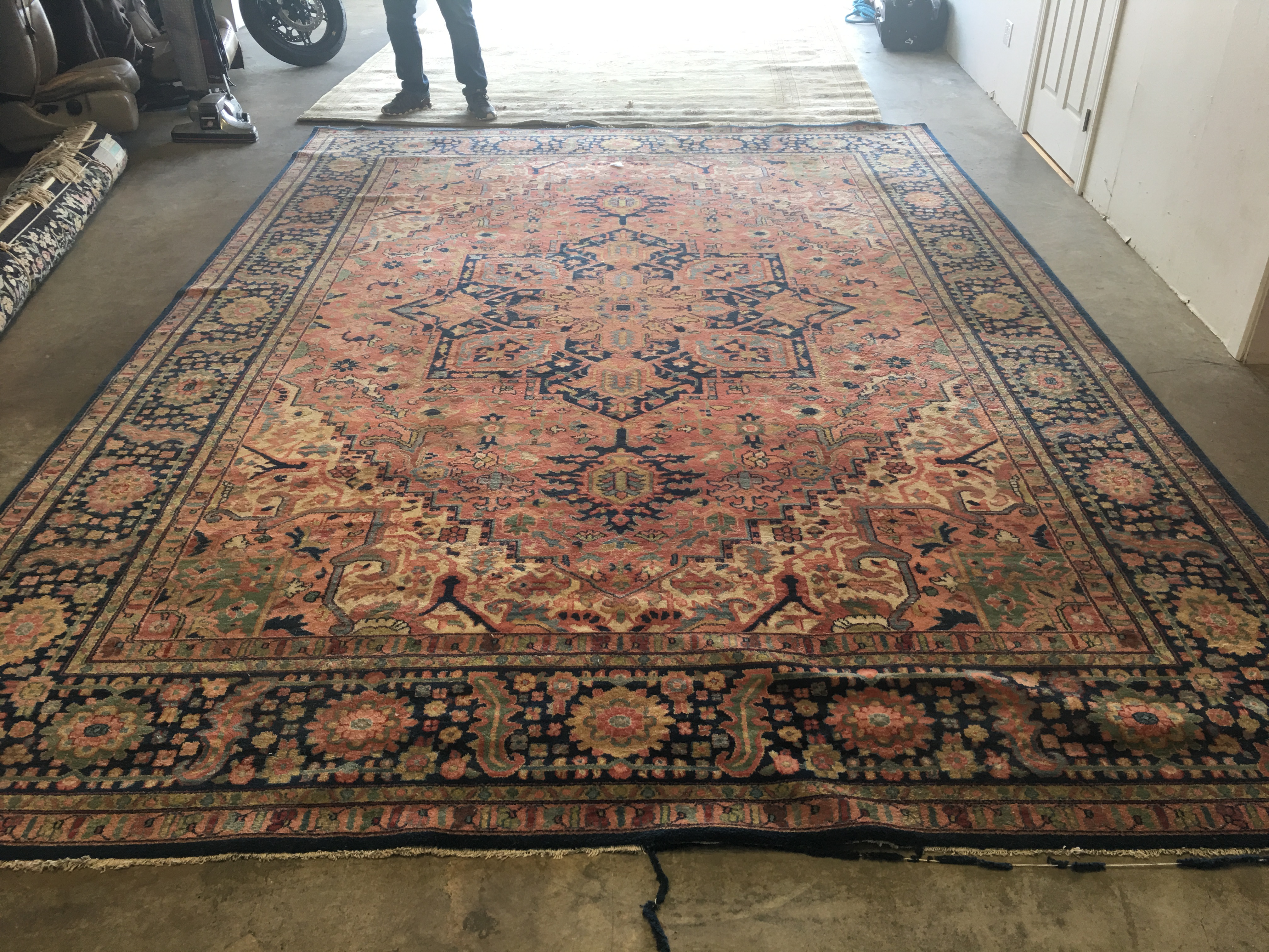

Well, I now have a better appreciation and understanding for the rug plants. I’ve been working on a bunch of 10’x14’ Karastan rugs for over a week. These things were stored in a barn on the dirt floor for years. I finally cleaned the last one this evening and it’s drying in my shop.

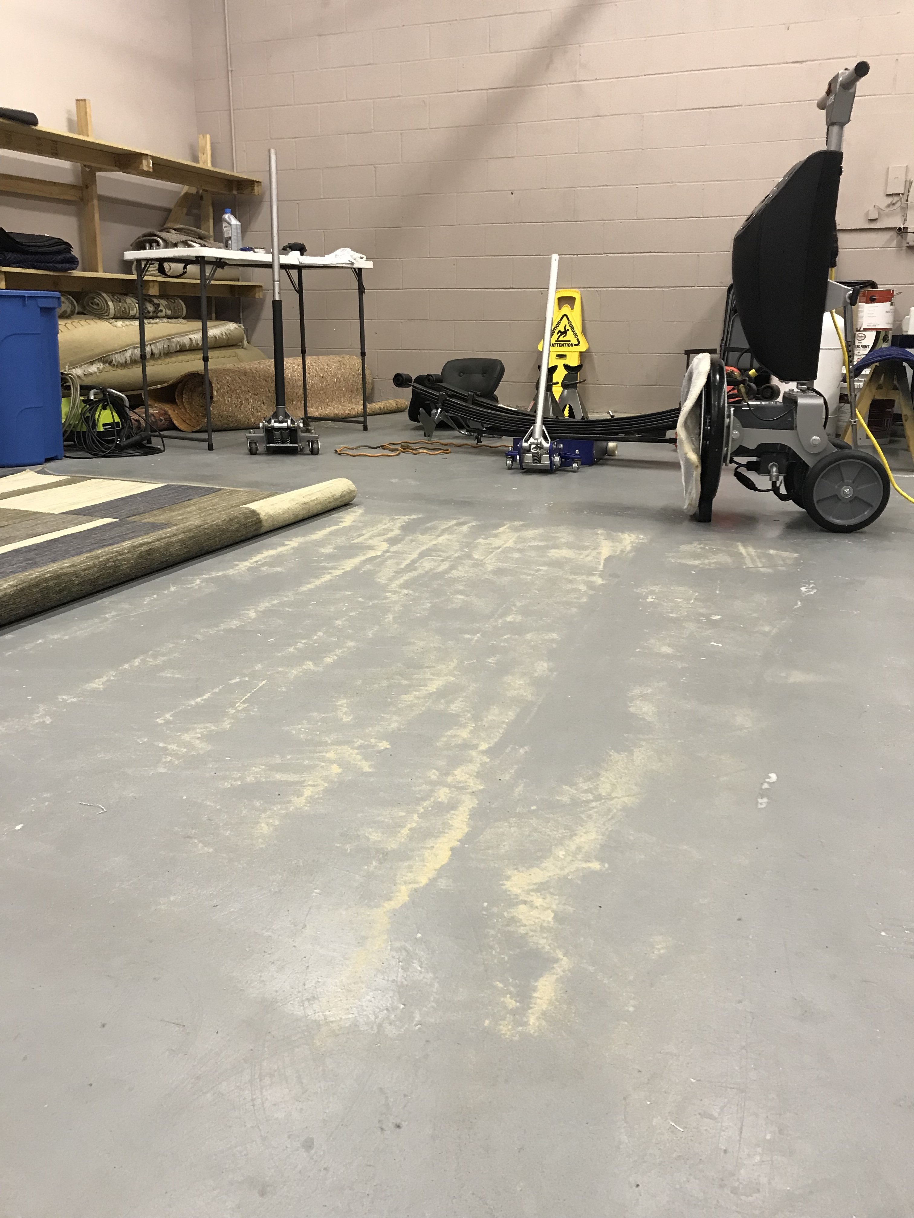

Holy cow did these things give me a run. I knew these rugs were capable of holding a large about of dirt, but apparently I really didn’t know. The about of fine powdery dirt that was removed from vacuuming and beating was totally unbelievable. The amount of time it took to dry these titanic rugs in humid weather was also mind blowing.
I really see the beauty of a tumbler, badger, pit, hanging system, and centrifuge. I’m afraid to put out the money for this equipment. I’m not sire if my area would justify it. We do have one business in town that has the equipment. I wonder how they do.

Make friends with them. Especially if they do repairs. Think about a portable washpit and drying racks. The Zipper makes a good extraction tool. A 175 with shampoo brush and tank really simplifies things.

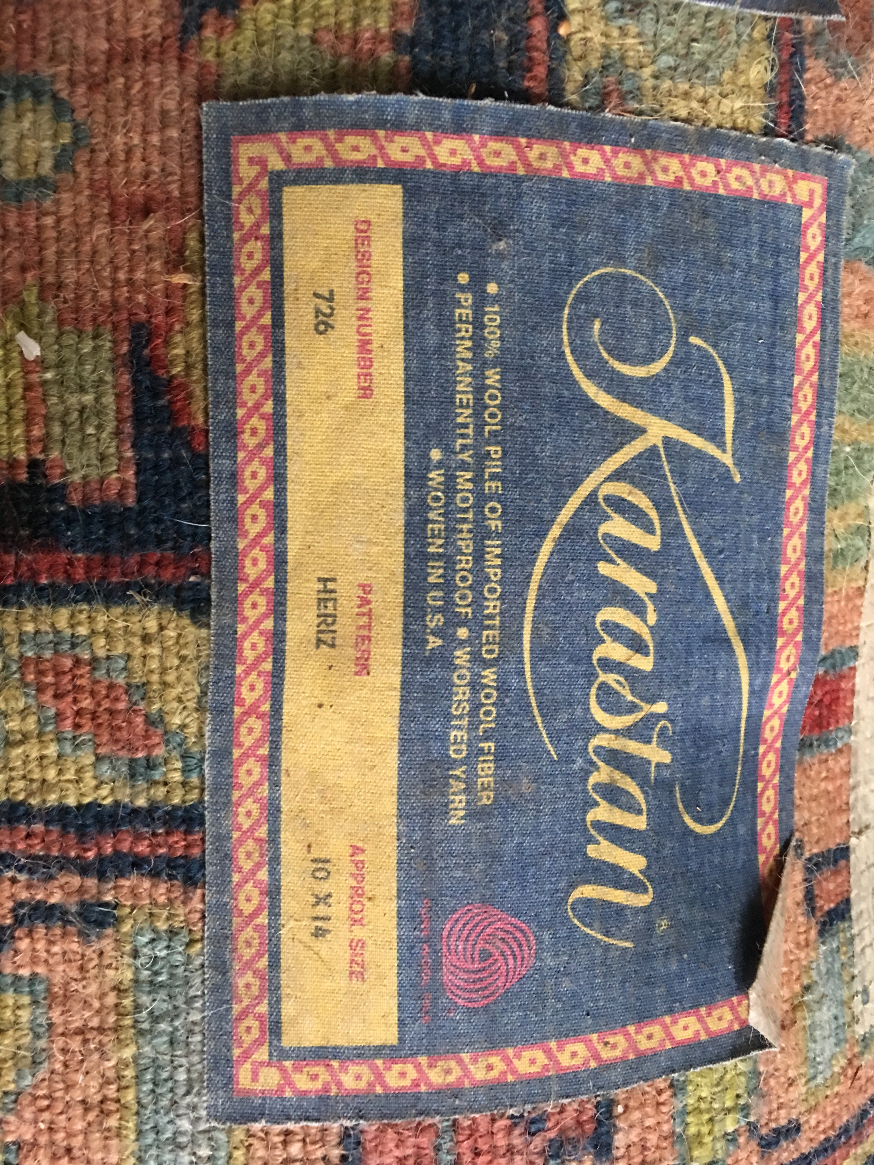

Reading the labels, it says permanently "moth resistant" and on the other it says "moth proof".
  1. Anybody knows what they do to make it such?
  2. And are they really never damaged by moth?
Reactions: Nomad74

Most moth repellents are removed with water so it has to be reapplied after every cleaning (this is both good and bad depending on your point of view). The SDS for one that I got a sample of one time did not meet our profile for safety. Moths will usually not attack wool with regular traffic, vacuuming and sunlight. The problems generally occur under heavy furniture and beds which are not moved, not open areas.
27,867
We do both moth killing and moth repellent. For moth killing, we first vacuum the rug thoroughly then spray a pyrethrin product in a fine oil solution on both the back and face of the rug. Bag it in plastic and leave for 3 days. Vacuum and hand pick the larva carcasses and cocoons out, thoroughly clean the rug. For moth proofing, after we have cleaned the rug, we apply Masterblends Repel product.
