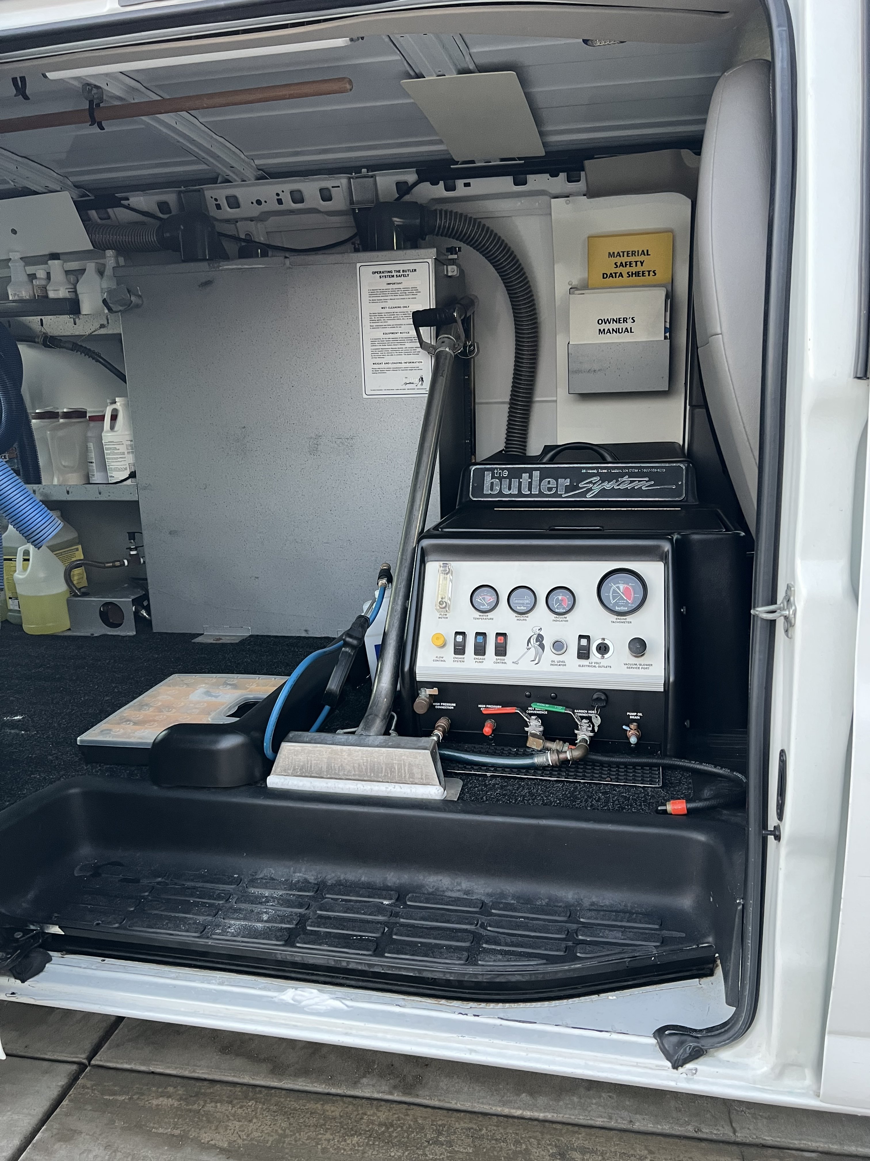

Mikey what wand is this and how much for a hybrid glide
Sorry that’s the only picture I had
