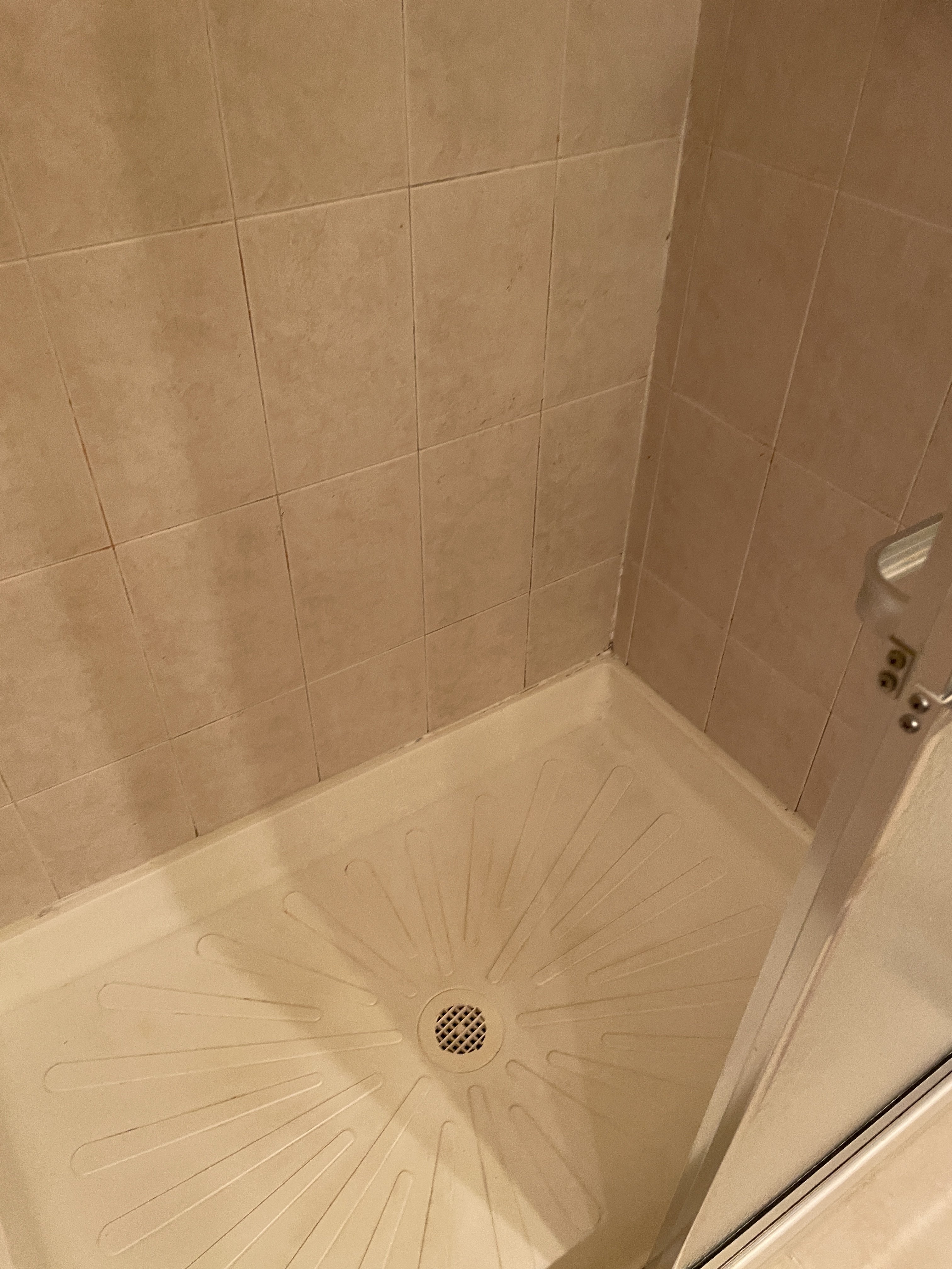

Ive been asked many times if I ''know anyone" that can re caulk showers. This is a nasty old shower that is just that.
So my question is how much $ is in this one? For starters, just the main corner beads. Remove old caulk and apply new.
Im thinking $400 would get my attention if I was slow and doing stupid owner operator things...

Theres a whole chapter about this service in our manual.
My typical job is lined item as such:
Clean walls and floors- $175-$600 range, depending on surface type, soil levels, accessibility amount of soap, scum and hard water deposits and mold issues. Some walk-in showers can take a full day which you'll be charging much more than $600 obviously..
Remove failed grout and/or caulking from floor to wall joints and wall to wall joint as necessary:
$150- $$300
Air movers for 2 days
No charge to $100
Return visit to install color matched RTV silicone or epoxy fortified grout:
$150- $300 plus materials
Additional charges possible for glass cleaning, grout, ceiling fixture, cleaning, drain cleaning, bathroom floors etc
