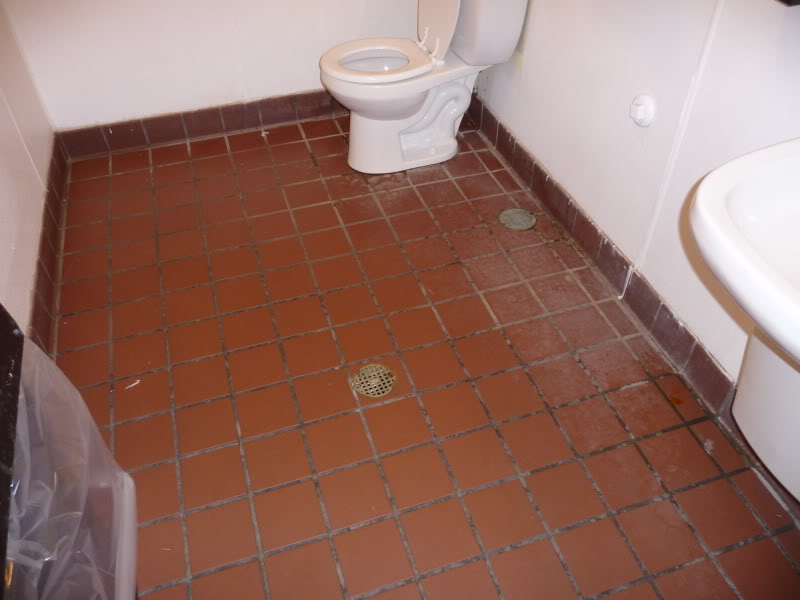

How would you deal with this?
116,250
damion68
Dec 6, 2007
182
Alk, scrub, rinse
Acid scrub, rinse
fill in any missing grout
GP Color Seal
Collect HUGE check.....

damion68 said:
Alk, scrub, rinse
Acid scrub, rinse
GP Color Seal
Maybe add a step with Powerburst or similar product. Not sure color seal would hold up in that environment. Seal with an impregnator and go for a maintenance schedule...quarterly cleaning and sealing?

I'd clean it and collect. Looks like the type of job where they won't want to pay for sealing.

In this market, I'd more than likely walk. No way someone who lets it get like that is gonna pay to restore it.
If they actually would pay...
1. Powermax
2. Viper Renew
3. Color Seal
If I gave the disclaimers and hacked it out...
1. Viper Renew
They can fix the tiles and grout themselves.

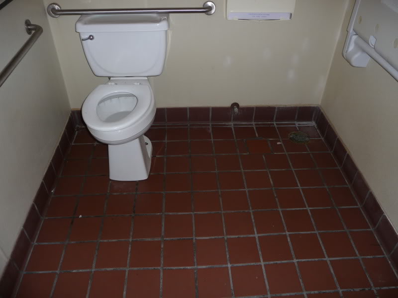

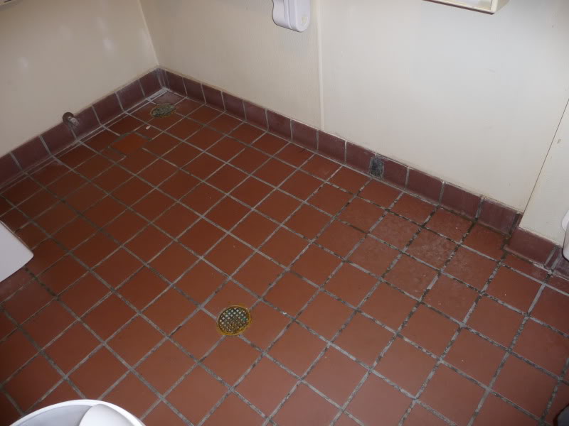

bottom two are from the Gal's bathroom :shock:
I conveniently forgot to call her back with a price today.

it could turn out as an easy job. i would quickly strip it with a low speed with a brush attachment. for stripper get some spartan shineline emulsifier and get some sams club stripper and mix together and strip it. then use some powermax spike it with good helpin of oxyblaster, set the psi to 1100 and blast it with your turbo. should clean up very good. i usually charge 150-200 a bathroom and when they see the result they are very happy even if it is not 100 percent perfect.

FOOK that, WALK
I don't need it that bad, I don't think you do either.

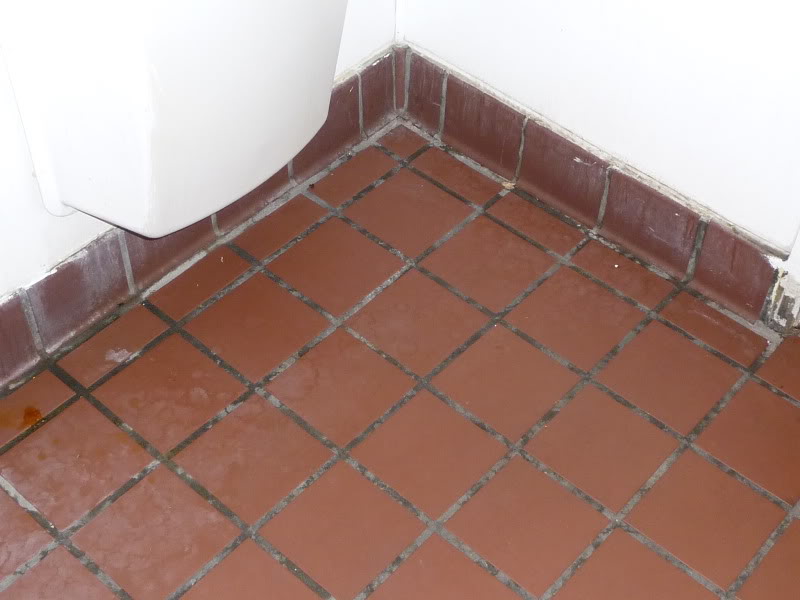

Just incase you do, that dirt and caked on simple green that they have been using will blow out in long lines the shape of the grout lines. Been there and matched a 25 year old install. Another hint, use an acid...Restore from Stonetech, spray it and go grab a smoke break for about 25 mins.
Good luck
Gary T
Oct 8, 2006
491
TxCon Products 4800, 20 min dwell. TOG Easy Etch(if needed) and get the small check as it doesn't look like they care too much therefore won't pay too much.

How big are they? They look about 6X8? I'd do them for $150. Soak them with grime be gone, turbo and leave. I'd do the turbo tilt for the base.. I'd make no promises and let them know that urine leaves stains that won't come up (at that price anyway..) Should take about an hour or under and look 90% or better (which I imagine they would be happy with given the budget.)

$600.00 to do what?? I would do them for $120 if they where no too big. Alk then acid, no seal. they would be happy and it would look allot better. It might take me an hour and half.

Looks like a trucking company we do every 2 months. We just strip them like VCT and put down 4 coats of finish. After 2 weeks every place that they have pissed on will be black. Waste of money in my opinion
