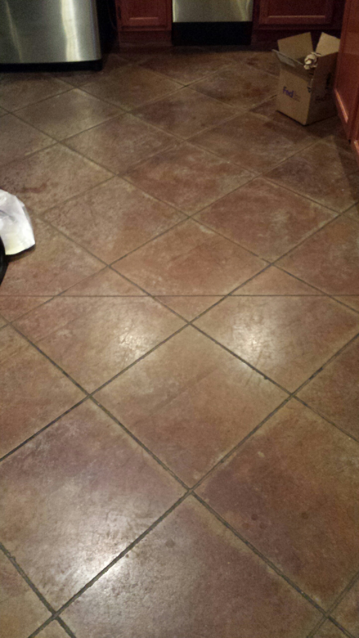

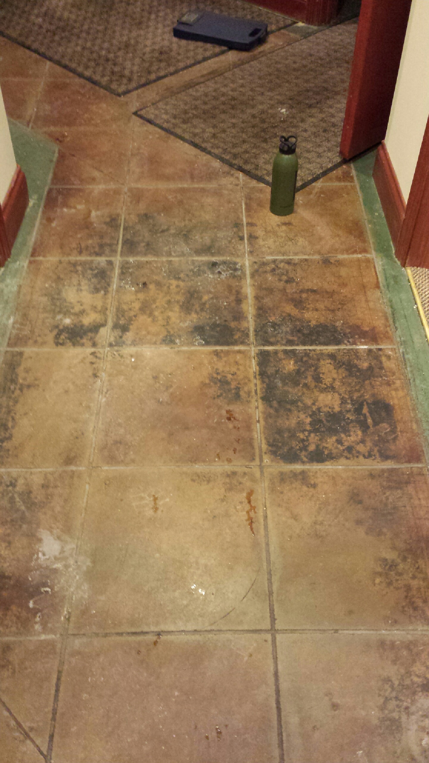

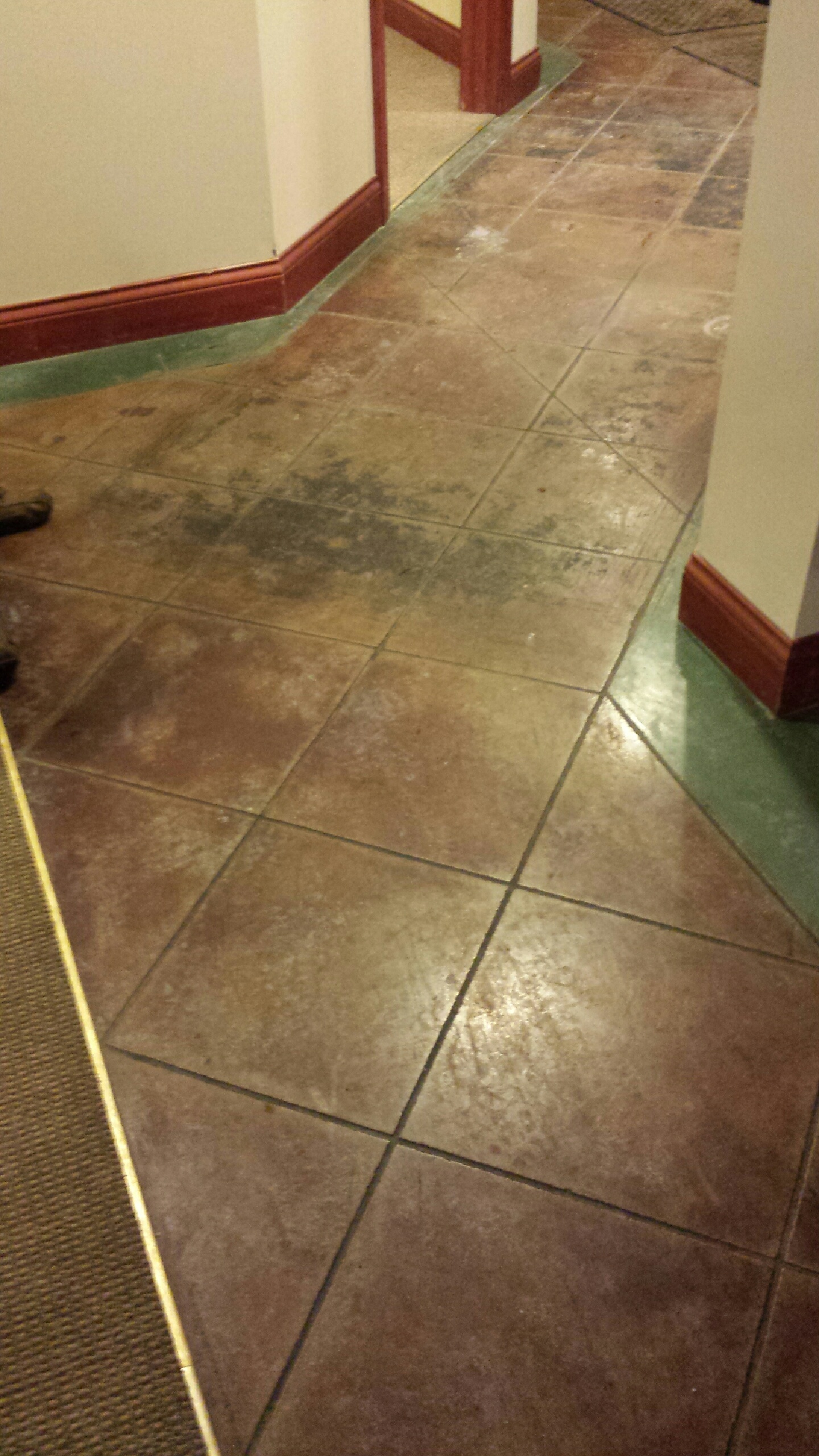

Sooooo, if I can somehow get the black residue(walk off mats, I'm sure. Who knows - maybe the glued them) off this concrete I will have one SUPER happy client! How would you go about this?
I tried some floor stripper and a soft metal brush on a black area, didn't seem like it did anything. I also didn't see any color come off with the stripper. Some type of actual grout in between the cuts.
Would you go straight to solvents for the rubber(black) residue? What kind? Would this affect color? From what I've been told, if the floor has more than one color it's surface dyed.
Anyways, any advice? Other than there screwed....

D'limolene based or boosted pre spray and a black pad/175 would be first try.
A citrus solvent will have D'limolene, right? Will solvents affect color, is color loss an issue on dyed concrete?
it said follow Mikes advice
looks cut with a 3/8 tuck point blade rather than stamped
looks acid stain...no color worries...still check
sealer looks gone
check DC board or contact a manufacturer like LM Scofield for additional recommendations....like sealer after cleaning
idk...I haven't touched concrete since 98?..................and never really sealed uncolored......colored ........solvent from scofield
