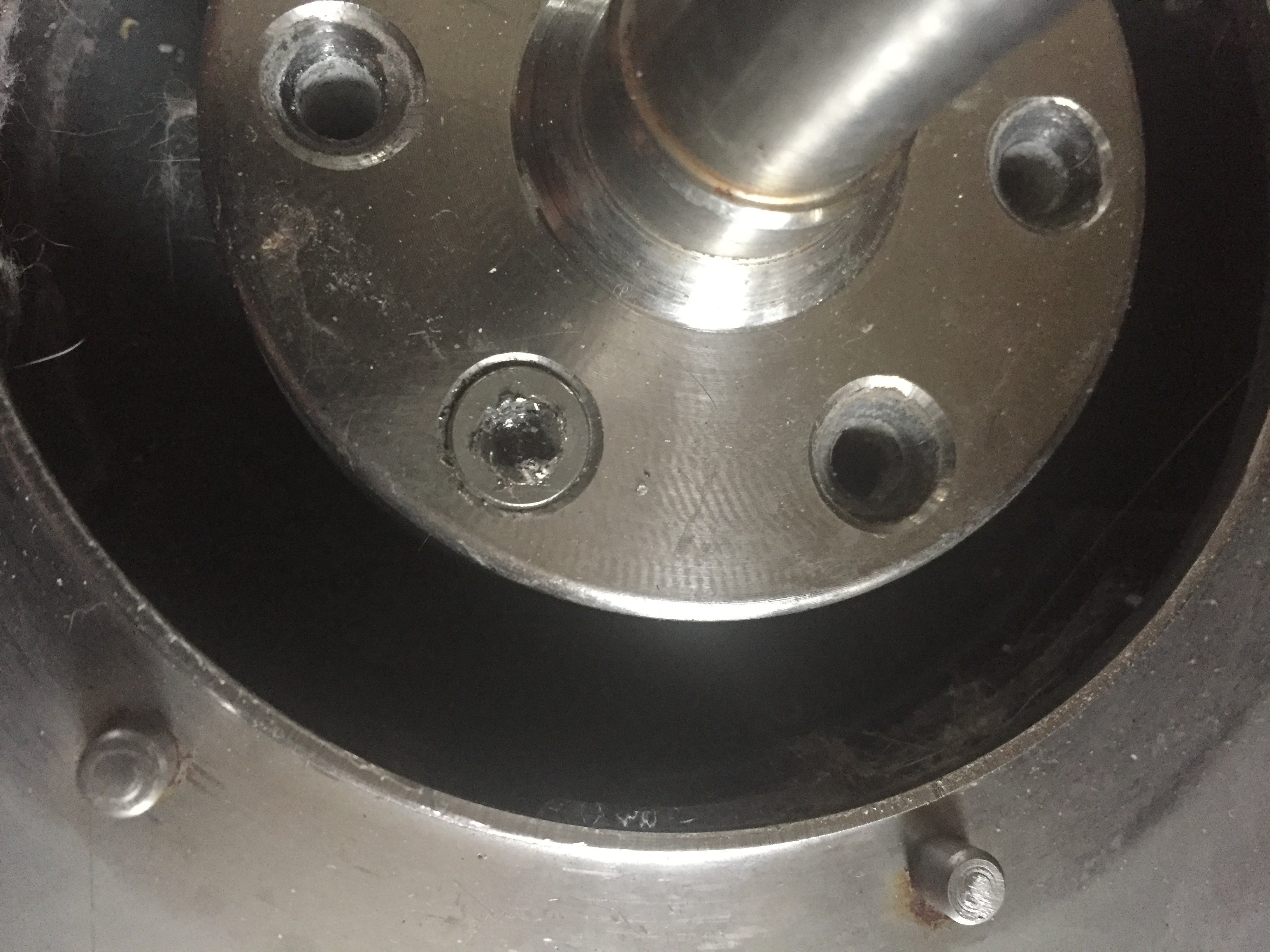

How to back out this screw...?
icleancarpetz
Mar 7, 2015
1,646
19734
Rafael Samson
shaft to the360i.
This screw has been a sunamagun to take out...Any ideas?

Before anything put new screws back in the other holes if you can replace with allen head screws that would be better. Drill a small dia hole on the outside dia of screw head. Use ball peen hammer and a hardened screw driver placed in the
hole to gently tap the screw out. Think of it as taking hammer and screw driver to tap the hand of a clock backwards. Go slow.
This is a kinder gentler "Neuman" method and may work better because there doesn't seen to be much clearance to get an impact drill straight on.
24,126
The extra hard way. Weld a bolt to the stripped head then unscrew as normal.
But what the other guys said. You can get an ez out and or impact driver at harbor freight. When using an EZ-out first drill a small hole into the middle of the stripped head.

By the looks of the threads in the other holes it is likely aluminum. That screw may not come out so drilling may be your only option. Be sure and use anti seize on new screws.

i used to have same issues with challenger op machines. the counter weight assembly screws always boogered up from moisture and chems. drill a hole deep into screw shaft and use small easy out. start small diam first so you have room too work with it it fails.
once you get used too using easy outs only takes couple minutes use some wd40 while drilling

Above suggestions are good. Sometimes it helps to put a torch on it. A couple times I've drilled out a small hole in the reamed out bolt head and driven an allen wrench into it, one that was just a little too big for the hole, then grabbed the right angle with the vice grips and cranked her out.

Do NOT heat the bolt itsef....as that will expand the bolt making it harder to back out....heat the surrounding area slightly and the bolt will come out way easier

Update:
Used a Grabit damaged screw bit. Sprayed liquid wrench on the screw. Waited anfew minutes. Slowly drilled the head, flipped the bit, slowly reversed it out. Took a few trys. Got’r done.
Thank you everyone for your suggestions.87015
