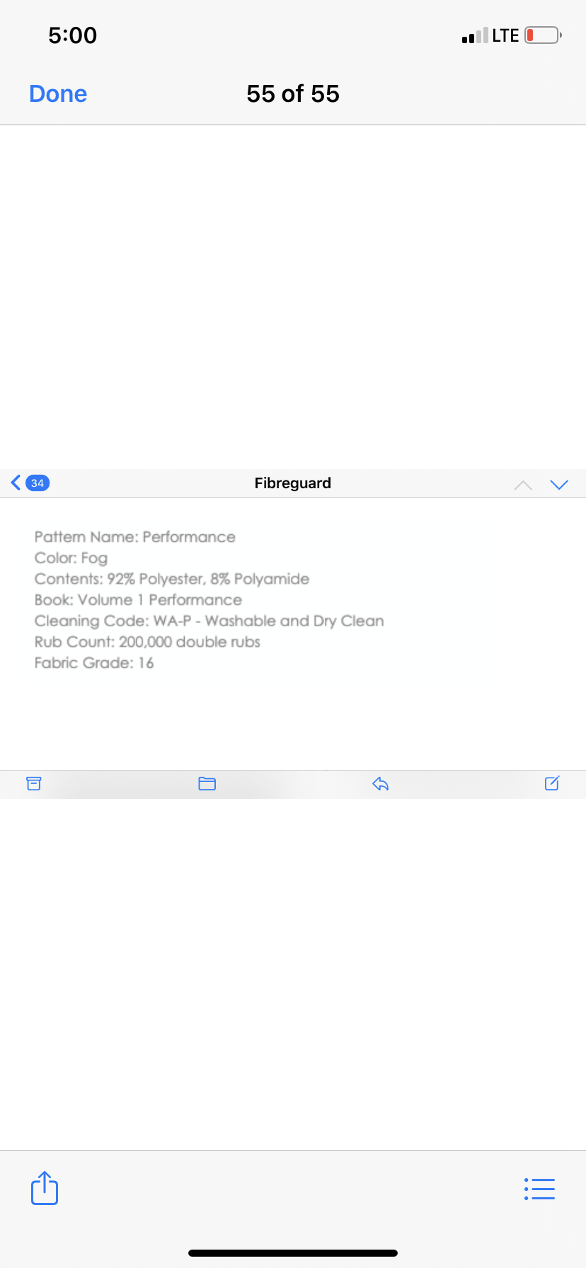

Even after taking @Jim Pemberton course, I’m still baffled sometimes when it comes to labels...
Case in point, a new customer sent us this....
I’ve never come across the label, I know I need to test, I know to be cautious and careful....
But why did this come through as the label?

Three recommendations:
1. Don't trust labels
2. Don't trust labels
3. Don't trust labels
The fiber contents listed are what the upholstery is filled with underneath the fabric you are cleaning.
The cleaning recommendations are less than useless. Washable (wet cleanable) and Dry Clean mean you can do anything to it....but if you ruin it, its still your fault.
Test for fiber family, test for color stability.

Whats the problem? Its a shitty poly

Thank you Jim. I’m going to be there Tuesday.
