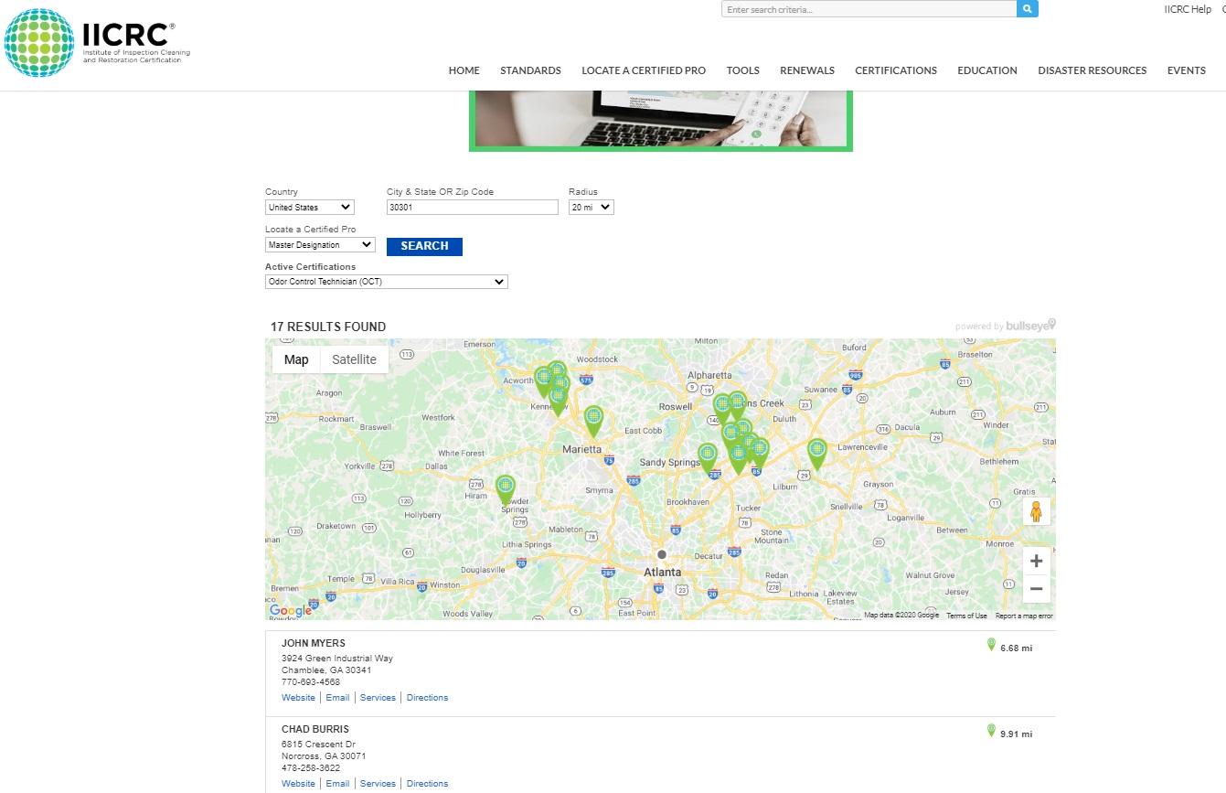

13.4.7 Odor Concerns
When odors are detected, it is recommended that cleaners inform customers of a problem, and what remedies are available. Deodorization specialists should be consulted if odors persist after normal cleaning.
Odors can occur from sources other than bodily discharges (e.g., hair, dander, and body oils from dogs and cats). Elevated heat and humidity created from the cleaning process can amplify odors, so they are more evident during and after cleaning and during warm, humid conditions. The cleaner should educate the customer that odors can be perceived to be coming from the carpet can actually also be present in other absorbent items in the home such as furniture, baseboards, dry wall, window coverings, bedding as well as the HVAC system.
