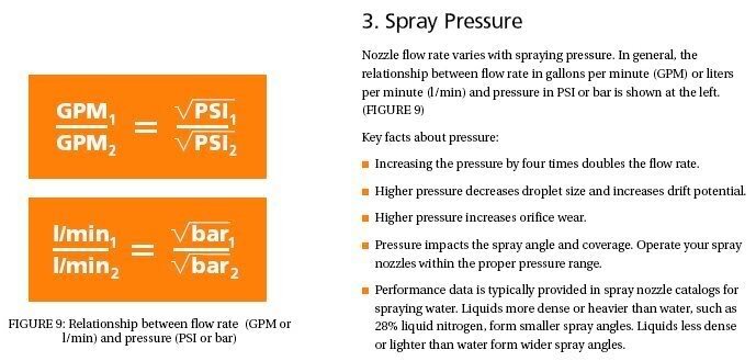

Eric Valentine
Four times the pressure will double the flow.
This was taken from the teejet website's users guide to spray nozzles
