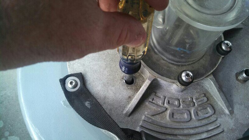

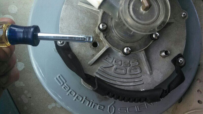

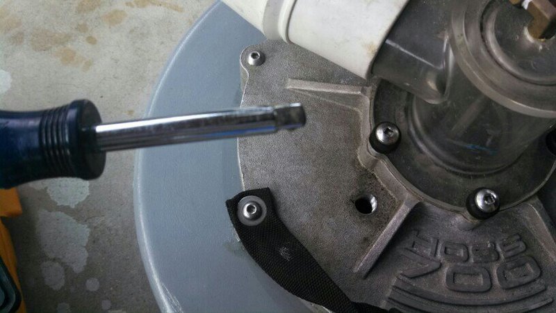

If I did this with my hoss, I would have a mess on my hands. I am constantly wiping fluid off the deck. Is there a gasket in there or suppossed to be a gasket in there?

I will take a closer look at it when the sun comes up but I don't think there is one in there.......(?)...
Have you tried snugging them up a bit.........

I looked at both of mine and it looks like there is some type of sealant between the metals........
How bad does it leak when you are using it.....
I would be more concerned about sooner or later running out of oil and locking the thing up....should be easy enough to separate and re-seal.......

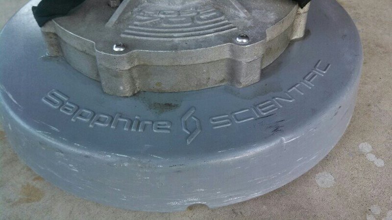

I just checked it and it was too low on gear oil. Put almost half a quart in it.
We only use it a couple times a week. I wipe almost every time I use it. I just topped it off about 2 months ago. I didn't realize it was leaking this much. Obviously getting worse to lose that much that quick.
