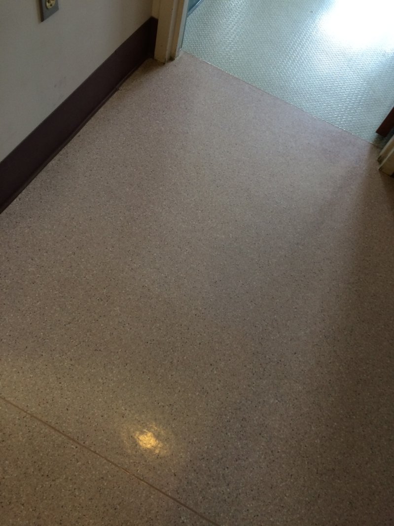

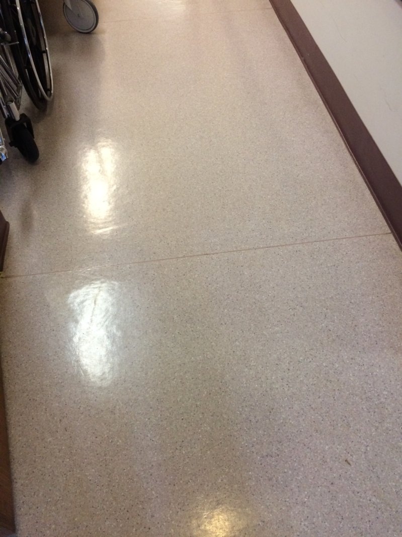

I have a company that I do work for that has several medical facilities that they take care of. I am currently cleaning all the carpet and furniture in these facilities once per year. They have been after me the last few years to give them a price on stripping and waxing all their floors as well. I went today to see what all they had. The first building has a hallway that is aproxamately 1000sf and then a bunch of medical and exam rooms that total another 3400sf. This would need to be done over 2 weekends as they do half at a time. The next building has a suite on the first floor thats roughly 900sf of hallways, bathrooms and exam rooms along with one on the 2nd floor that aprox 1600sf of the same. This would all get done on 1 weekend. The last facility is 950sf of exam rooms and bathrooms. The only specifications they have given me is that it needs to be stripped and 5 coats of wax applied.
What would you charge for this type of job? What type of stripper and wax would you use? What type of equipment would you use as well? Any info is appreciated. Heres a couple of pics of 1 of the floors.

That's actually sheet vinyl with welded seams... I believe in 6' widths... Some expensive stuff over actual VCT...

Looks like the armstrong vinyl. Pretty sure you cant use black/brown pad but check their website to verify.
Medical exam rooms are pretty tedious with moving all that furniture. I would suggest going higher rather than lower, .70 or higher.

Some of the tile is actually vct but I wanted to show you guys pics of that because Ive never done anything like that. All the exam rooms will be empty although they are smaller with more edges.
