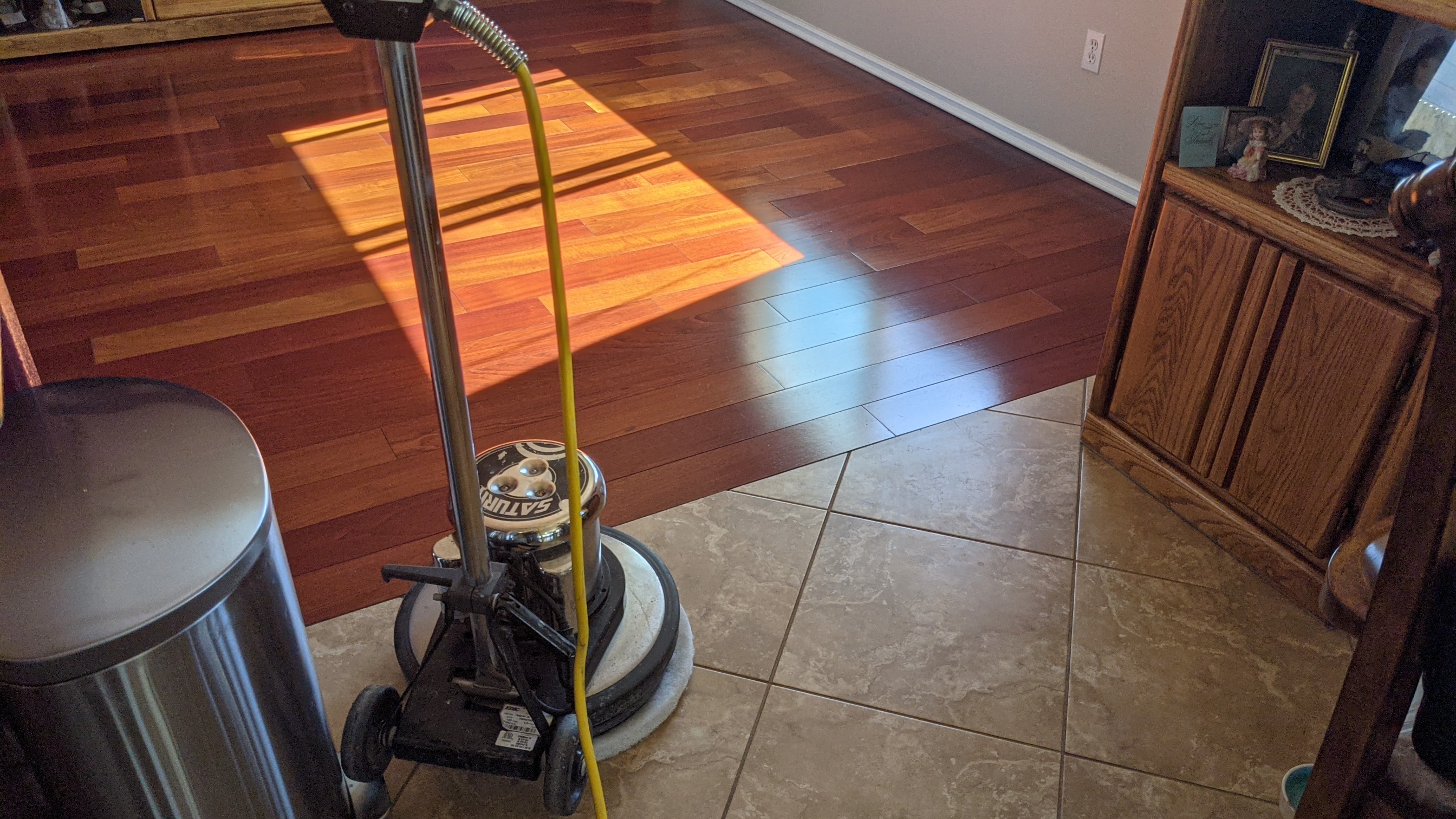

I get to remove one thin coat of Bona topical off a solid plank floor today, is it ever this easy?

No , but possibly if it’s actually only one coat, u can keep solution spread around so it doesn’t dry in spots and u rinse it quickly. It’s possible 🤣

Used a square scrubber with SPP pads. Just vacuumed up the wax. Noisy and dusty mess but no stripper.

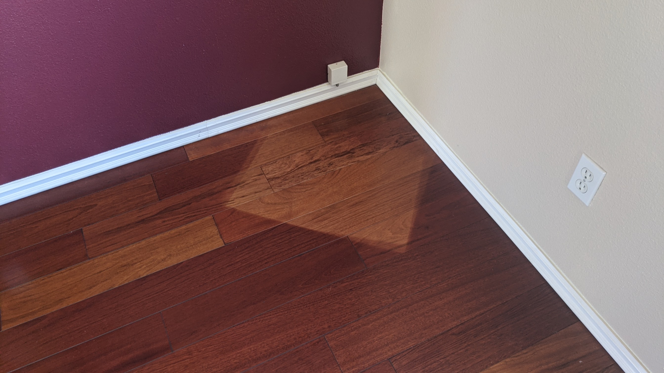

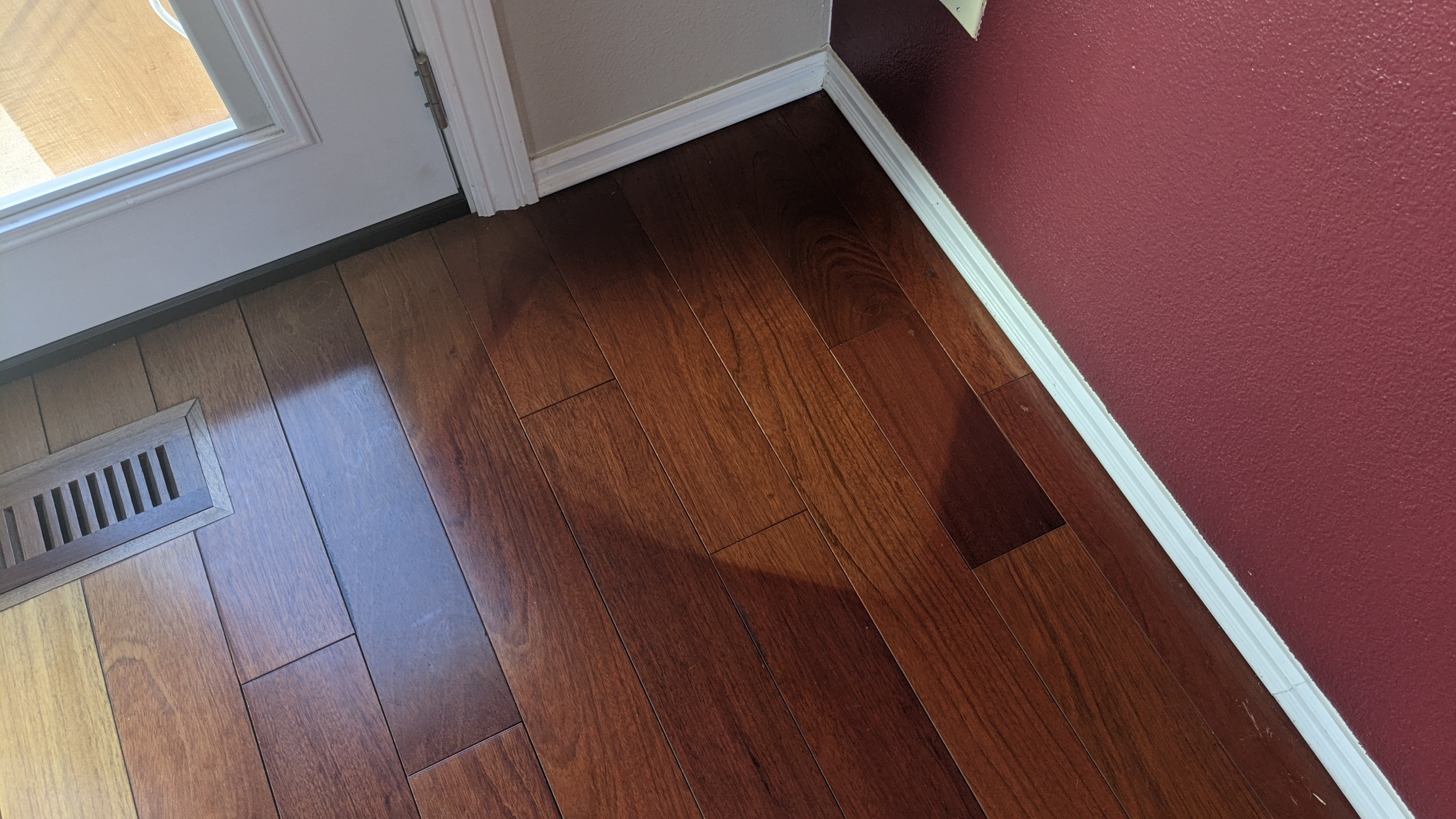

Reverse fade, it happens
Oh, so you didn't try to fix it. You made it look like you had a secret miracle to fix that fade.
That floor didn't look that bad. I'm trying to find areas that showed somewhere where your services were needed. I see some lighter colored lines in between the planks. Was that where the wax was showing? Otherwise, it looks like you didn't do anything

The Bona finish layer wouldn't show up in pics...
