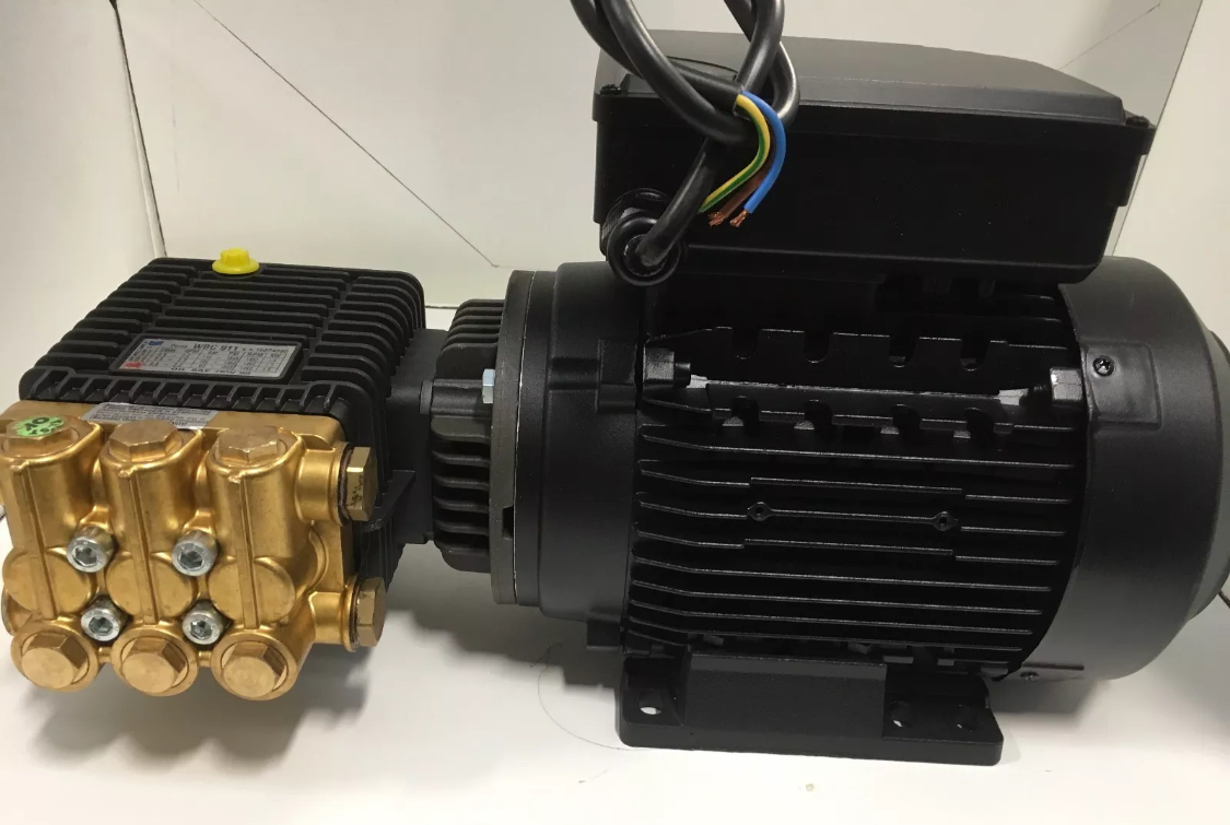

After 3 attempts to buy a couple of pumps and motors off eBay, I gave up. Bargains unlimited insisted I had to go through global shipping. I had eBay walk me through the whole process and it still was refused. I tried a place in Colorado, a place in Georgia and directly through pumptec. A waste of time, no stock, no answer to a phone call and just frustration. One guy had a pump and motor locally but at 1200 bucks it wasn't going to happen. So I ended up calling kleenrite. I got 2 cat pumps for a little more than the cost of one pumptec. They stuck them on ups for over night and life is good. I diff my toque to the folks there for awesome service and caring about their new and loyal customer.

Those generals kick ass. The amp draw is a little more than I like but they last forever and give great flow. I ended up getting cat 1xp so I don't have the pain of trying to get the pumptec here. The cost of the cats was a little more than half of the pumptec and they were available right away with better distribution and no bullshit trying to get them here.
