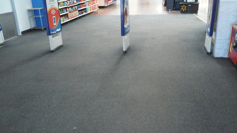

Has anyone ever cleaned the entrances at a Walmart?

Regarding wicking
Looking at it today may not be helpful... I think it will reveal itself in about 6-7 days.
I would assume today it will still be wet. (even if it's dry to the touch on the top)
If it is a rubber backing type....I guarantee you it's still wet.
How can a carpet wick if the top of the fibers are dry? I've been under the impression that if you can completely dry the upper portion of carpet fibers using adequate dry passes, air movers, etc... than the moisture remaining below that level will evaporate off as humidity and the emulsified soil will stay at that level as it slowly dries completely. Basically how can emulsified soil wick to the top of a fiber if that portion is already dry?
Mar 29, 2008
9,611
Hawaii
Nate W.
