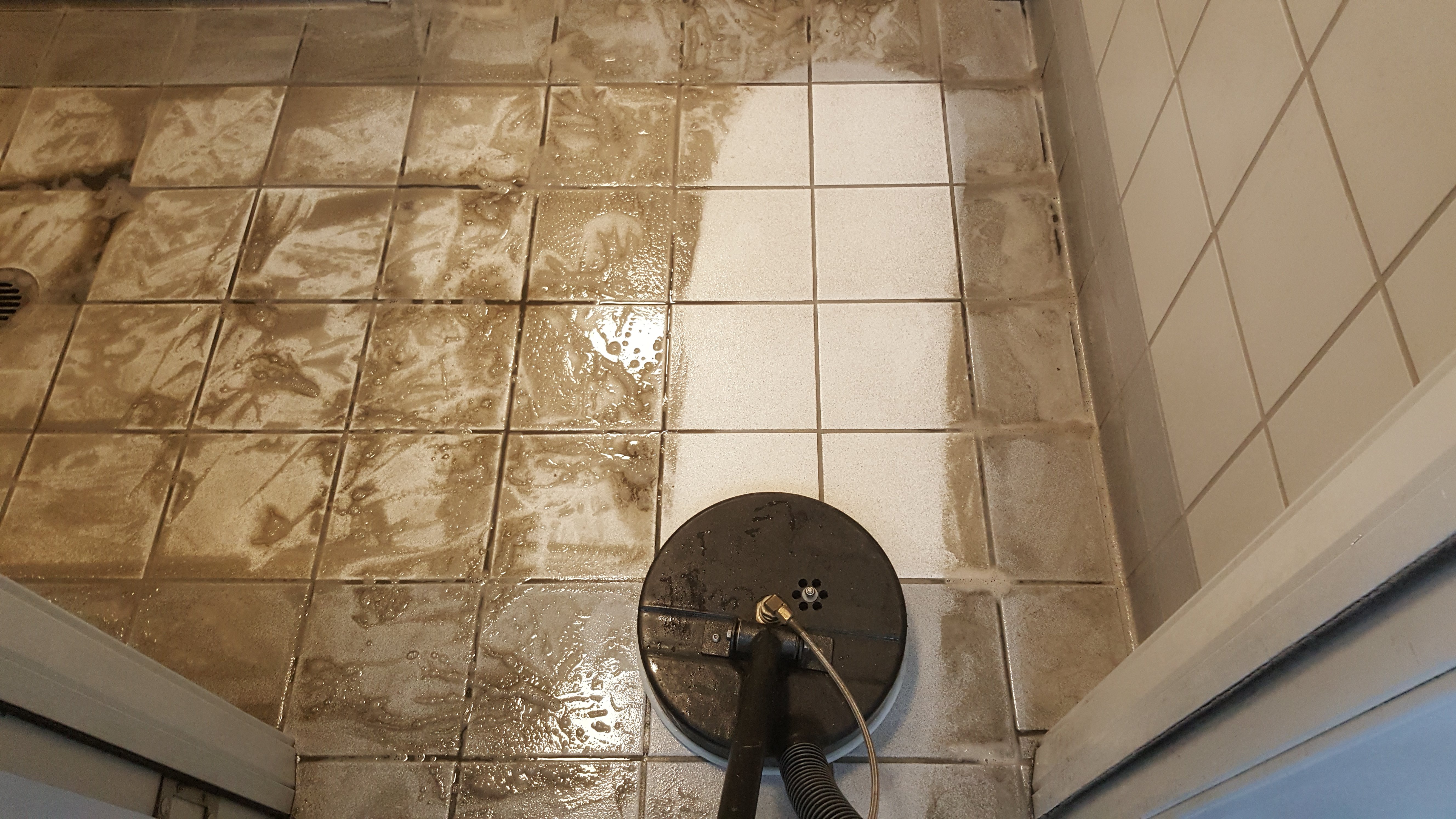

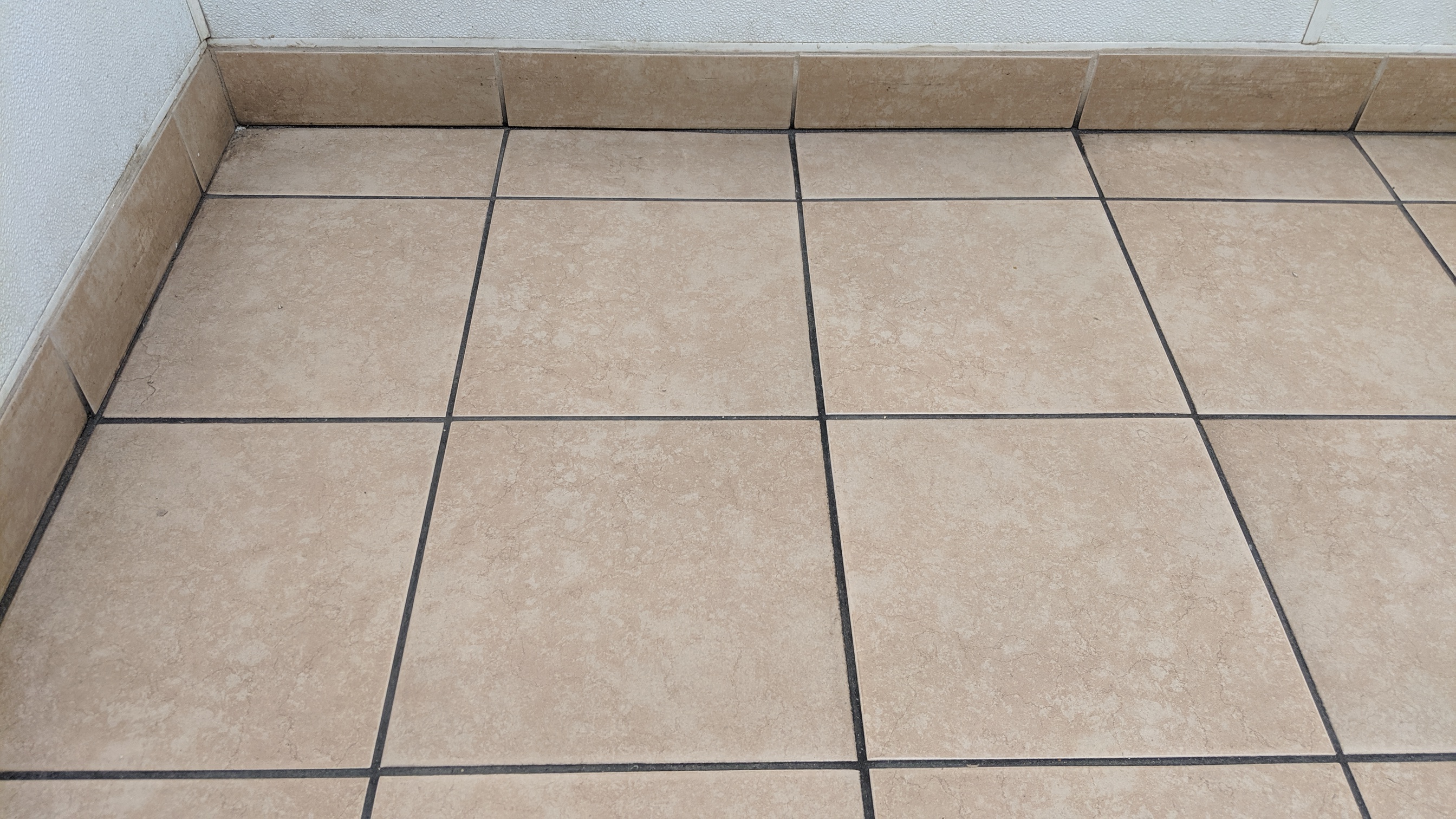

14,126
Dye the rest of that white grout on the top of the trim to black. Then clean the floor with a Neutral cleaner to get the piss off the floor at only 500 psi on your tile wand
