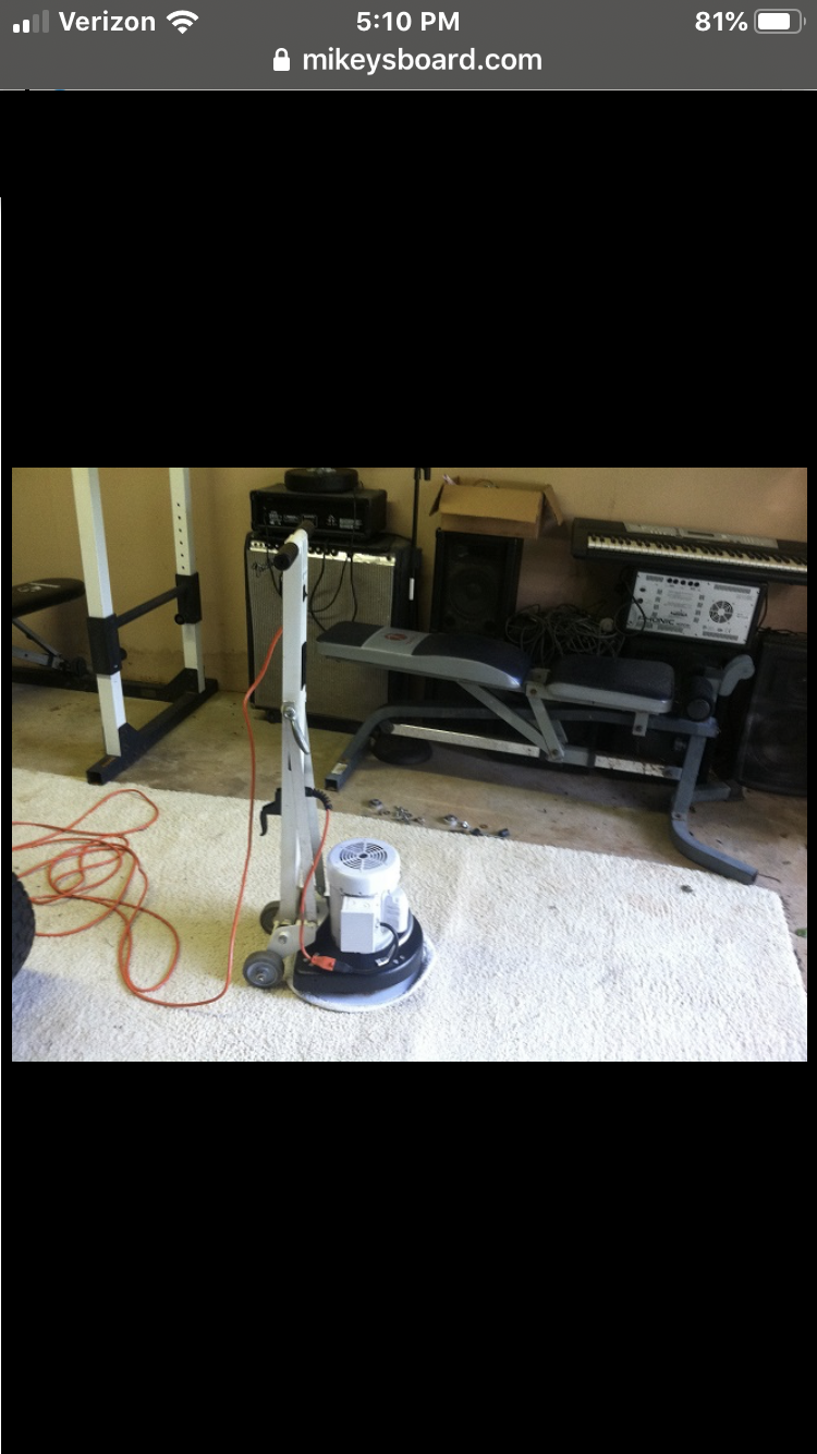

On gyms we Spray Spartan consume (also a great prespray for pre-encap cleaning on carpet) and run the vibe for rinse with straight water rinse. A 15-20 minute dwell time is a must for the mats.

You mean that you use a wet pad to mop up the Sparten stuff, right?
Yep spray consume through machine and pad it. Then rinse with water. The gym I do took 10 pads for the whole running track and the padded area I think they use for contact sports of some sort. A rotowash is better but unless you have a lot of use for it just HACK 😉 it out with OP or rotary.
