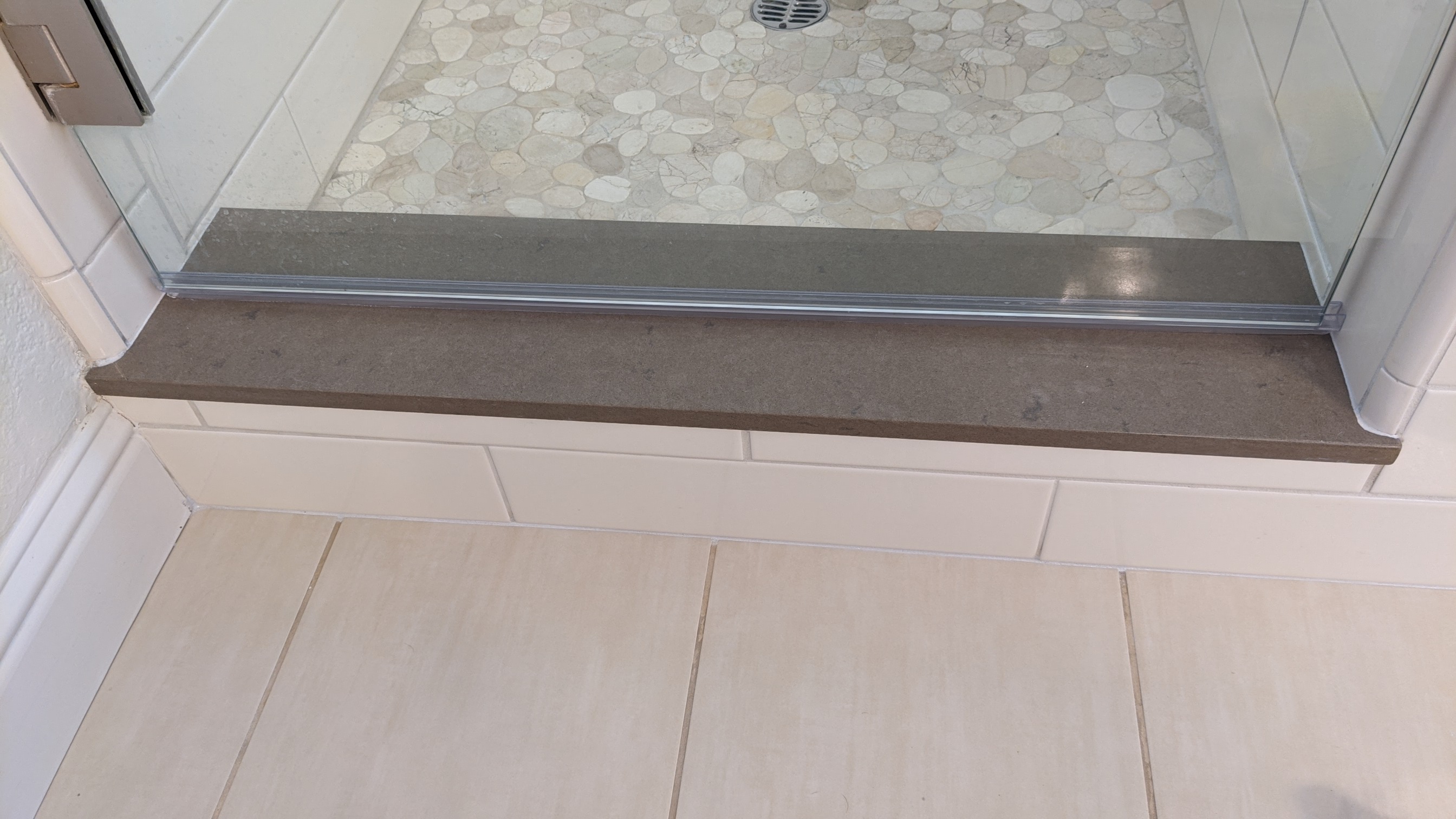

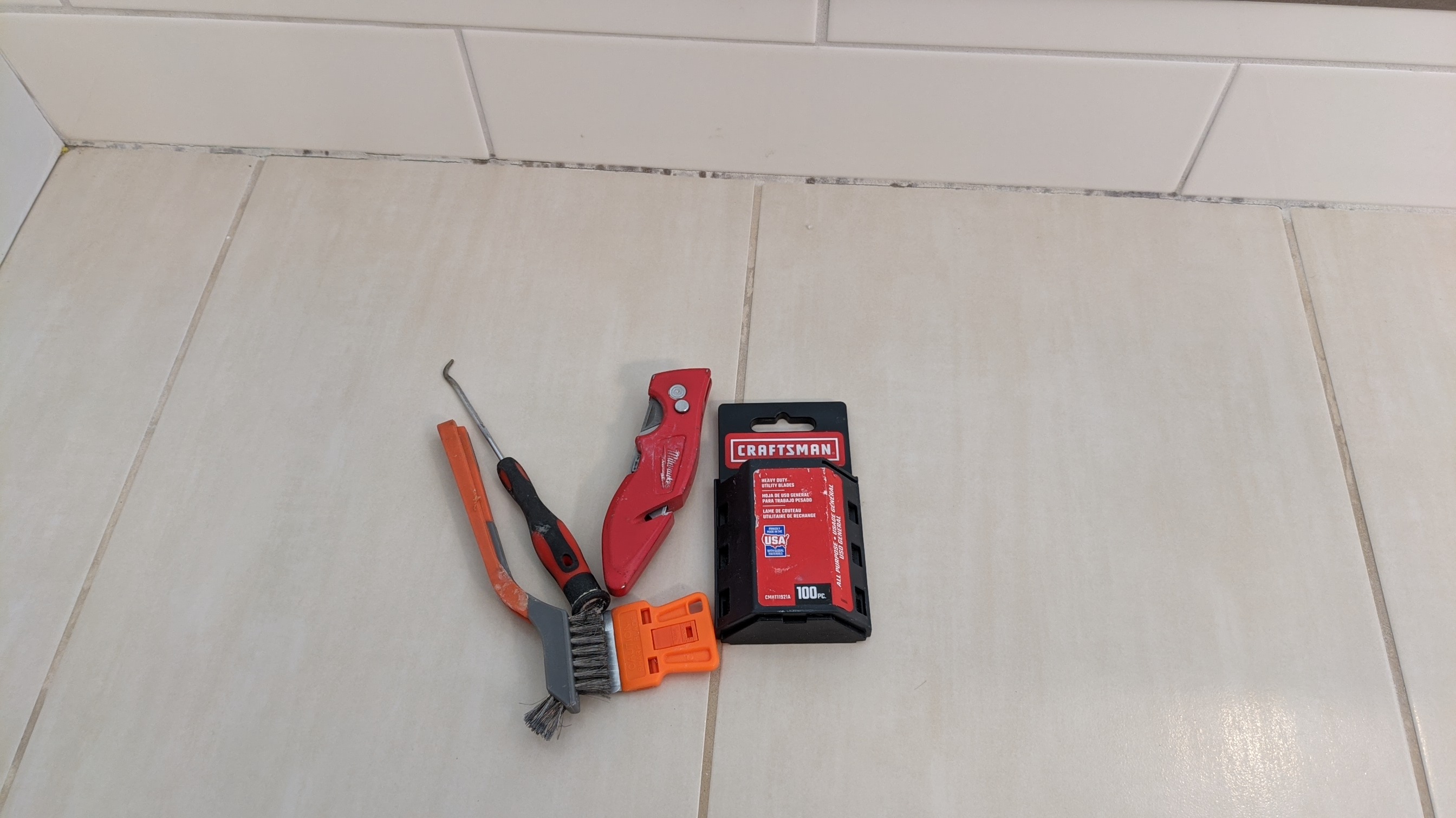

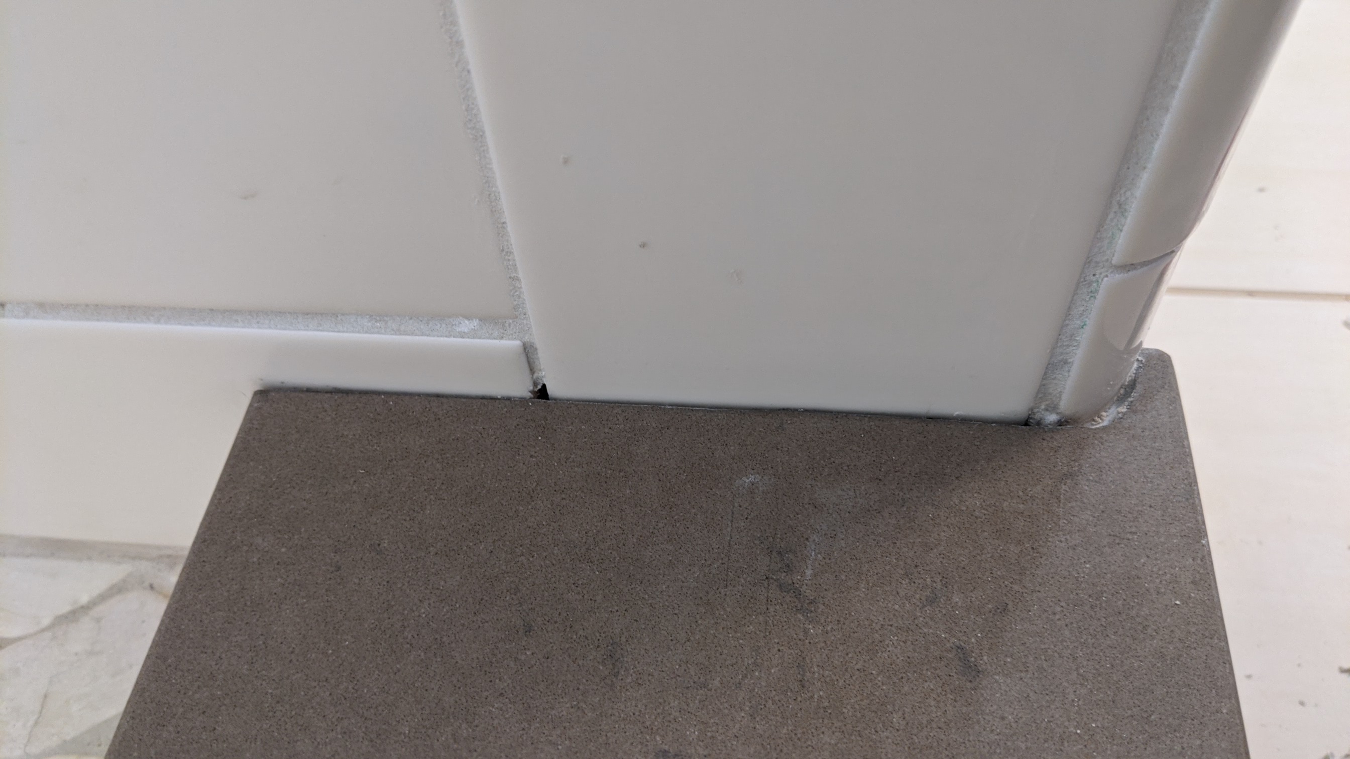

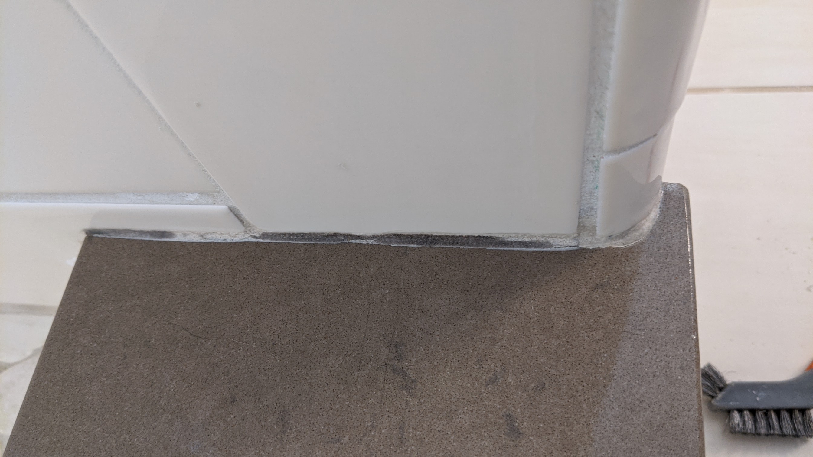

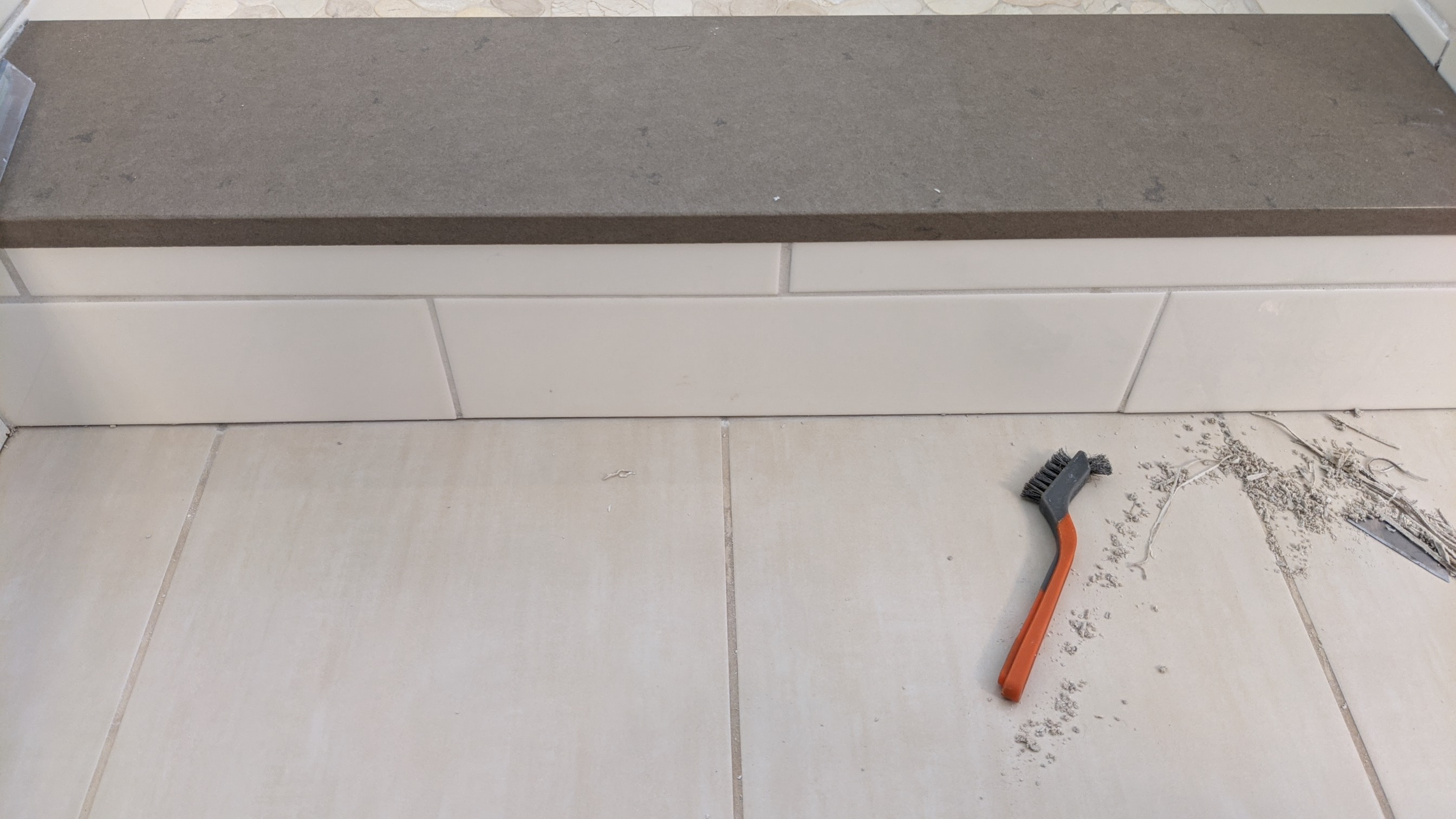

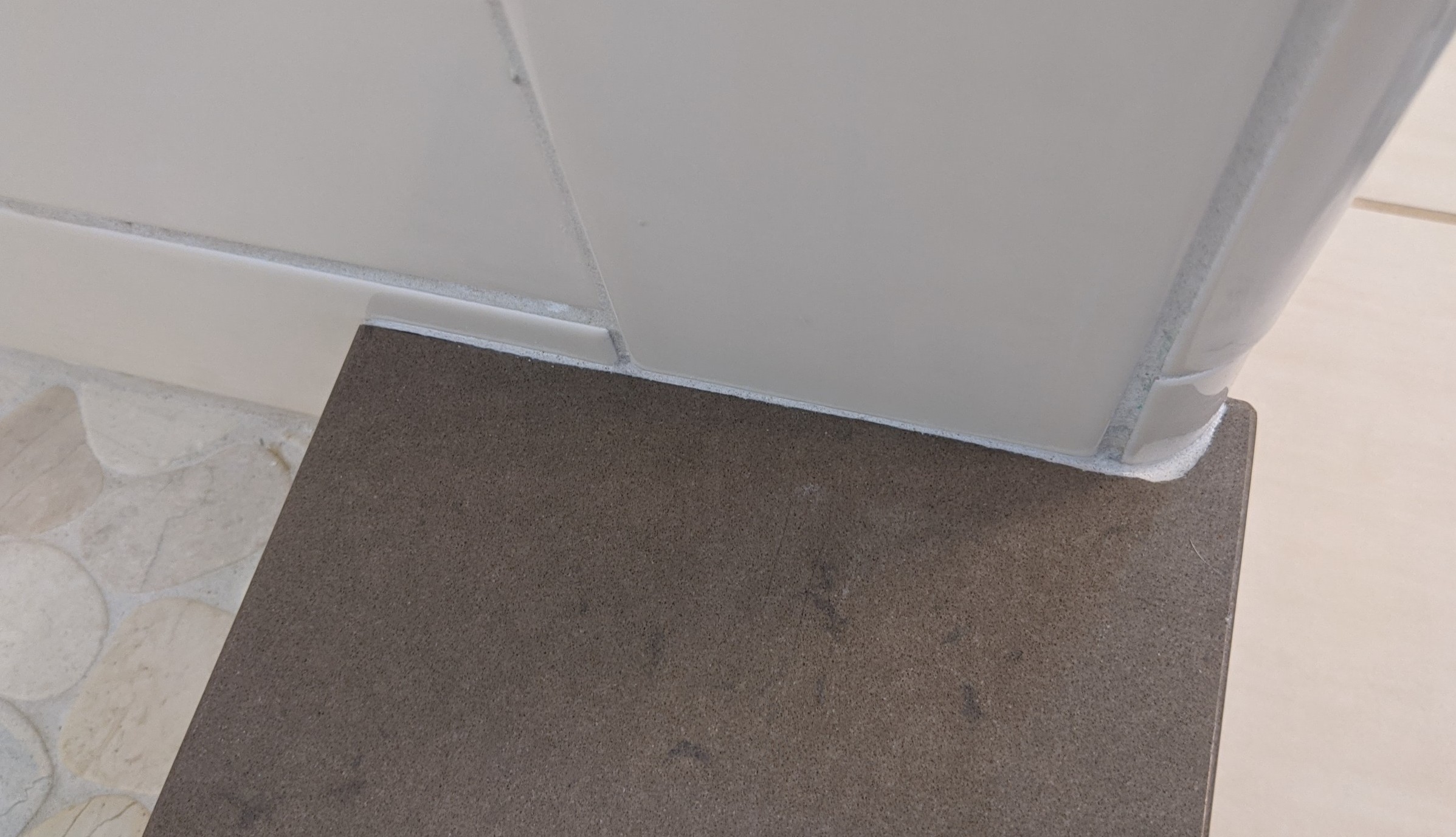

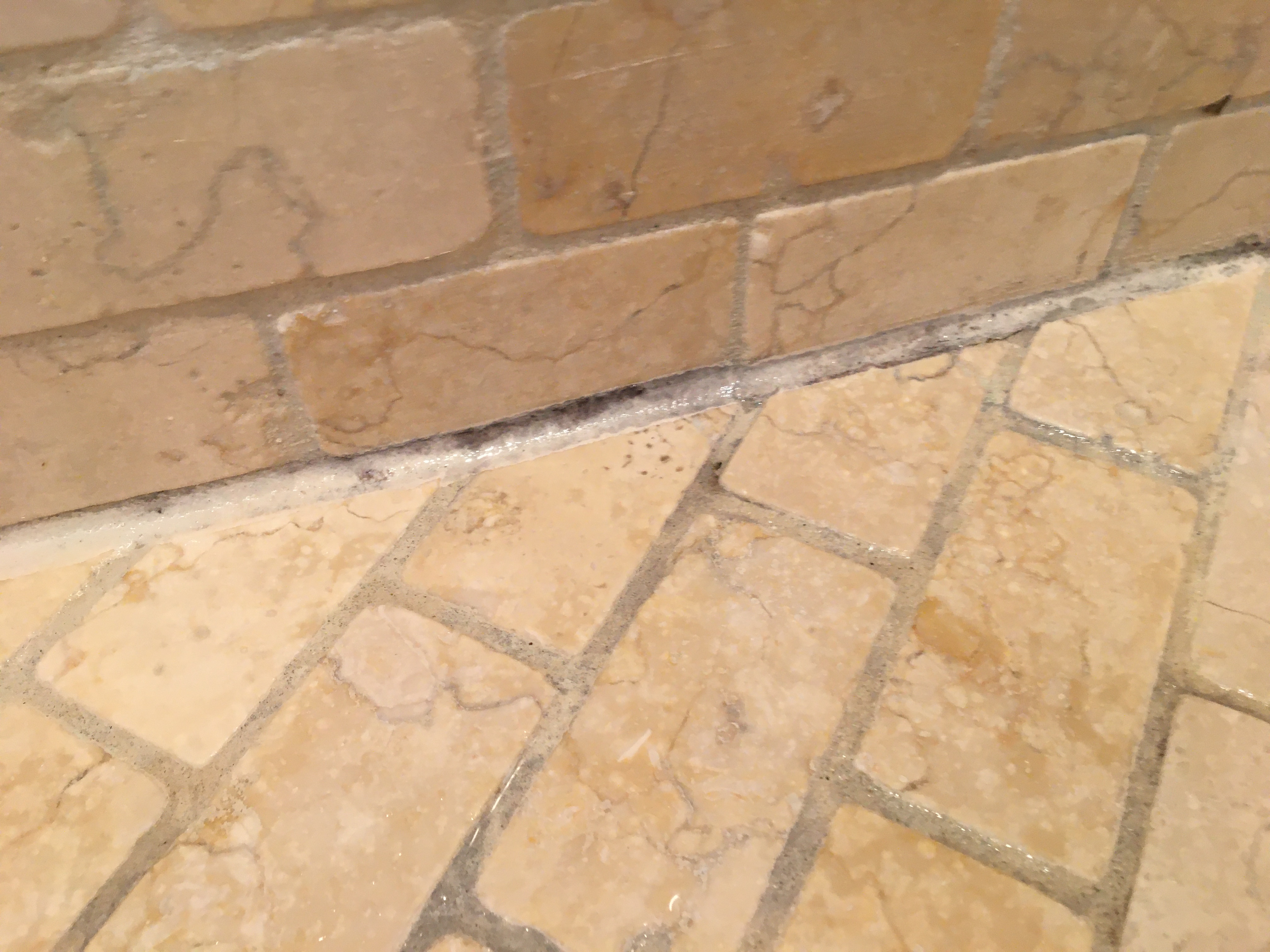

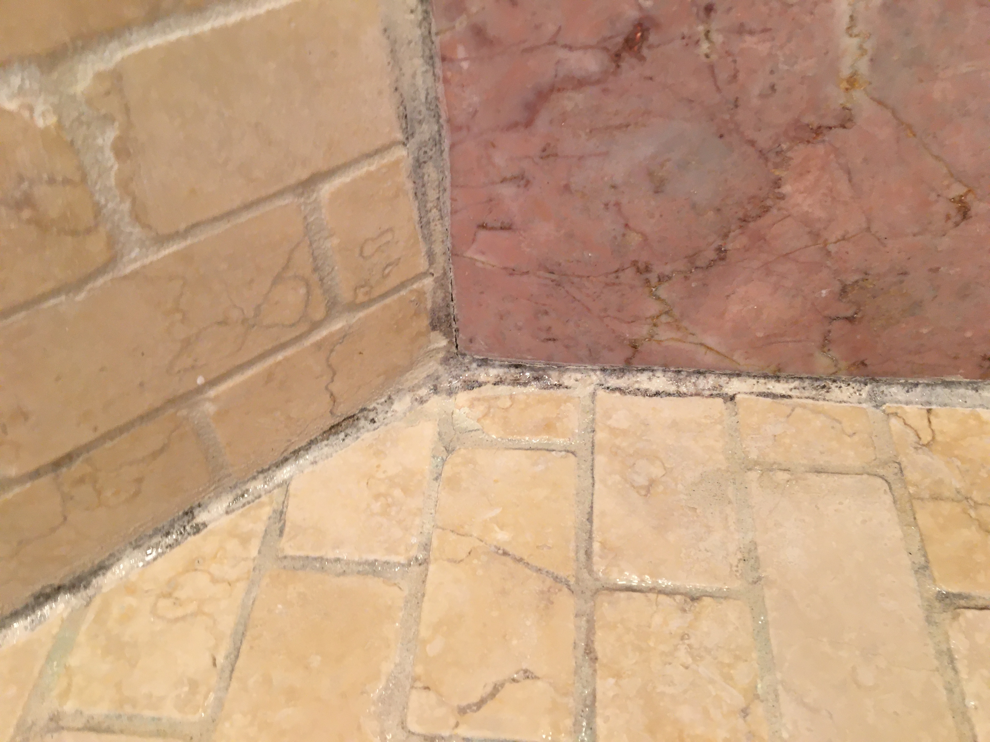

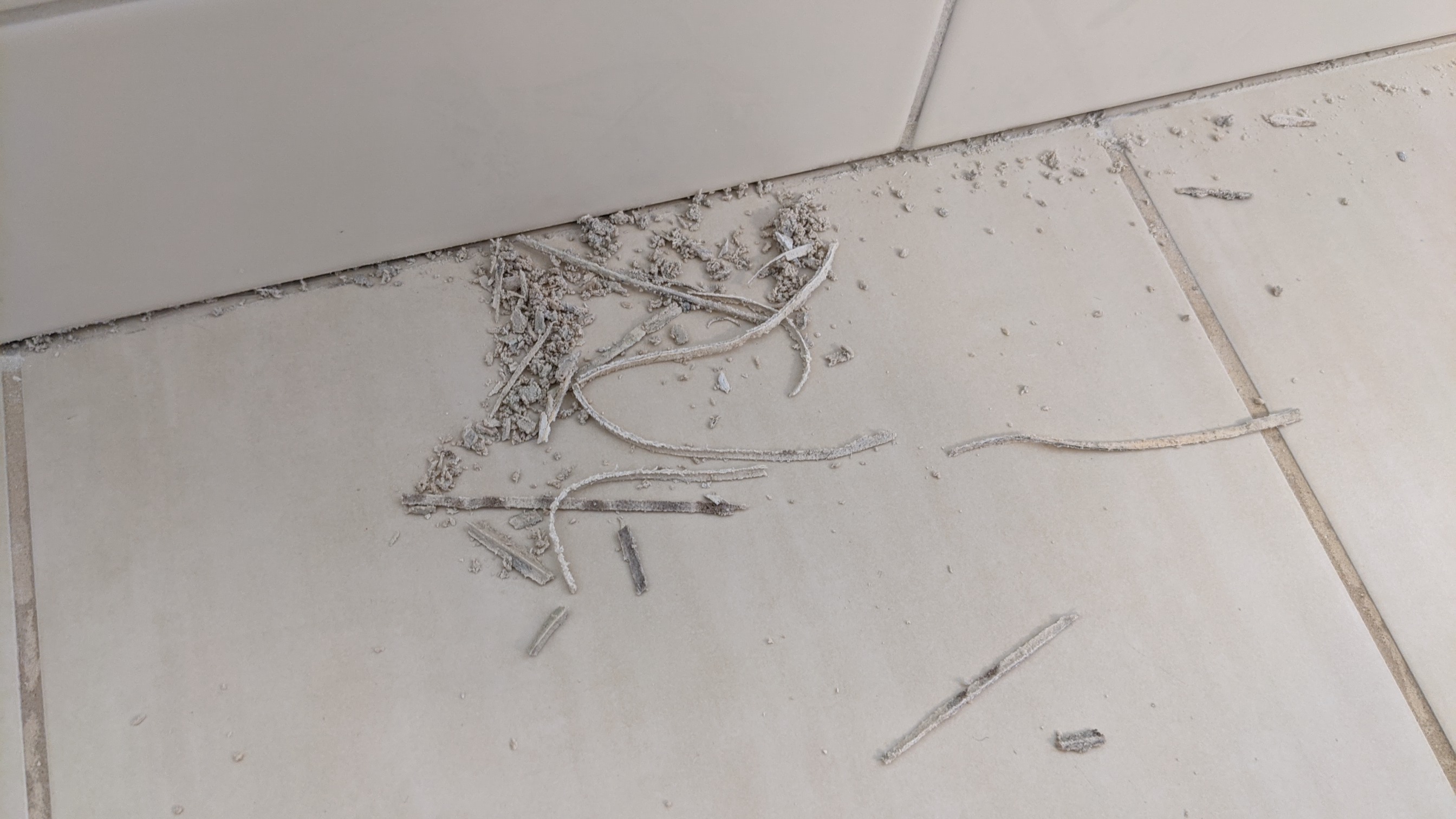

Was this caulk or grout that you removed? I have a similar job, but I am working with mildew on grout and none of my go-to products are budging it. Any suggestions on removing the mildew without removing the grout?
clean image
Oct 5, 2012
971
Carl Maddock
It is Caulk. The reason I dislike it on floor perimeters
Caulk does not allow vapor transmission. will mildew from inside out. Not clean-able, must remove.
Grout does allow vapor transmission.
SGA does not allow vapor transmission
Mike, have you been back on white SGA shower floor perimeter you have done after a year that is used actively? Like this one that had know mildew issues on what appears like a good caulk install.
Reactions: Desk Jockey
117,299
Correct
The bottom door seal failed and was letting water collect under a bath mat right there
I've had two shallow SGA fixes pop out after a recent earth quake but no mold issues brought to my attention

I'm not a Tile guy but grout isn't long and Stringy
unless you're drinking coffee and readin da paper!
