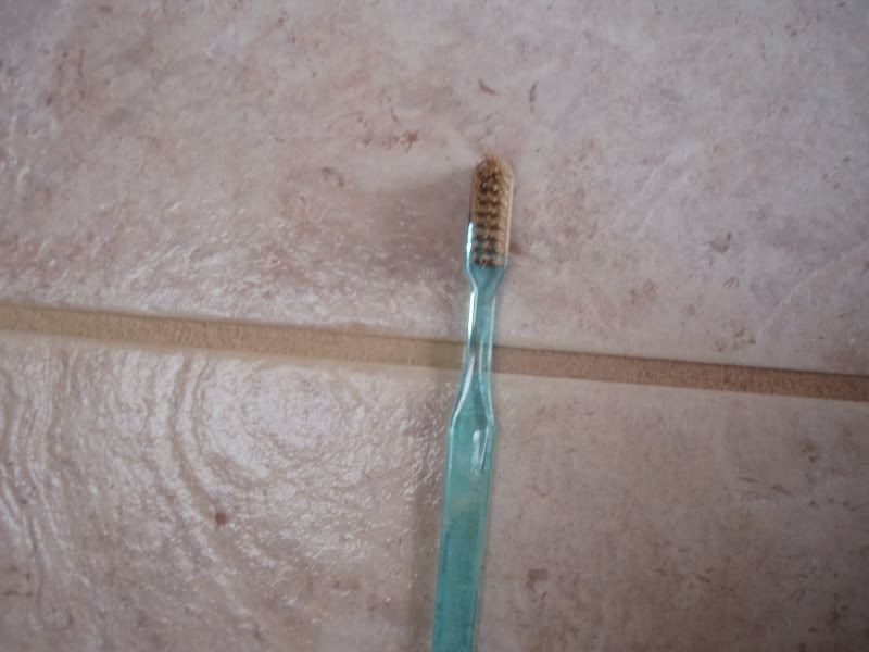

Tim Grout Perfect has 1000`s of colors and use there damp chammies is a must for the color sealing application process and I love there application brush comes with bottle. I only use acids if it is a cleaning job only to give the grout that 20% pop after Alkaline and rinsing or if I am clear sealing, with color sealing we only use high alkaline and rinse. While color sealing I change the water in my bucket when I start seeing a heavier haze develope this makes buffing quick and easy.

Initially the applicator brush is not easy - but when you get use to it there is nothing better or quicker. We have two methods of application:
Option 1) Beginners Version - apply a bead with the tip / yorker top and then spread with the brush
Option 2) Advanced Version with applicator brush
Check out the video clip in my signature line if anyone has any doubts.

We put out more production with the beginners version then the advanced version. It's for beginners and it's faster.
