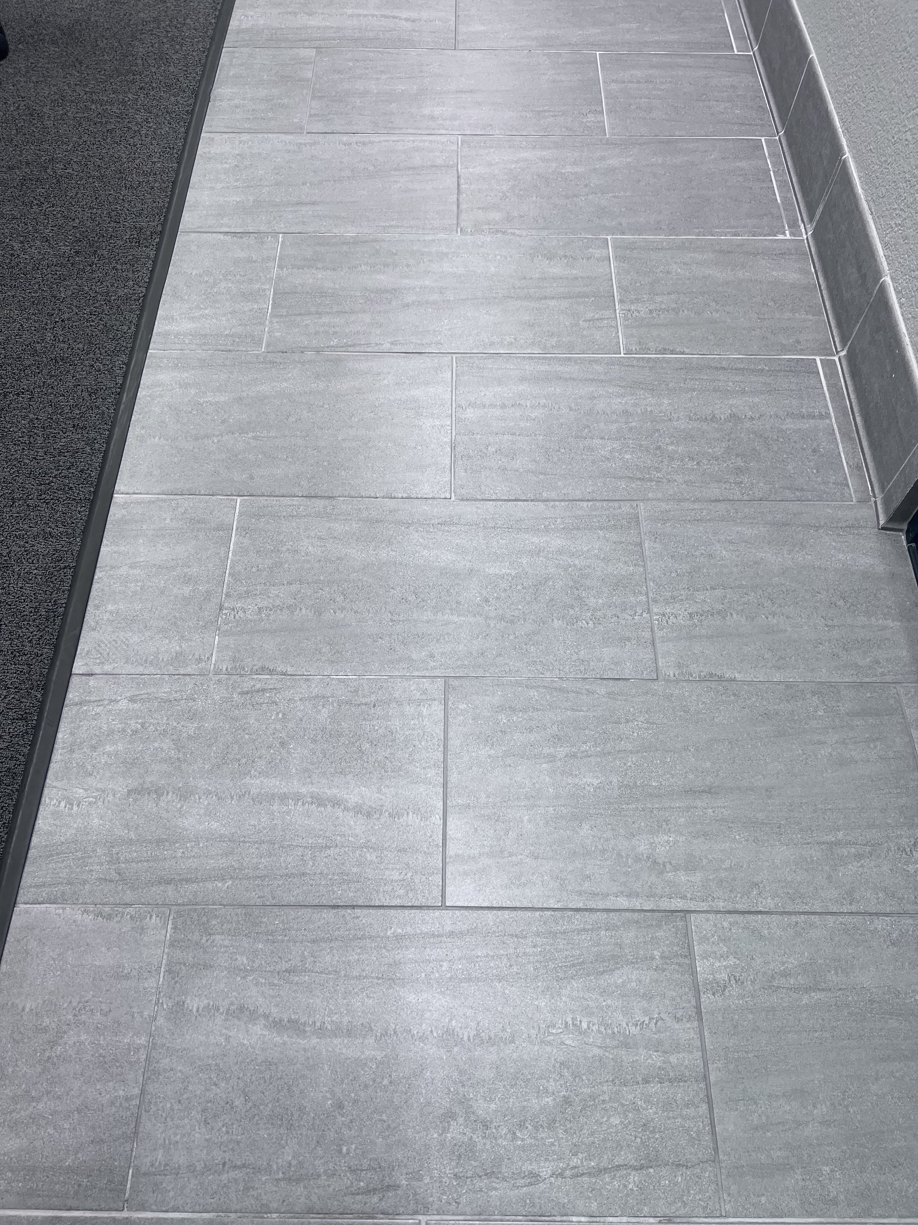

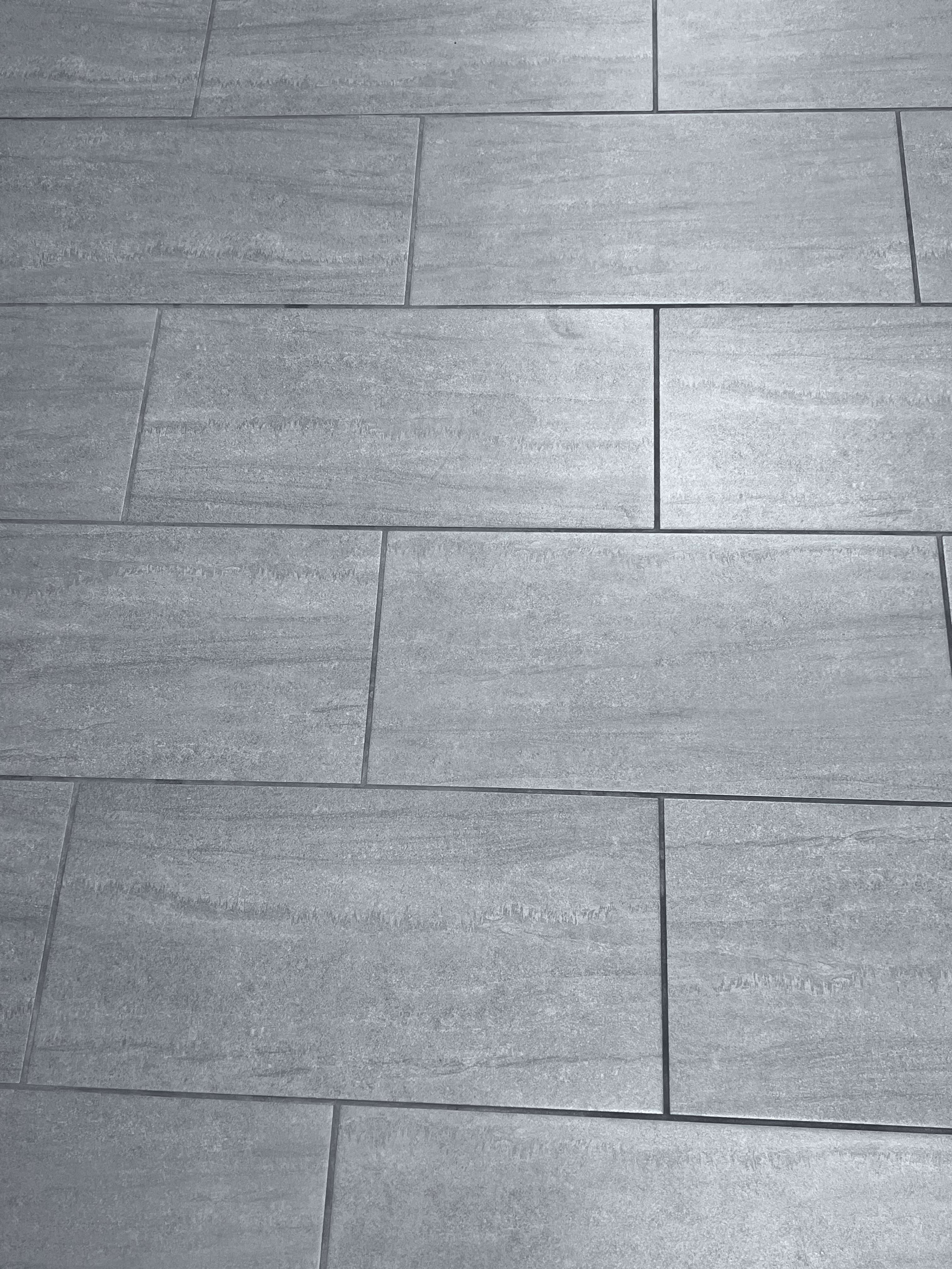

The senond picture shows the areas that look wet
