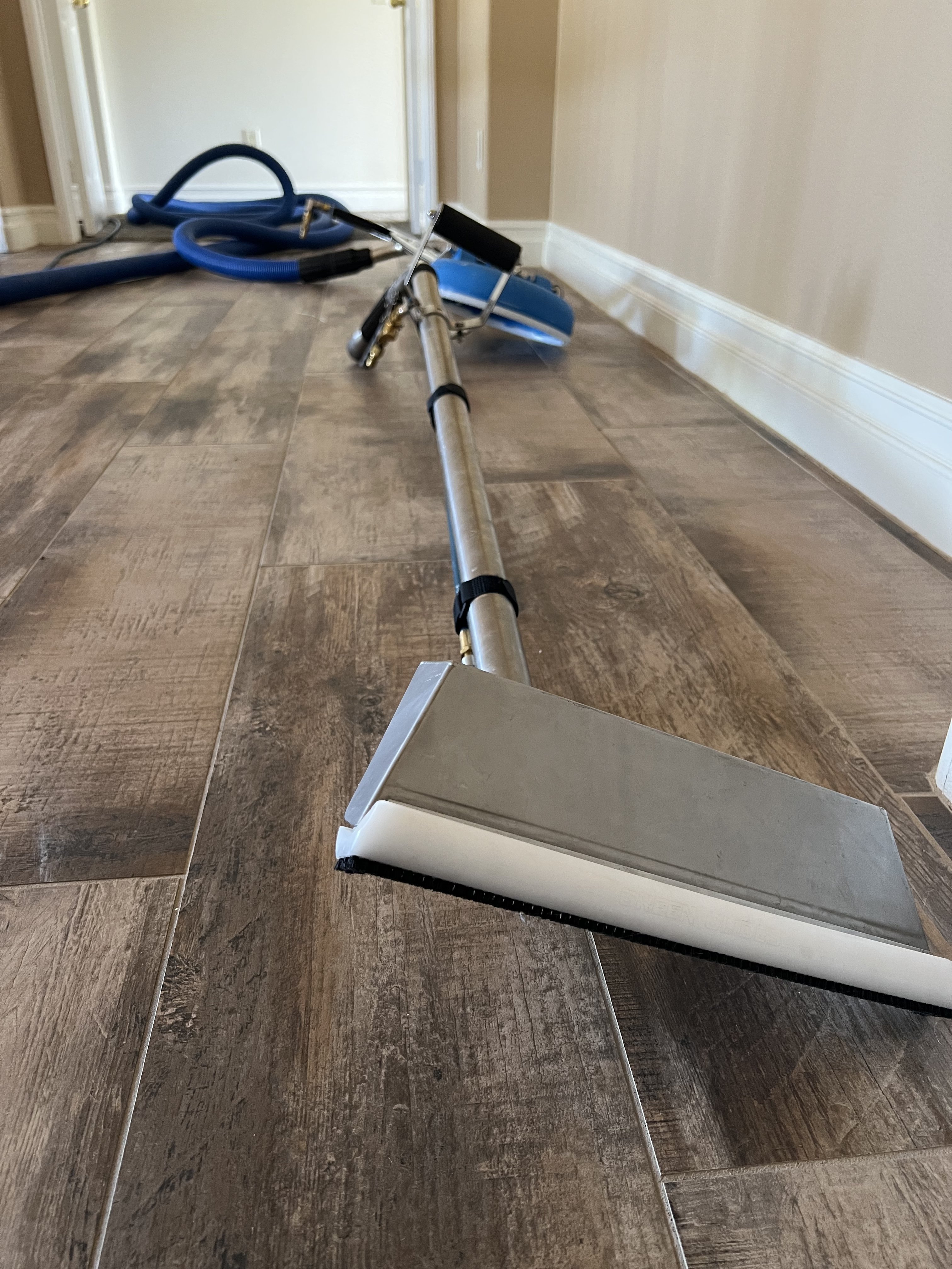

Green Glide tile psi??? Tips or tricks
Mr Brightside
May 4, 2019
912
Southern Cali
Jay Wags
First day using so far let solution (saigers) sit for 10 and extracted at 400psi it worked! I just wonder if I need more psi or less
Any other tricks will be appreciated
116,158
you need what you NEED.
  • Some floors clean up great at 200 psi, some need 700, if you need more than that, use a spinner
  • Deep grout lines respond better when worked at an angle. (less splashing)
  • Some floors clean better when spraying on the forward pass
  • Some better on the back pass
  • Some are both
  • Lippage that fvcks with the spinner and traditional HS wand, fvcks with the GGBG less, if ran at an angle to the grout.
  • All tools need a dry pass, even this one.
  • Step on you wand head on both sides of the tube to be sure the Glide is firmly seated.
  • Take off the back lip to make install and removal easier.
    I clean more hard surface than anyone here and I haven't used a spinners in over two years.

I used it a lot today and I usually finish white a mop today I used 200psi and the wand it was fun
