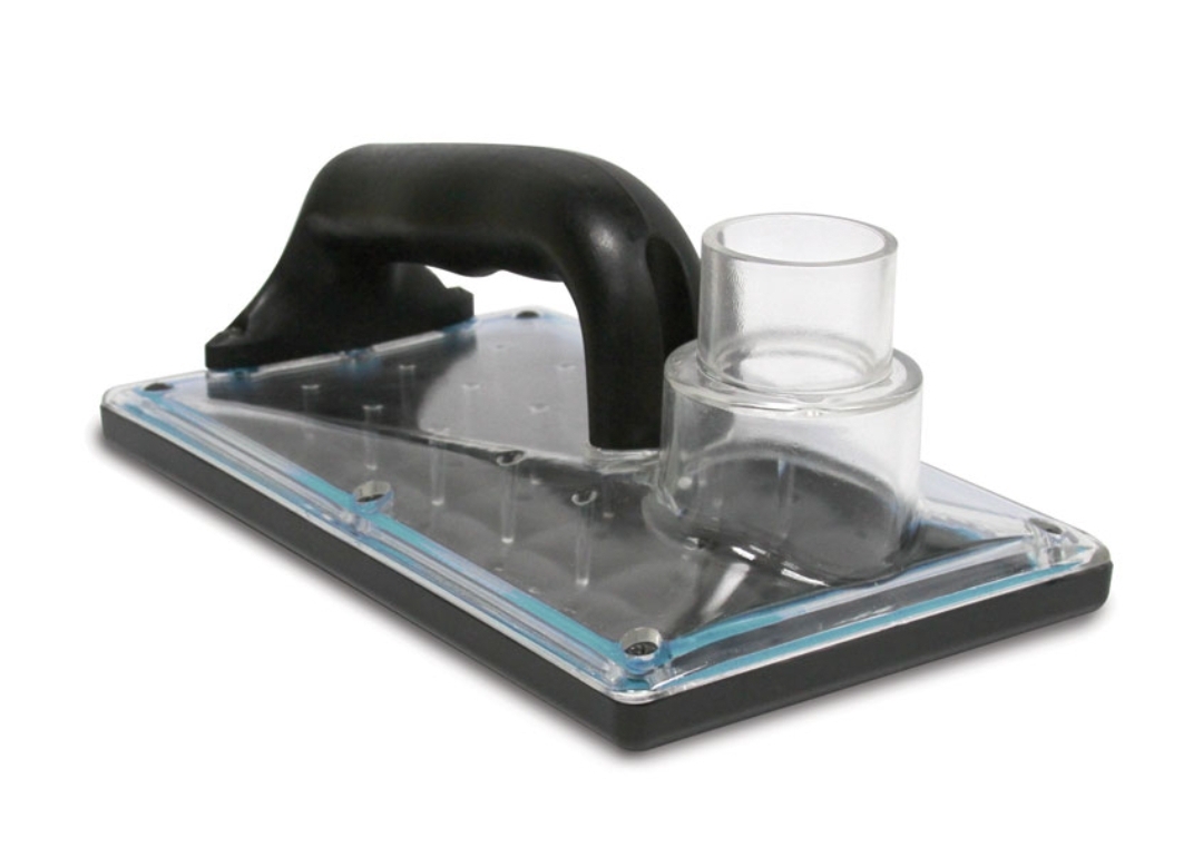

A sweet older lady called me up earlier today. It was an organic hit from an internet search which is still fairly rare for us. Her water heater broke last night and leaked onto her basement floor, half of which was carpeted. She only needed the room with carpeting addressed which had water underneath it in a 10 x 12 area.
Using my SOS tool I extracted about 15 gallons of water from underneath her carpet, setup 2 air movers and a dehumidifer in the room and will leave it there until tomorrow morning. It went great, took me 3 hours on site and I charged her $400. Im thinking for basic residential water extraction and drying all I need to get is extra air movers and a proper dehumidifier to go for it when local emergencies pop up.

what's an SOS tool?

Wow thank you Larry! I'm stoked to come down there. The SOS is a small inexpensive subsurface extraction tool.
