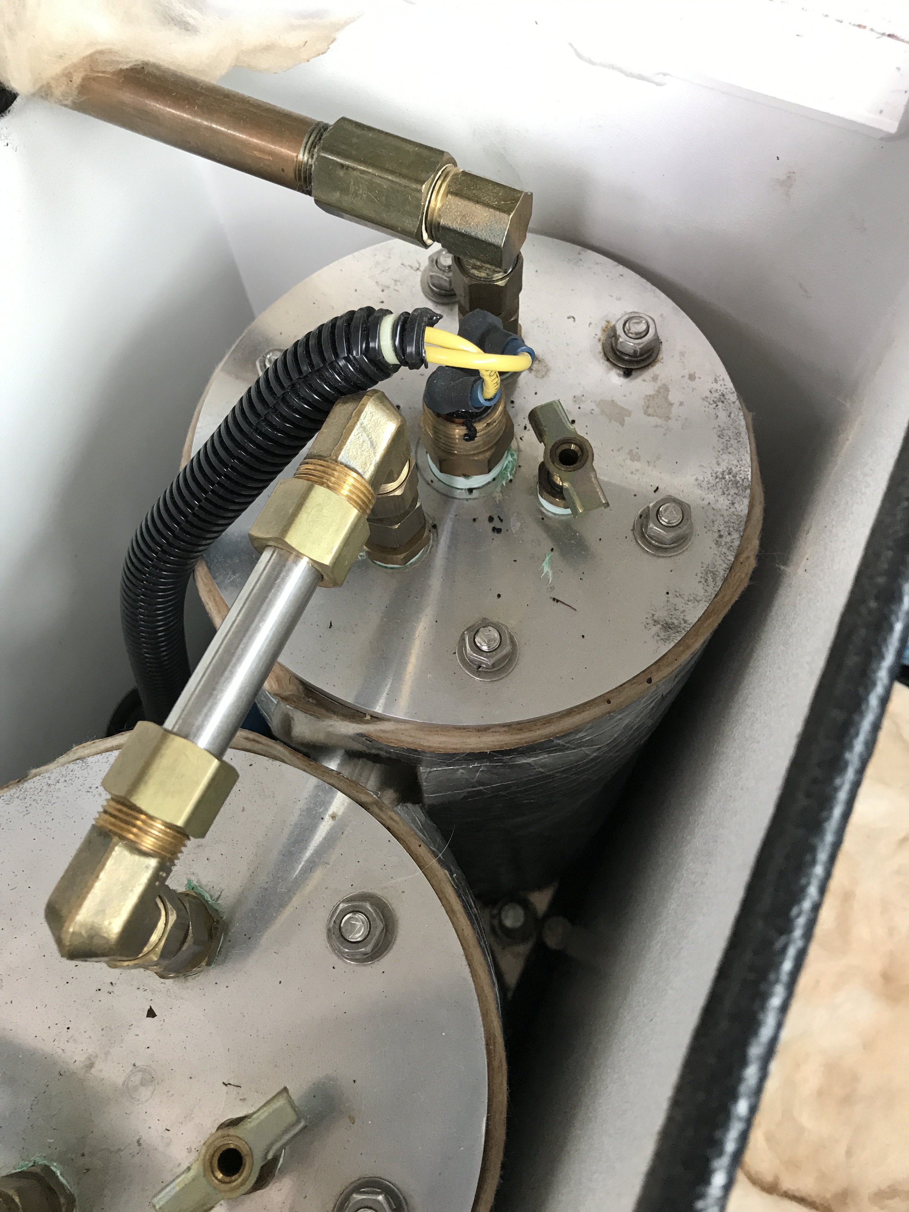

Check these out Marty. Simple solution to a common problem. Getting prepped for this winter's project build.

Maybe bleed them when the TM is semi Hot to speed up the process? I bleed mine nearly everyday and only takes seconds.
