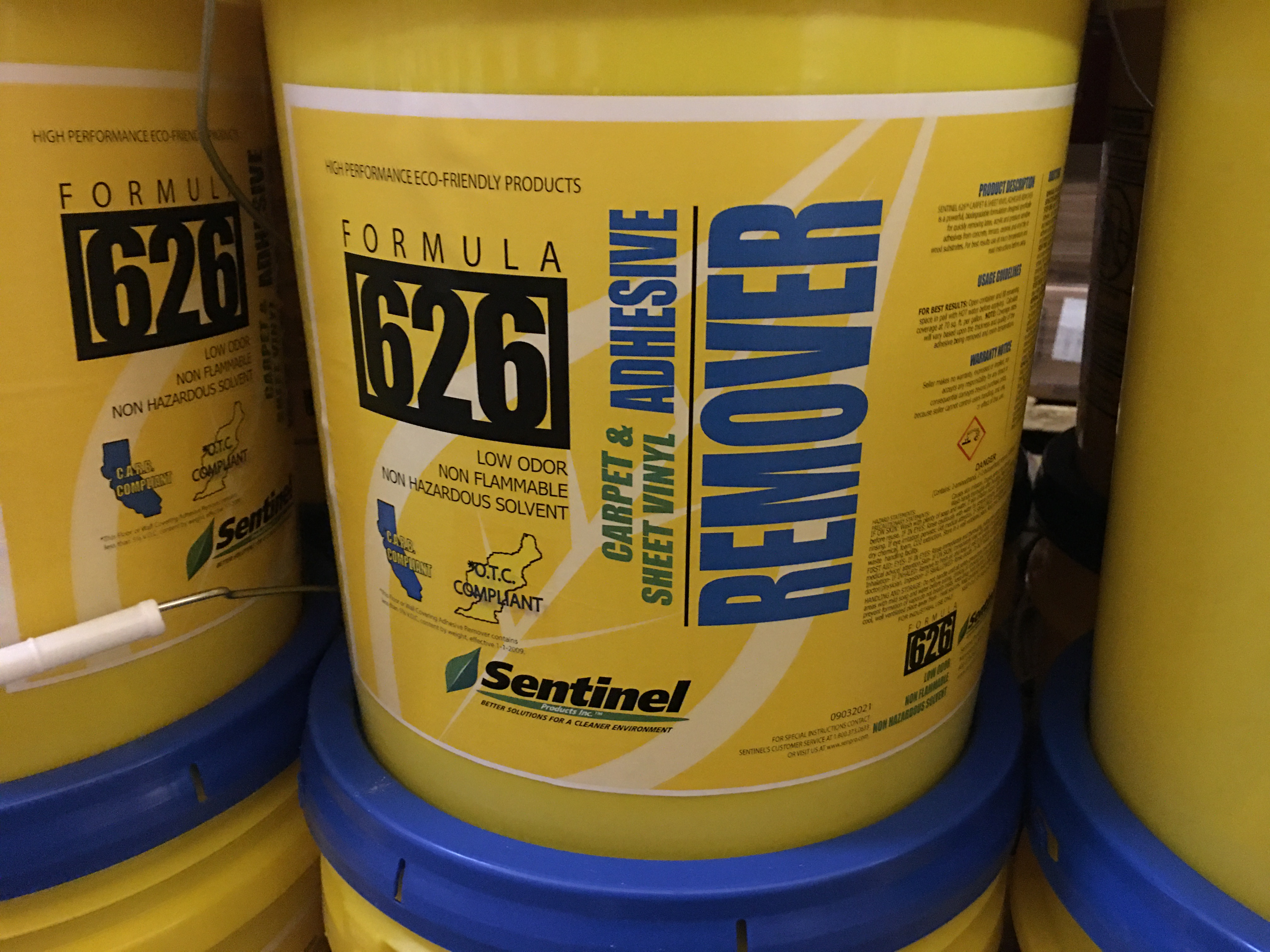

Research this stuff. I don’t know if it’s safe to apply on the floor you’re working on, but it’s a starting point
Thanks for the lead. Many reviews say it doesn't work, but some say it's amazing. Formula 747 is more aggressive it seems. But nearly all reviews are for removing adhesive from concrete flooring and I am using it on VCT. I am thinking that it'll work and any that gets in between the tiles will dry and hopefully doesn't become a problem.
Next, I need to remove the ink "3M" labeling that bled into the VCT from the carpet tiles. If it doesn't come out with the stripper then ProChem Ink remover?
