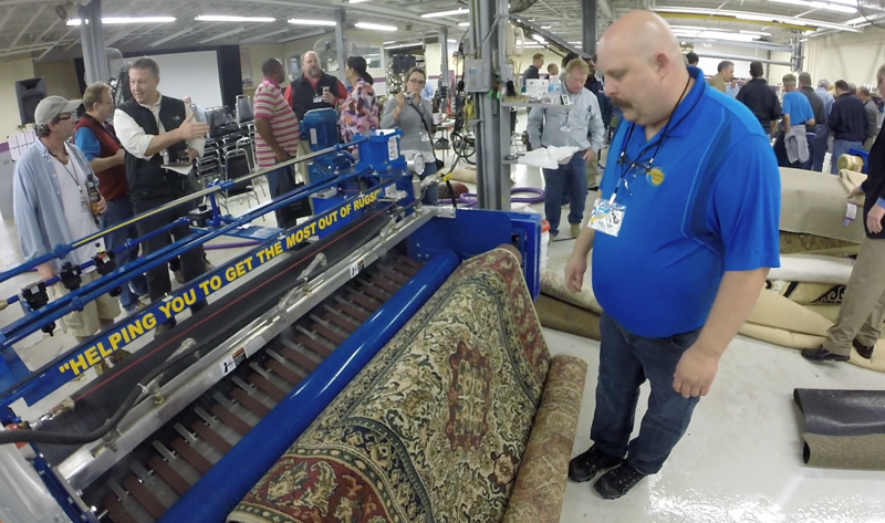

What we are looking at here is a 16 foot basic Rinse Wringer. We make 13', 16', and 19'. The bells and whistles create the cost. A 13' Rinse Wringer starts at $125K and the other machines that are bigger with more add-ons like Hagopian's can exceed $250K.
Note: Above unit was made and delivered last year.

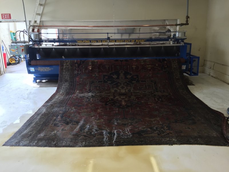

This is the most current MOR with a linear motion jet spray. This 16' machine is a wash wringer at Joe Gabel's

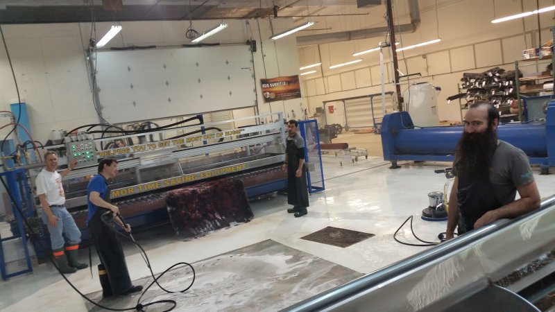

Joe's one is a sweet setup... I'm still in awwwe of Roberto's wringer... That was 35seconds to run it back through in reverse...
Time saver is an understatement...! I understand now how fast and efficient a wringer is...

Can you imagine if the guy on the right got his beard caught in the wringer.
Would he work on the Sabbath? I think not...
