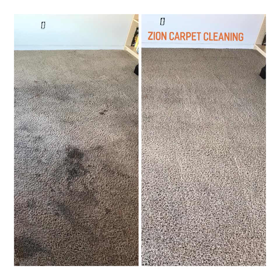

Used Powermax for the first time on a job today. I've read a lot of mixed results about it on here but decided to give a jar a try. I usually use Slop and Gobble or Green Dragon for Encapstore and really like both. This job was pretty nasty and all 4 rooms were similar to this one. Mixed 8 oz in my HF 4/1 and extracted with my RX20 and soft water only. Carpets came out great and no spotters were needed at all. I've never smelled the old stuff but like the smell of this current Powermax.
116,268
Never base your judgement of a Prespray on one job.
Most carpets in that condition are so loaded with dys or franchise residue, to the point that just water would have done the same.
Use the whole bucket and get back to us.
Powermax is a good product at a great price.
Unfortunately the inconsistent nature of Cobb product and service may drive you nuts
