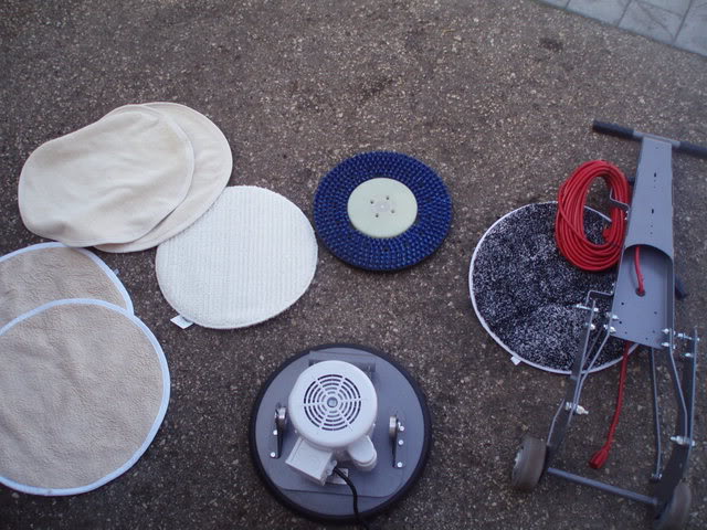

Here is what I got form Clark (in 2 boxes)
Two types of Cotton pads, A Tuuway and a thick black bonnet of the likes I've never seen.

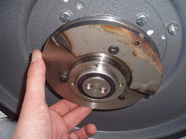

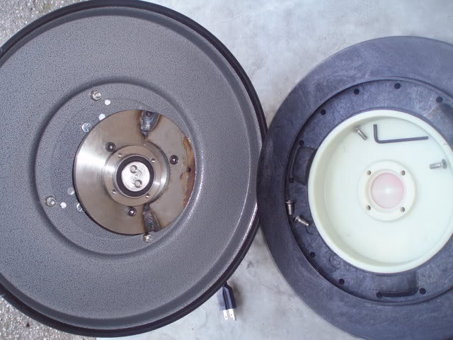

The guts.
Notice the travel range.

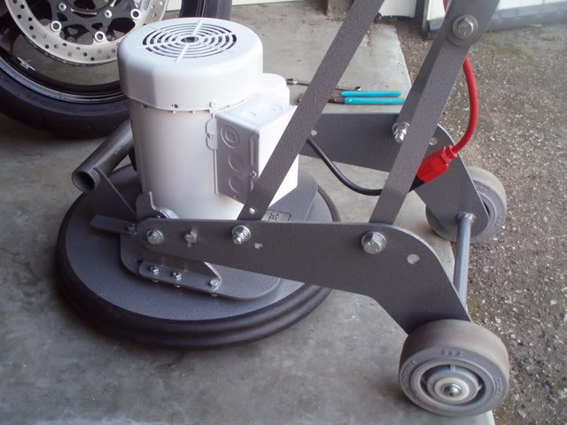

I called Marty to help me figure out where the arms bolted into. His machine is older so I eventually figured it out.
A manual would have been nice.

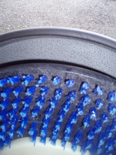

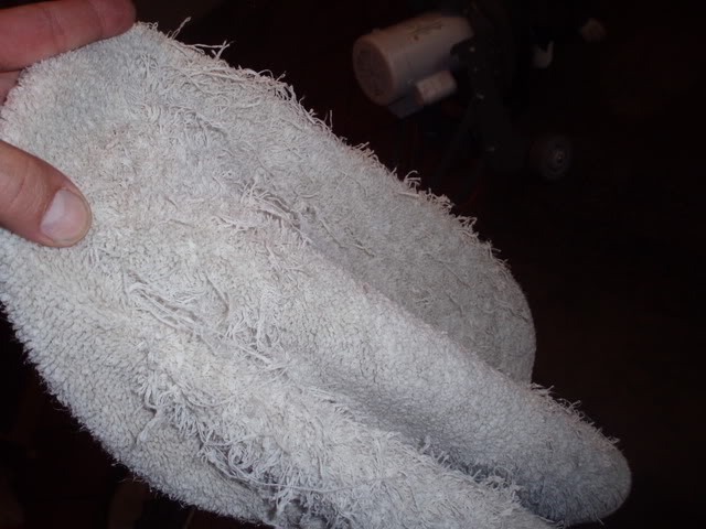

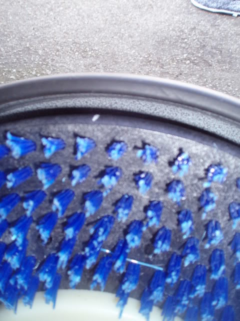

First I tried the Egyptian all cotton pads. You can see the damage the driver caused to the pad. Not good. I think I'll need the Velcro driver if I decide to use cotton.
The Defender was also very hard to control on this rug with all cotton pads. John's new blend pads were better but still took way too much effort.
The driver chewed it up as well. But so does my 175's driver.

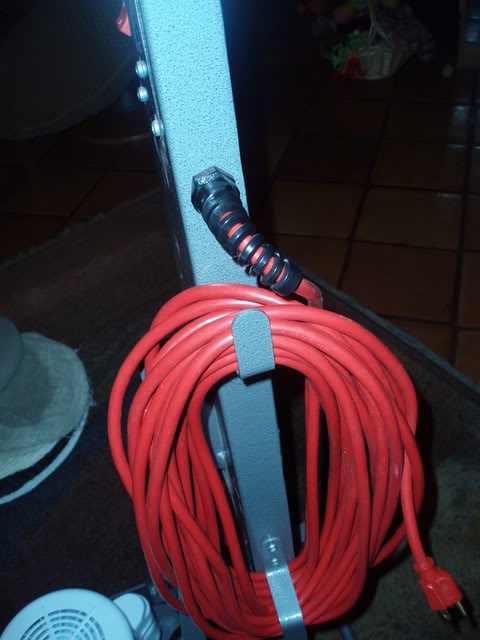

The only flaw in the machine itself I could find so far is that the pig tail is way to close to the top cord wrap bracket. It took too much effort to get the cord between the pig tail and the bracket.. Lower the braket two inches and all will be good.

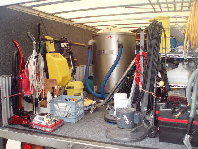

The V is getting over loaded.

Mike, are you referring to John's new pads. If not get a couple of those. It will make the machine run smoother. Even the brute with thin cottons runs pretty hard. As far as that driver, I don't know.

Get the velcro pad driver like John's machines and also get the Gladiator Pads from John.

Ya, that regular pad driver is ridiculous.
We just use a black stripping pad and it works great and causes very little problems with the pads.

My go to guy's with that machine, and vlm cleaning in general, are Steve Smith and Jeff Brown. Both of those two use the Tuway pads with that machine exclusively. I ran my machine on dry carpet, with a dry pad, and it glided smooth as glass and there was no damage to the pad, but I bet cotton is a bear with that driver.
Steve swears that he has done extensive testing with the Tuways and cotton pads and the Tuways pulls as much soil as the cotton, according to him. I only plan on using my machine in commercial, and I know the Tuway pads do fine with commercial encap. cleaning because I've been using them under my rotary now for a couple of years.

It looks to me that you have the tile driver on, try the other driver.

I've had a 20"Defender for about 3 weeks. It came with the bristle pad driver. I have run the thicker cottons, the glad pads and tuways under it and have had no problems with any of them. The machine is very smooth. We've been following the Cimex with it and like the results.

The only mystery in putting it together was that the handle release goes on the front of the machine.
Every other floor machine I've ever seen has it on the back. So I had to stare at it for a while to figure it out....
And it actually did come with a Allen Wrench.

The fluffy black pad is micro fiber...
