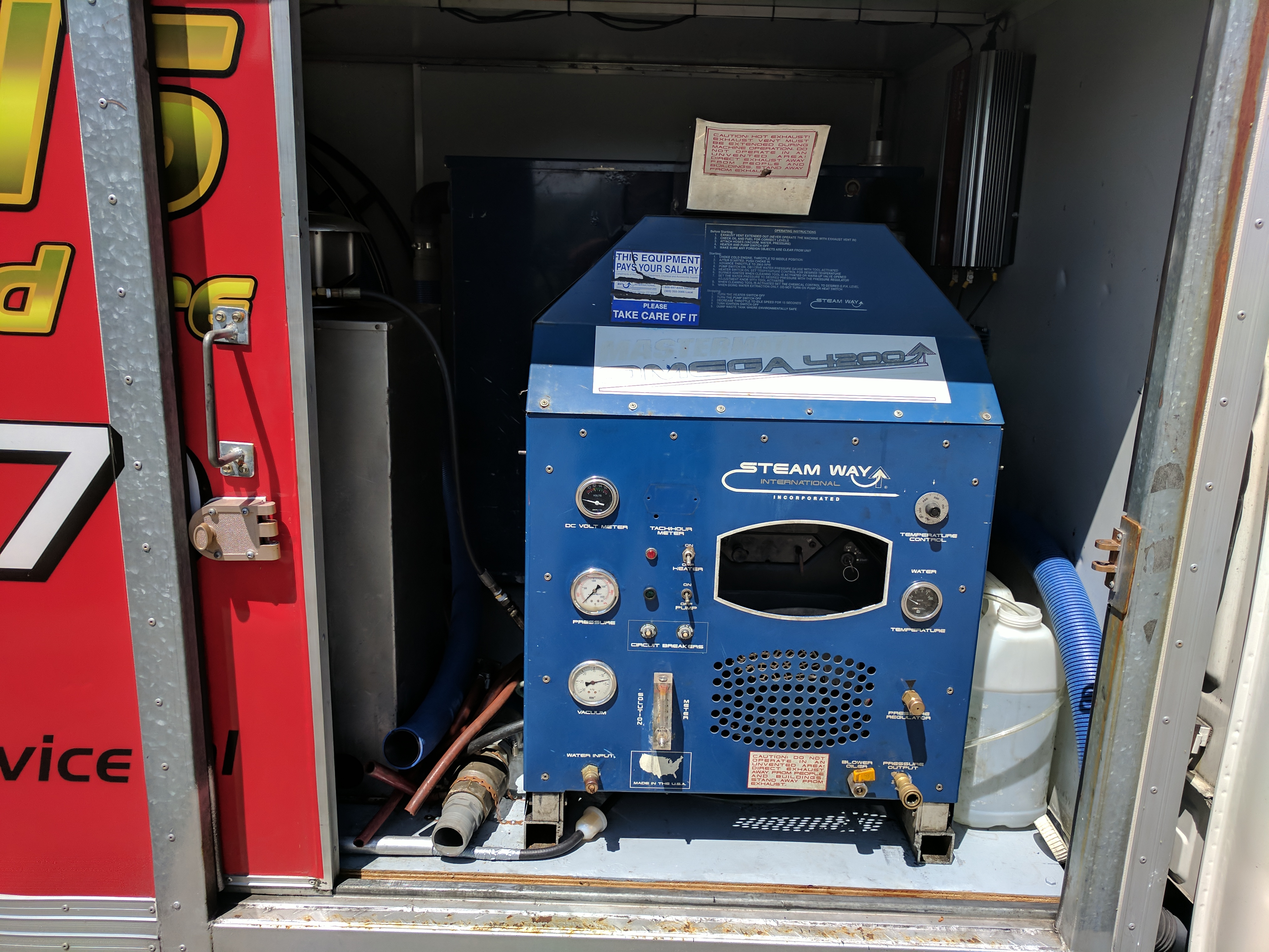

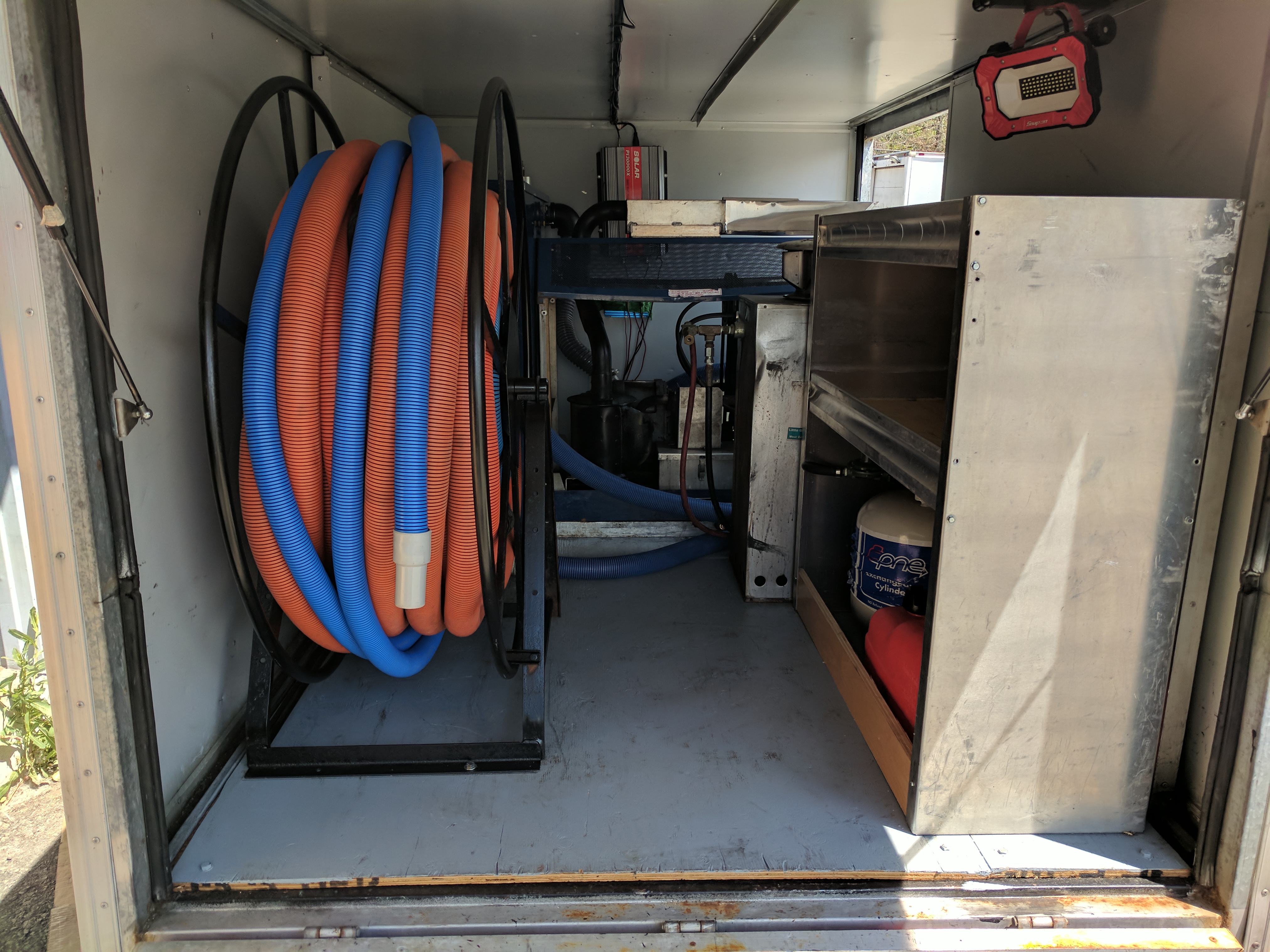

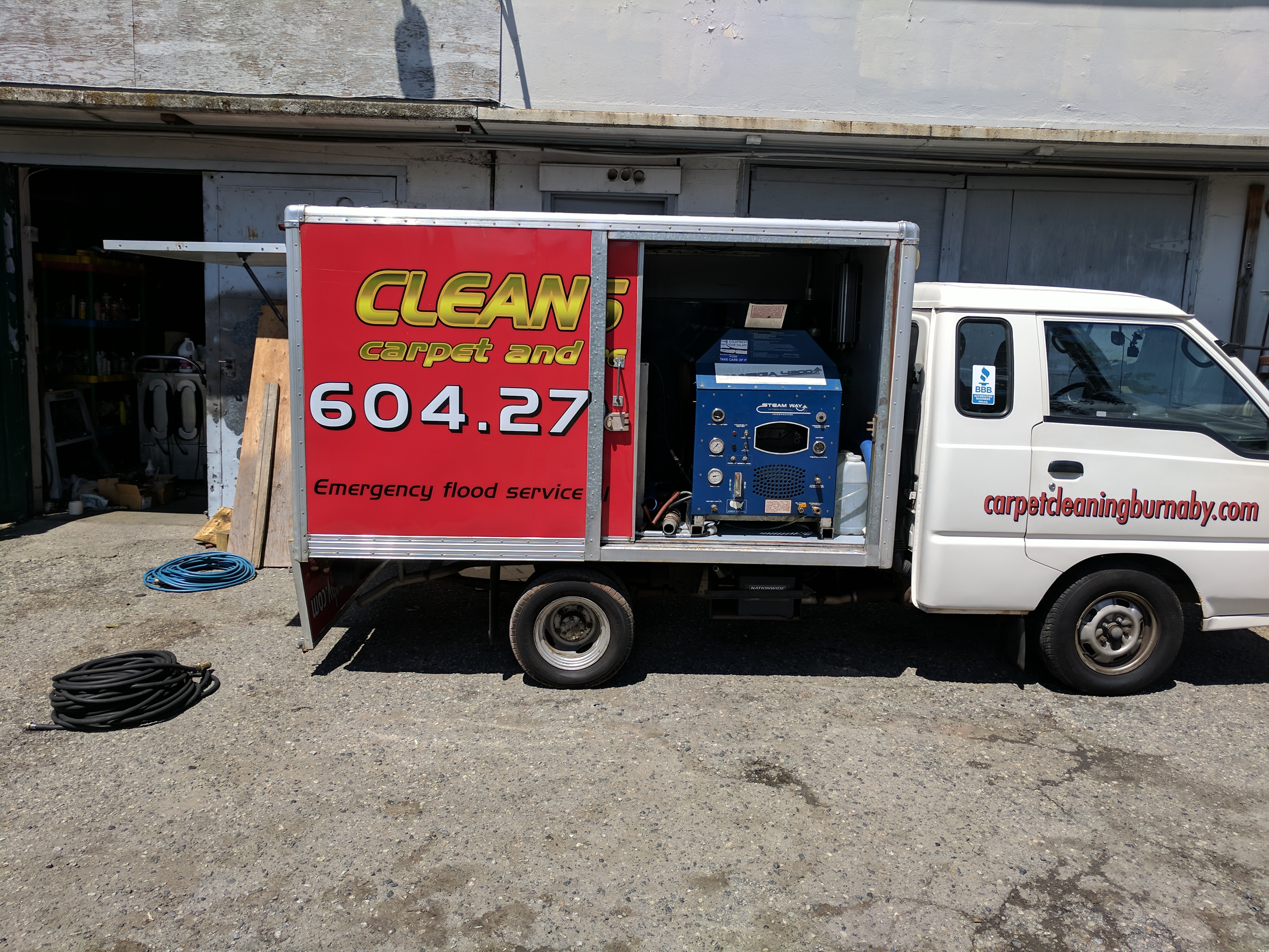

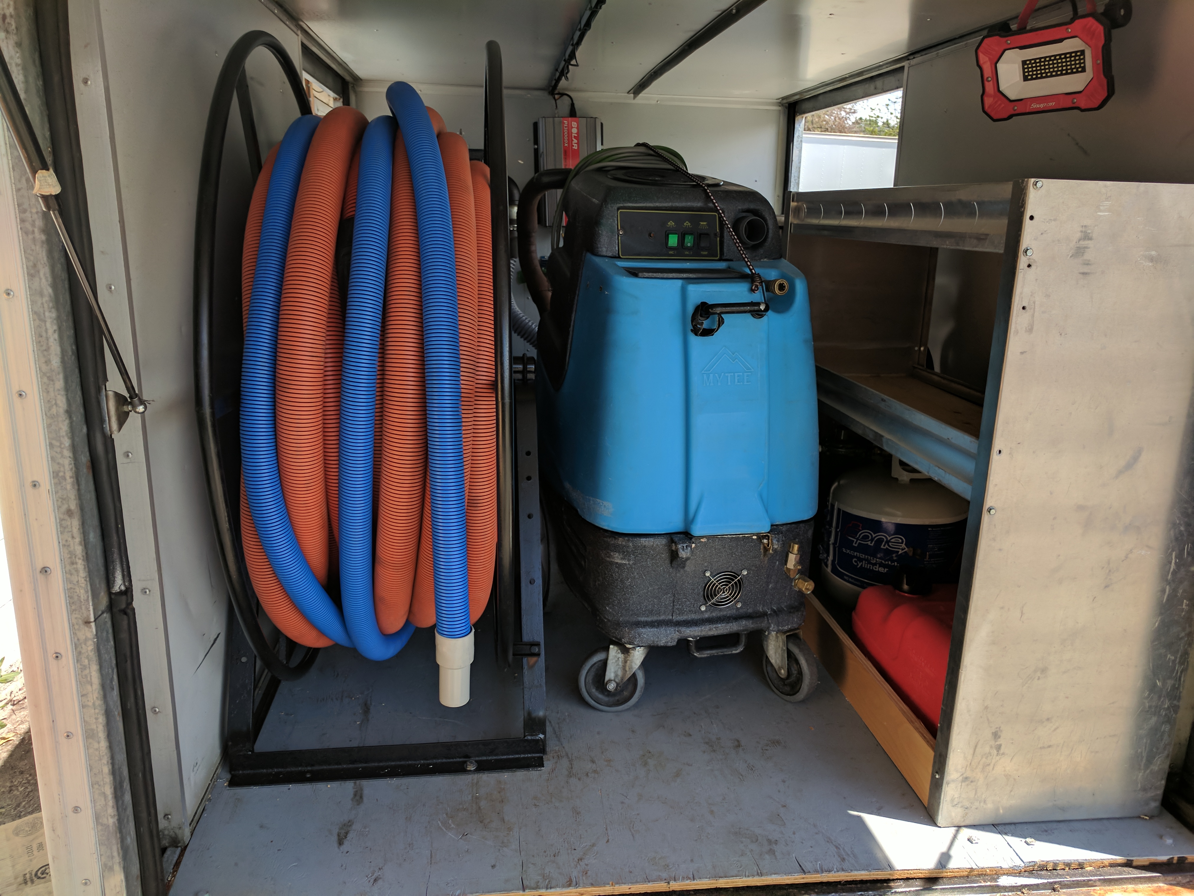

Installed my hose reel today and that just about wraps up my little Hyundai box truck. Refurbished Steamway Mastermatic, 18/36 with a few modifications. No more kerosene, instead a lg 3 ht 1300 psi propane heater, so I can do tiles. Still enough room to squeeze in a porty if I have to, or bring extra tools like a crb and vacuum. Truck is a little 4 cylinder diesel, so should be a little more economical to run. We'll see how it works this week.

Good thing you carry a portable in the truck with the Steamway

That's why I swapped the Kero heater for propane. My mechanic went through the motor and pump and says it's in great condition. My engineer neighbor removed the vac relief from the blower and Installed it on the waste tank, then made a better connecting stainless steel connector leading to the waste tank. Much better airflow and less turbulence. Will never be the most powerful unit but for most residential it should be good. Especially with the propane heat. I expect to use under 150 feet most of of the time, 200 ft at most. I have my CDS unit for longer hose runs. I am going to sell my dodge with my custom unit.

So, you're officially a short truck driver. BTW- That is one fugly truck.
