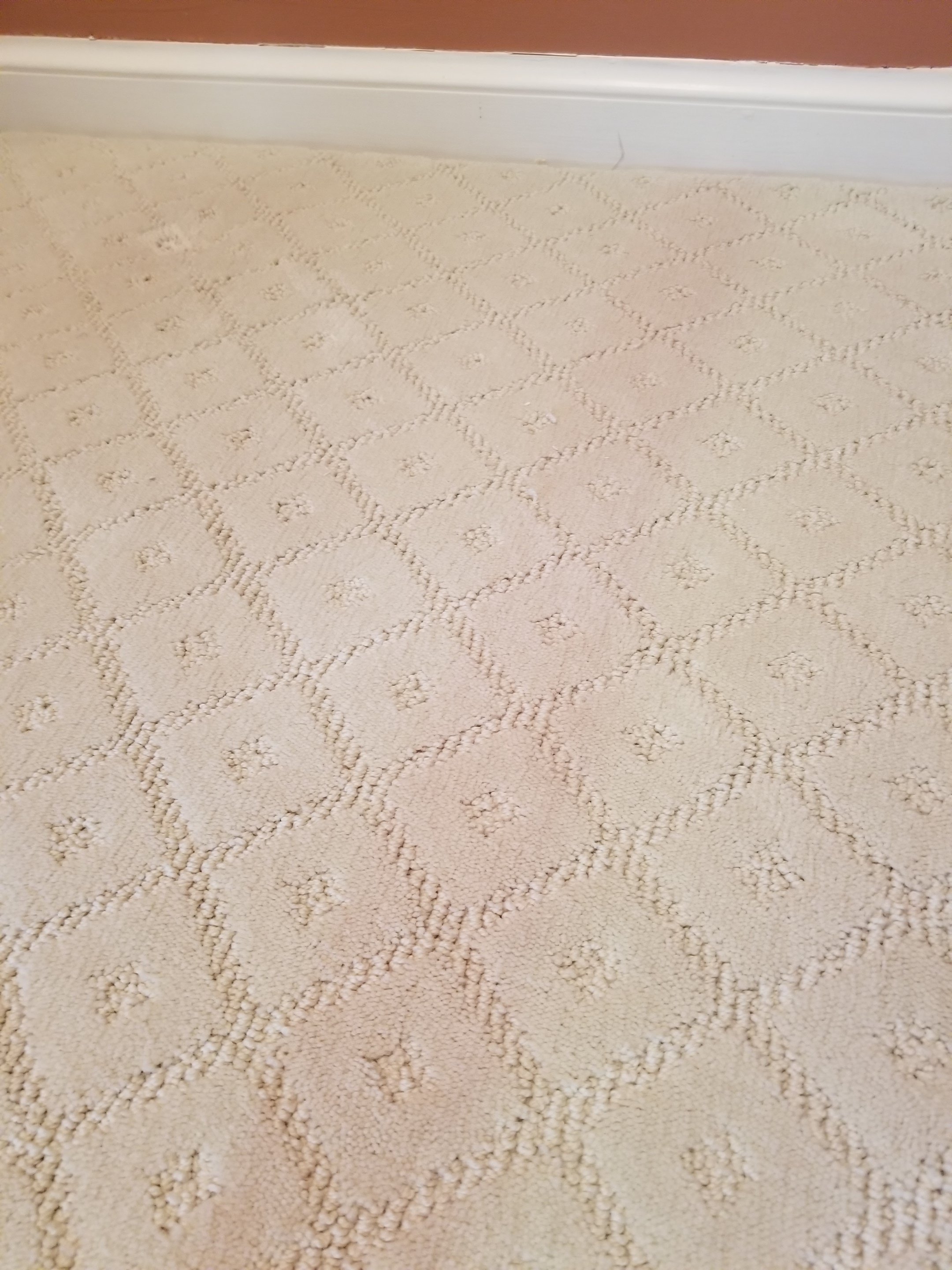

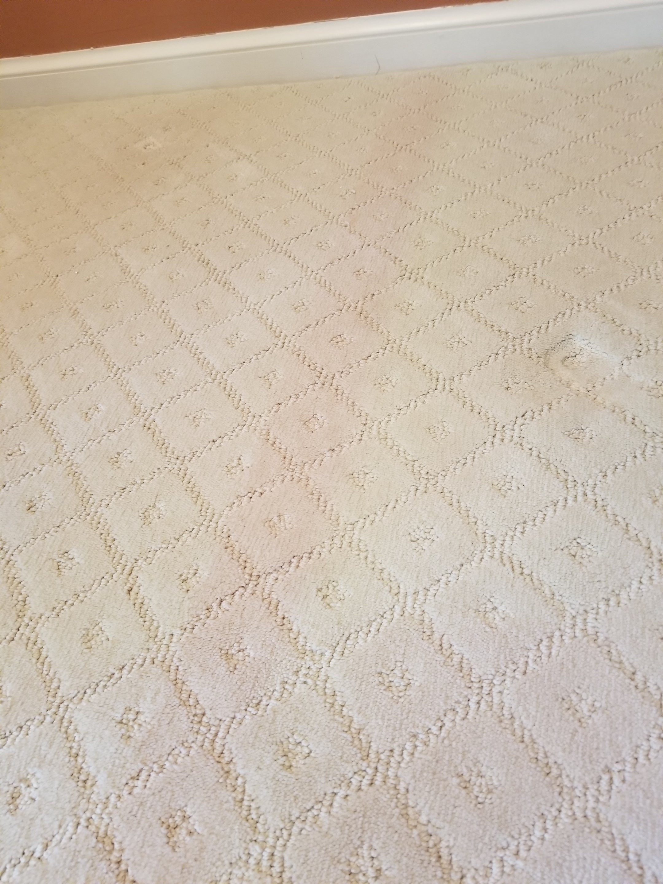

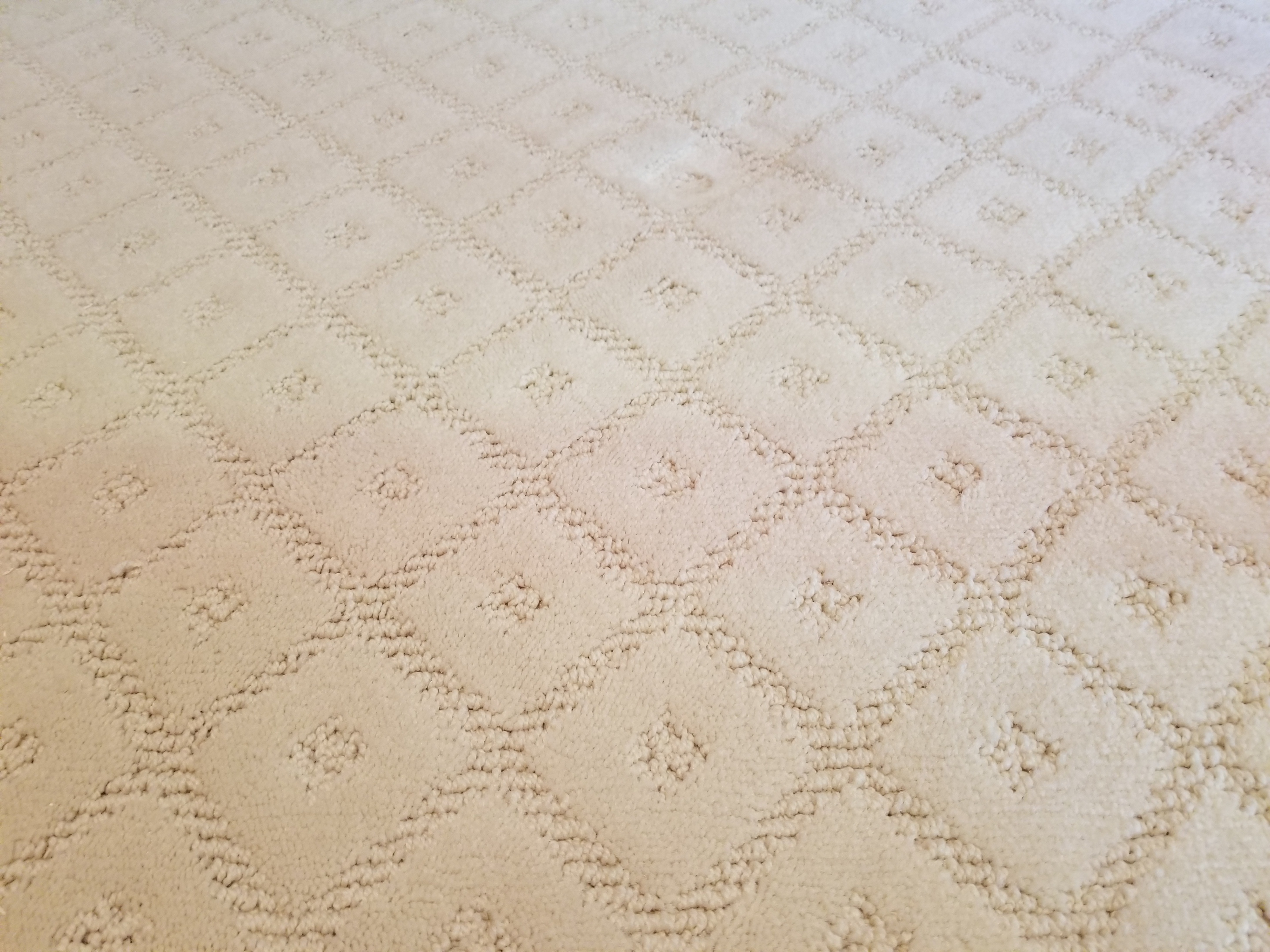

The customer really felt that our cleaning caused the problem and I felt strongly that it didn't. To come to a resolution, I agreed to pay for an independent carpet inspector to give his opinion on the issue. I also said I would replace the carpet if the inspection proved that we created the issue. To avoid any claims of bias, I told the customer to contact whomever they wanted as long as they were a certified inspector and I would reimburse them once it was done. The inspection was done on April 26th by an inspector we have used in our retail division in the past. So far, I haven't heard a thing and I am guessing that he determined that it wasn't our fault.
I'll reach out to the inspector now though to see if he will give me the skinny.
